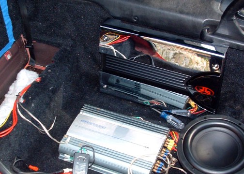

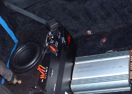

mike's mr2 install ....
wheeeeeeeeeeeeeeeeeeeeeeeeeeeeeeeeeeeeeeeeeeeeee :slayer:
mike which model RF amp is that? p3001? or p6001?
RF Punch 6002 feeding each driver roughly 350 watts a piece (figured from the included amplifier spec sheet). I had used my Earthquake PHD3 (3000 watts) for a while, but it was quite simply ridiculous overkill so I decided to throw in the more practical RF amp I had layin' around that I picked up cheap a few months ago.
Honestly though, while my system suits my purposes just fine, I really should put some more work into it seeing as I run a subwoofer company :P The drivers are enclosed behind either seat, with roughly 0.5 cu ft airspace.. though I'm sure there are some leaks as I'm relying on the body of the vehicle for some of the walls.. so I suppose you could consider it a quasi-infinite baffle rig. Not bad by any means, but it could be better.
Since it's more than I need, I haven't been too worried about it - but seeing as I'm sure others who listen to it would love to witness the full capacity of the system so to speak.. I'll probably be modifying the enclosures to be ported, and may even put back the PHD3 just for kicks as a demo rig.
