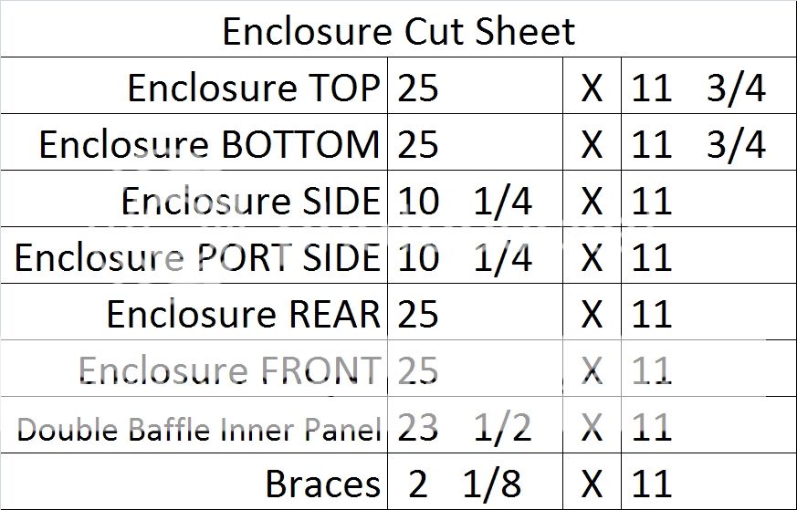

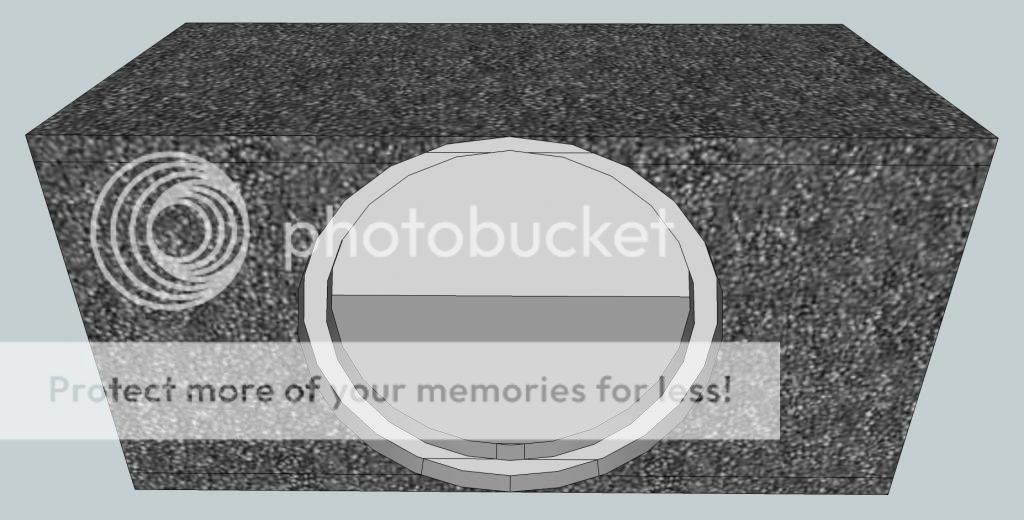

May 10, 201313 yr Awesome. I wanted the width and height to match so that it looks like your current setup when the trunk opens. You really did a nice job on that, fits like a glove. Now, since it's just a sealed enclosure and there's not much to it I didn't go all crazy with angles and views like I usually do with the ported enclosures. With the ported enclosures I think it helps get a good visual for how it all goes together and such but with the sealed, well, it just seemed a bit superfluous to do. Of course, if you have any questions at all please don't hesitate to ask. Here's the cutsheet. Here's just a quick rendering of about what it will look like finished, for the fun of it.
May 10, 201313 yr Please ignore the one line that says "PORT" side. I have a spreadsheet that's all formatted for doing this stuff and forgot to edit that line, lol.

May 10, 201313 yr Author Alton, one quick question, what size is the second opening on the second layer? I'm assuming the opening on the back layer (the mounting surface for the sub) is 11 3/16", but I'm unsure of the finising layer. Only asking since I dont have the sub in hand to really measure it out, and my plan was to build this so when the sub gets here it will be ready to toss. Thanks for the compliments on the current box also. Really appreciate all the help and design work you did for me.
May 10, 201313 yr Not a problem, I'm glad I could help. As for the sub's dimensions for the cutout diameter and the outside diameter, they're on the website, but the cutout is 11.125" (11 1/8") and the OD of the sub is listed as 12.5" but that is one that wouldn't hurt to add a little wiggle room to I would imagine.
May 10, 201313 yr Author Ah ok. The pre-built blueprint I downloaded showed 11 3/16, I didnt see the 11 1/8. I do see what you're saying about the OD being 12.5", so with the box being 12.5" tall, I'll just basically cut two half-moon peices to surround the sub. Thanks! Edited May 10, 201313 yr by riored4v
