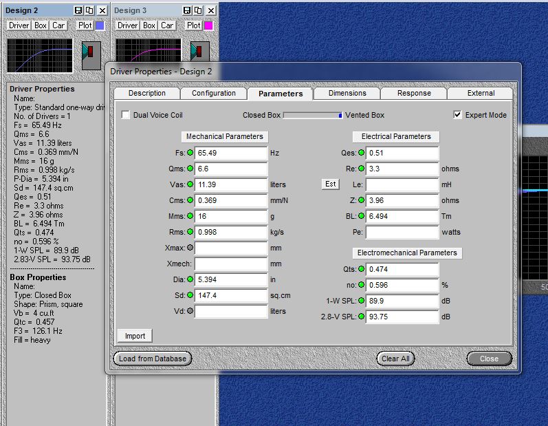

I used the T/S parameters that were posted in the Impedance vs Freq graph to plot a curve. The enclosure size I used is 4 cubic feet to simulate a leaky car door, the f3 is 148.6hz. Is this what you are expecting from this driver?
Can someone tell me what the correct SD and VAS is for this driver? The units of measurement are misleading.

The correct Sd is 147.4 cm2 or 1474 mm2. If your using WinISD it'll calculate the Vas on its own with the Sd right.
Or .01474 M2 if you want to work it that route, lol.

I am using BassBox 6 Pro. Having the correct SD I was able to calculate the VAS. This brings the f3 down to 126hz. Still very high for a midbass driver. Am I missing something?

I'll have to pull my laptop out to see what WinISD said, but the slope is very shallow and coupled with the transfer function inside the vehicle it's really pretty average results from what I've seen from other drivers I've modeled in IB.

I had originally wanted a lower Fs, but the design changed, and I really liked the sound and performance.  The Qts. worked out to be around where I was aiming, and they are a little more efficient then I had originally planned.
Tweaks can always be made for the next run, but as they stand, they are very smooth and have no odd coloring or break up.
It maybe average.
I am currently hunting for a midbass driver that has strong output in the upper bass region. I've found that this really helps with blending the sub in to the front stage.
