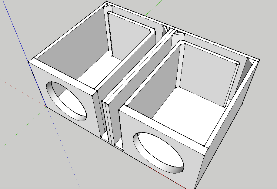

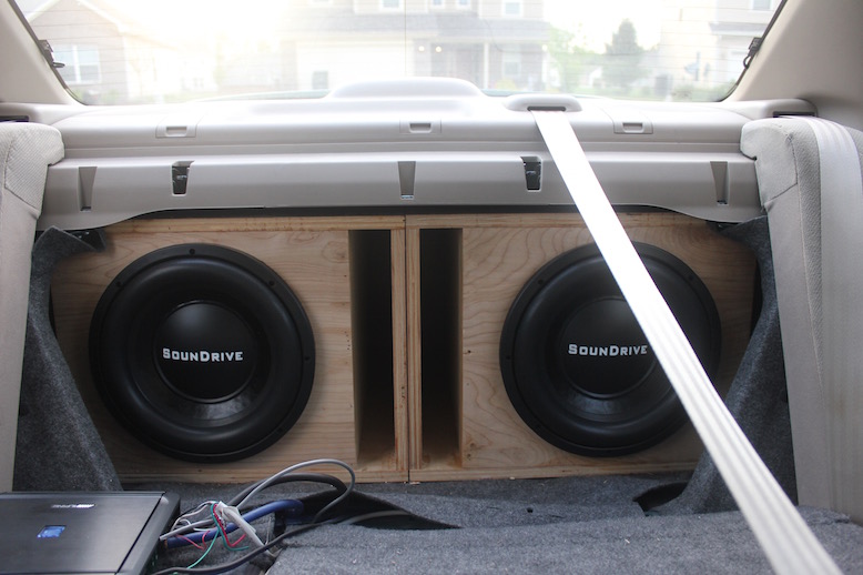

Box design, 2.3 ft 30hz

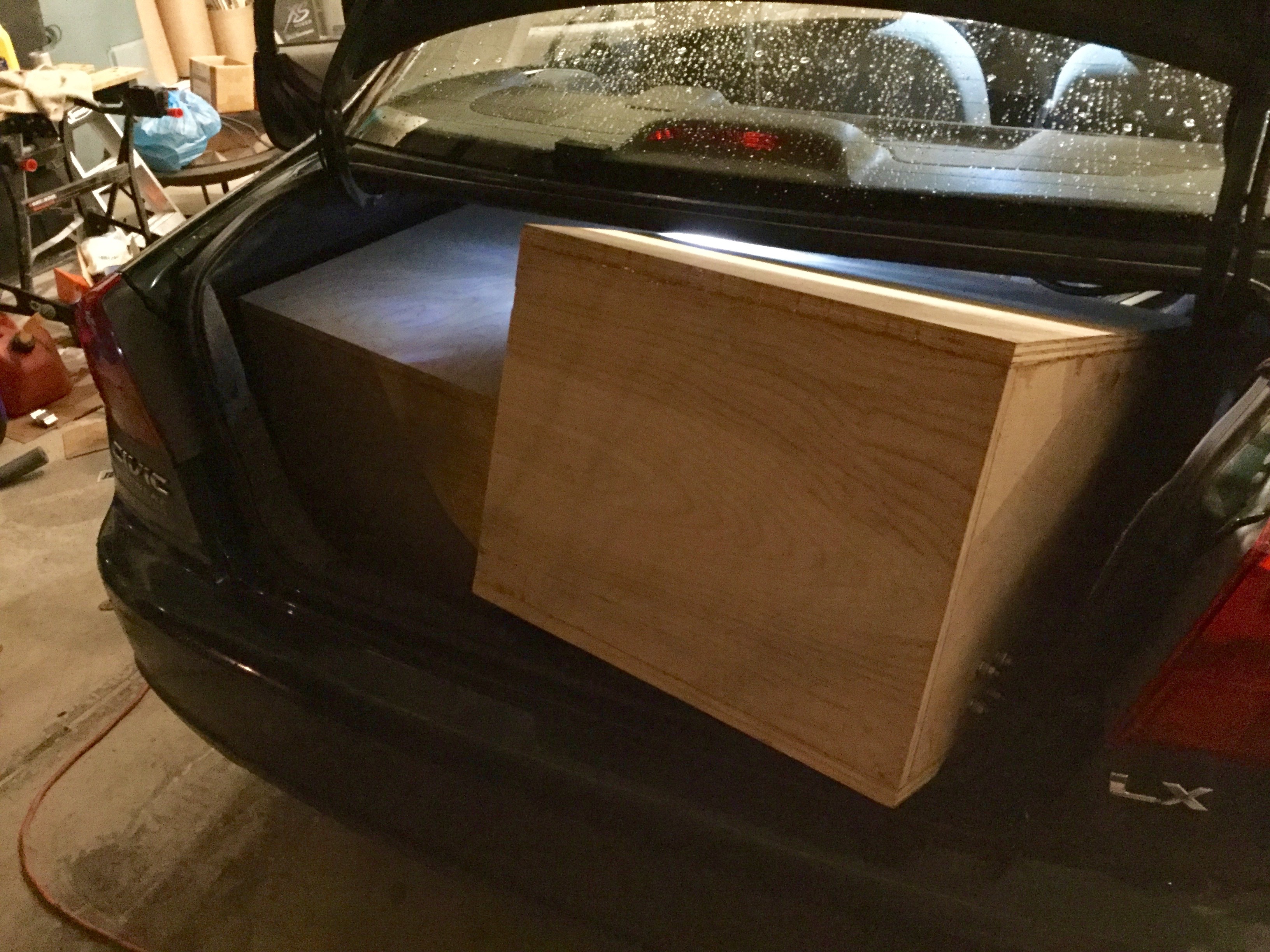

In the trunk. I will be make a front panel for it and completely sealing off once I finish wiring in batteries etc.

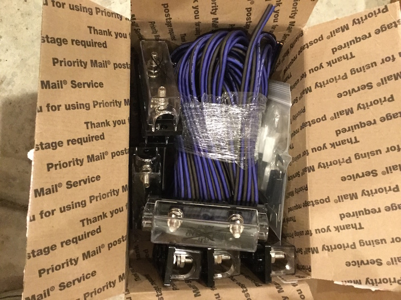

Still waiting on my 16 ton crimper, triple 4/0 inputs, probably get some quad 8 awg for the speaker terminals whenever they are back in stock. Still need a shorter belt for the alt and just small stuff to wrap it up. Advice etc always appreciated. Thanks for stoppin in for a gander!

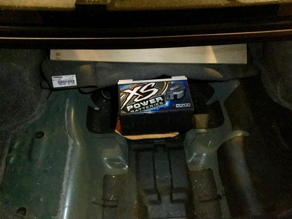

Alrighty, got my hydraulic crimper in the mail but haven't tested it yet. Started tearing out the rear tonight and trying to figure out how to fit group 31's within 1/16" height clearance, probably have to do a cut out of the new floor piece where they are.
Pulling enclosure ( everything for this build is made to be relatively easy to remove.)
Ideal location for first batt
Stopped here for the night, still need to pull all carpet from trunk, rear seats, passenger seat etc.

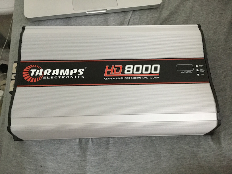

I'm curious about those Soundrive subs : you will have them on a 8000 watts amp ? Those subs must be strong.

Yeah its a Taramps for whatever thats worth. I expect to have rise and am only wiring at 1 ohm so that 8k will quickly be <4k.

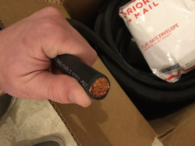

Finally got the firewall drilled out. Ended up having to use a step bit, wanted to die the entire time. Have two power and two ground from front to rear now. Really hoping to get everything in for a test run before the end of the week, will be working on making everything look nice afterwards.
Lumpy carpet is cool I suppose.
And knu konceptz 4 awg vs 4/0 welding cable just for fun.

Holy cats, cant believe you got 4 runs of 1/0 through the firewall!
Don't know if you mistyped but... its 4/0 ;)
