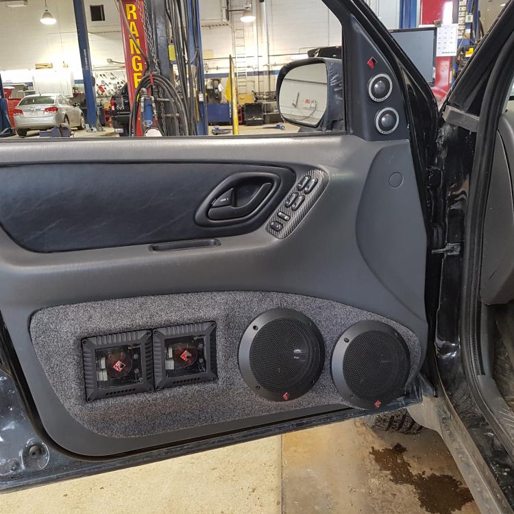

After fine tuning the amp very finicky and running for a while it is a great sounding sub it hits tight and when it hits the tune of the box just the one absolutely blows my mind I will be doing some testing with my term lab hopefully some time this week comming up and will throw the numbers up for you guys and give it a few months going to be getting a second one and doing a wall enclosure for two at 1 ohm on the scv 6000 I would have put up pictures but it tells me the file sizes are too large to upload

If anyone wants to see the build its on Facebook good vibrations sub boxes and under the album 2005 ford escape
Can you post some of the pictures here? Not everyone has facebook.
