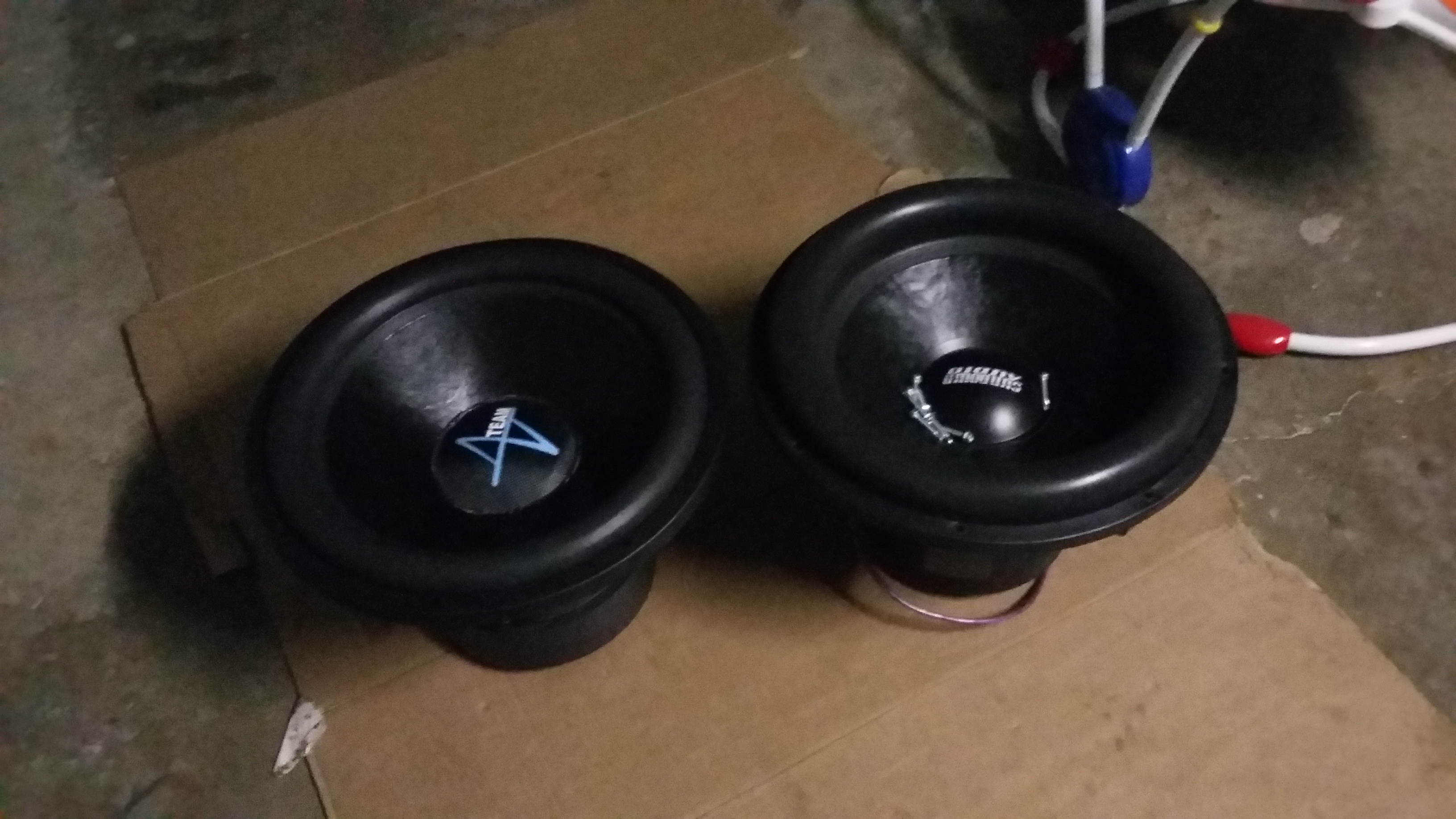

No havnt had a chance yet to get back on the meter. I was supposed to last saturday but ended up having to work. Its nice to get the overtime because it lets me be able to buy more toys. Still need front door speakers and i think i might pick up 4 of the evil 6.5s. I always check reviews or look for dyno runs now before i buy anything. Its not like the old days when kicker ruled the world. I lost respect for them as soon as i saw walmart selling kicker. Theres alot of upcoming friends builds as well. My buddys 2 ascendant team 18s are just sitting waiting for a box. He didnt want to do a wall. Sad. One next to my sundown. Took him 3 months after the first sub to get the second.
