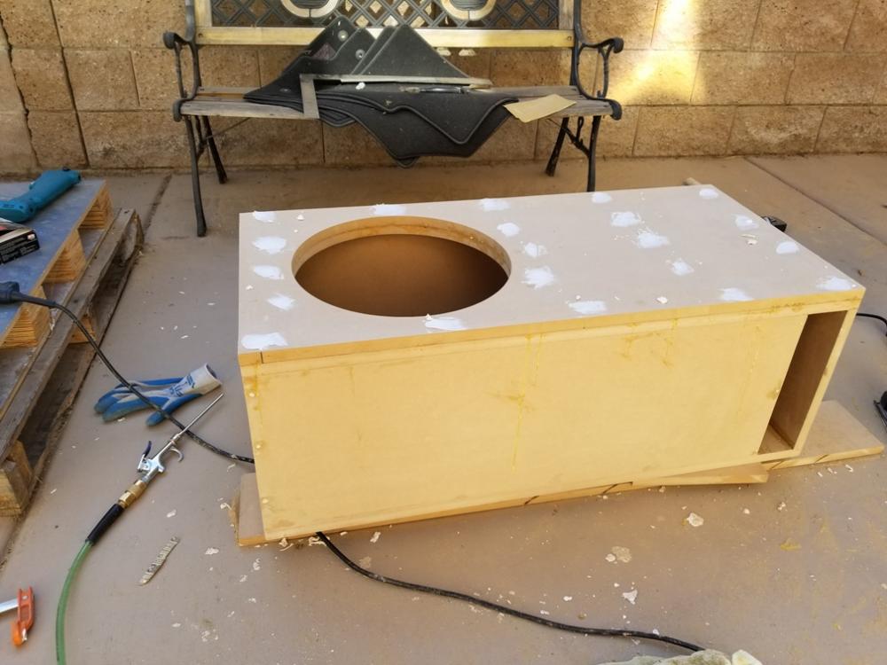

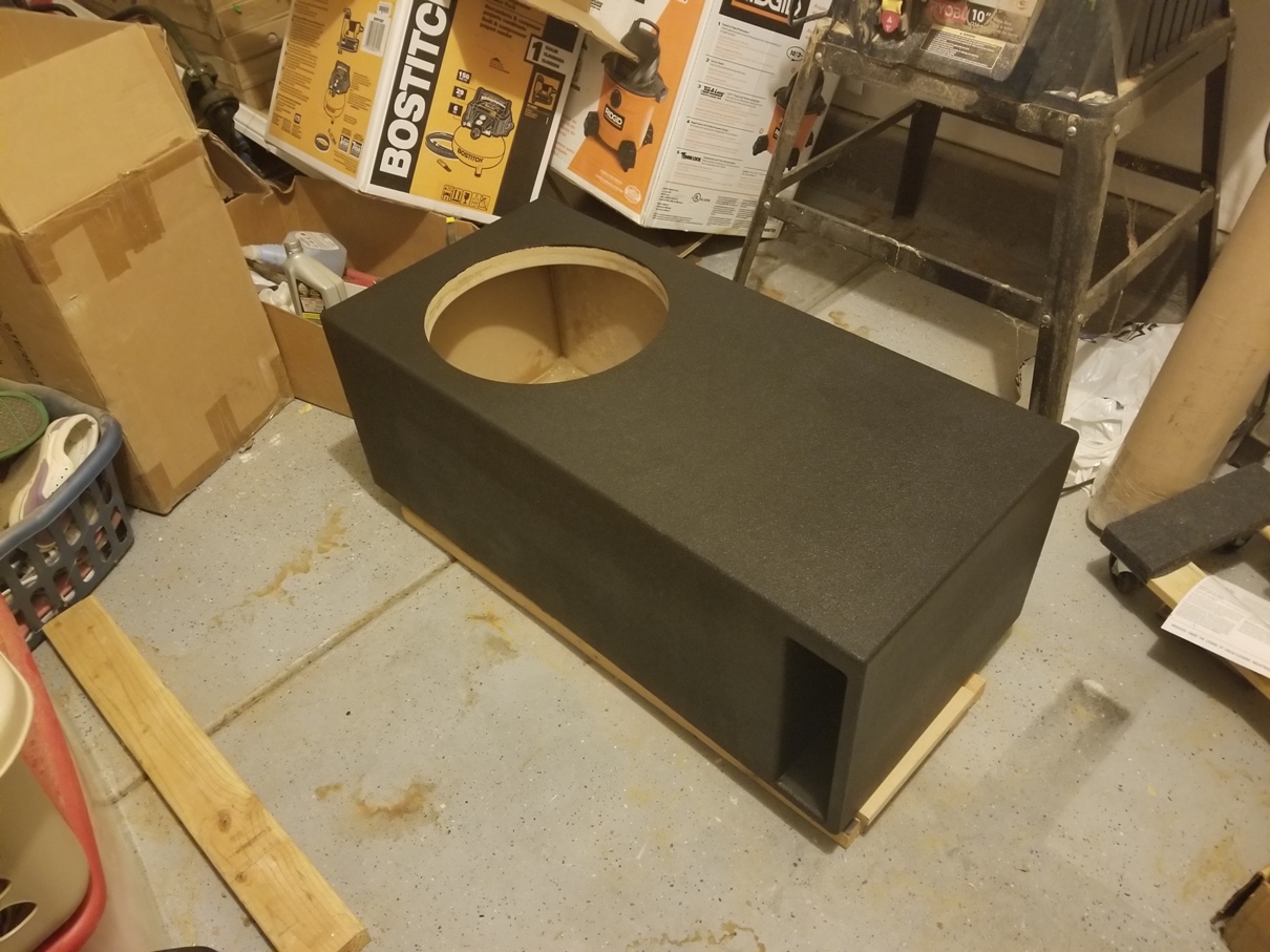

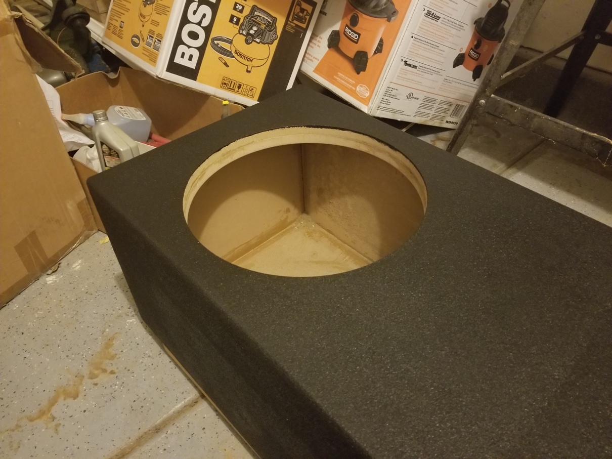

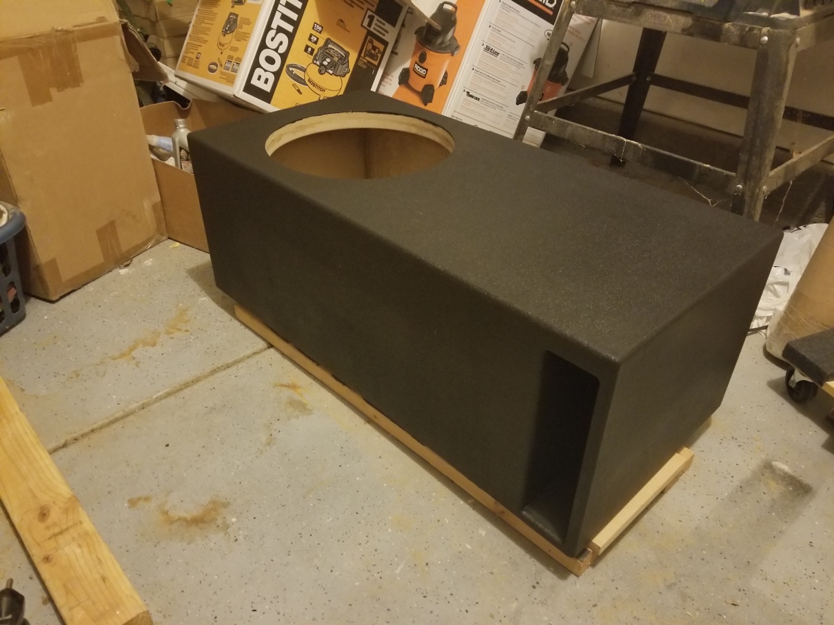

Nice box. I haven't heard of the duratex before your post. How did you apply it? It looks very nice and I may use it in the future. Hope to see more of this build soon.
Share this post
Link to post
Share on other sites
Looks great. Where did you get it from ? Is the texture on the smaller end? I used a deck liner from Home Depot once. It had a nice look from far but up close it was real jagged. And it left dust every time I’d move it a bunch.
Share this post
Link to post

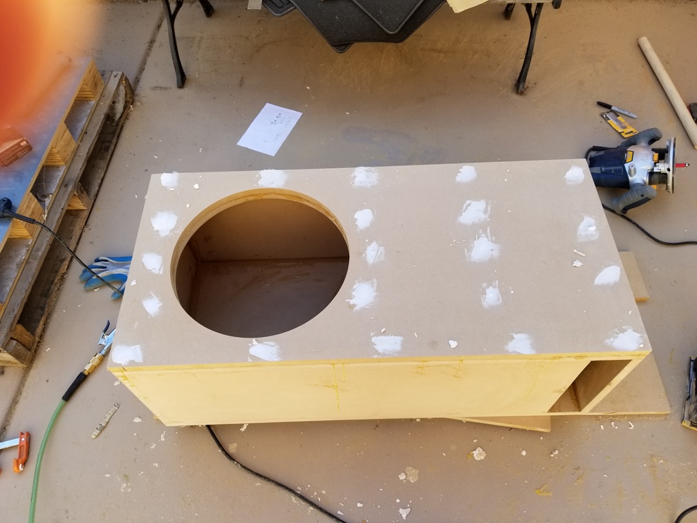

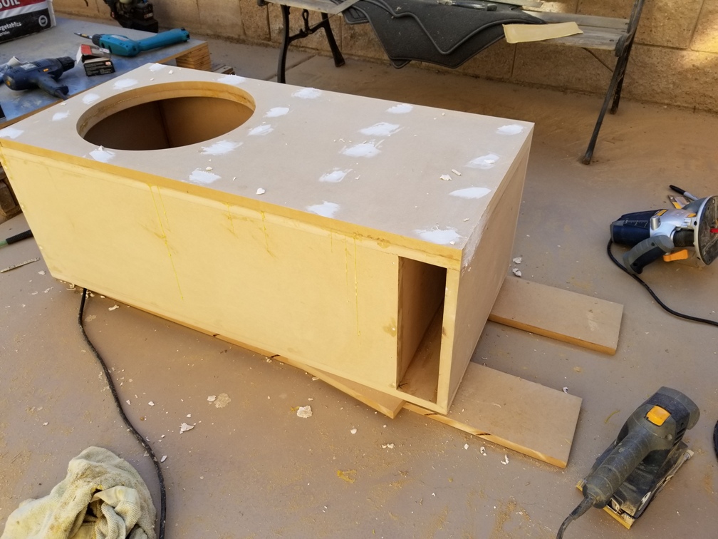

On December 4, 2017 at 1:12 AM, ClevelandFreeman said:
Rounded the edges, I'll duratex maybe tomorrow.....
Painless & easy on the nose! Find it here: https://www.acrytech.com/product-category/speaker-cabinet-coatings/ they even do some color matching.

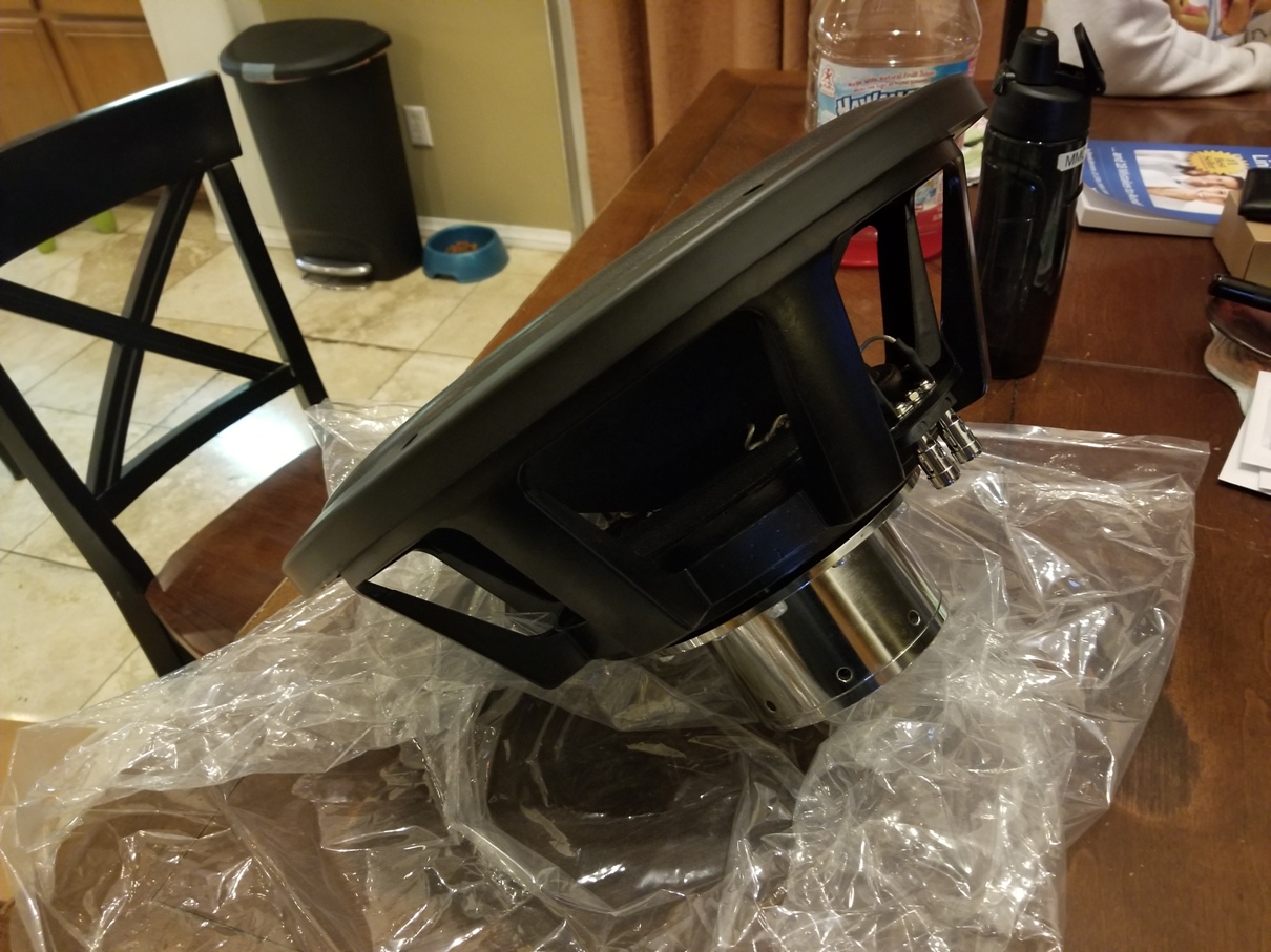

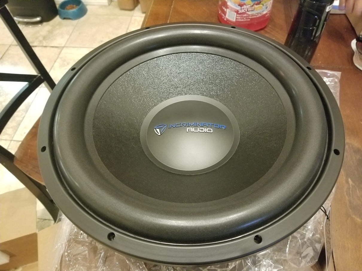

Sub is here!  Build quality is excellent, can't find nothing wrong with it.  Packaging was great.

Sub is badass man, love it :droolcup:
