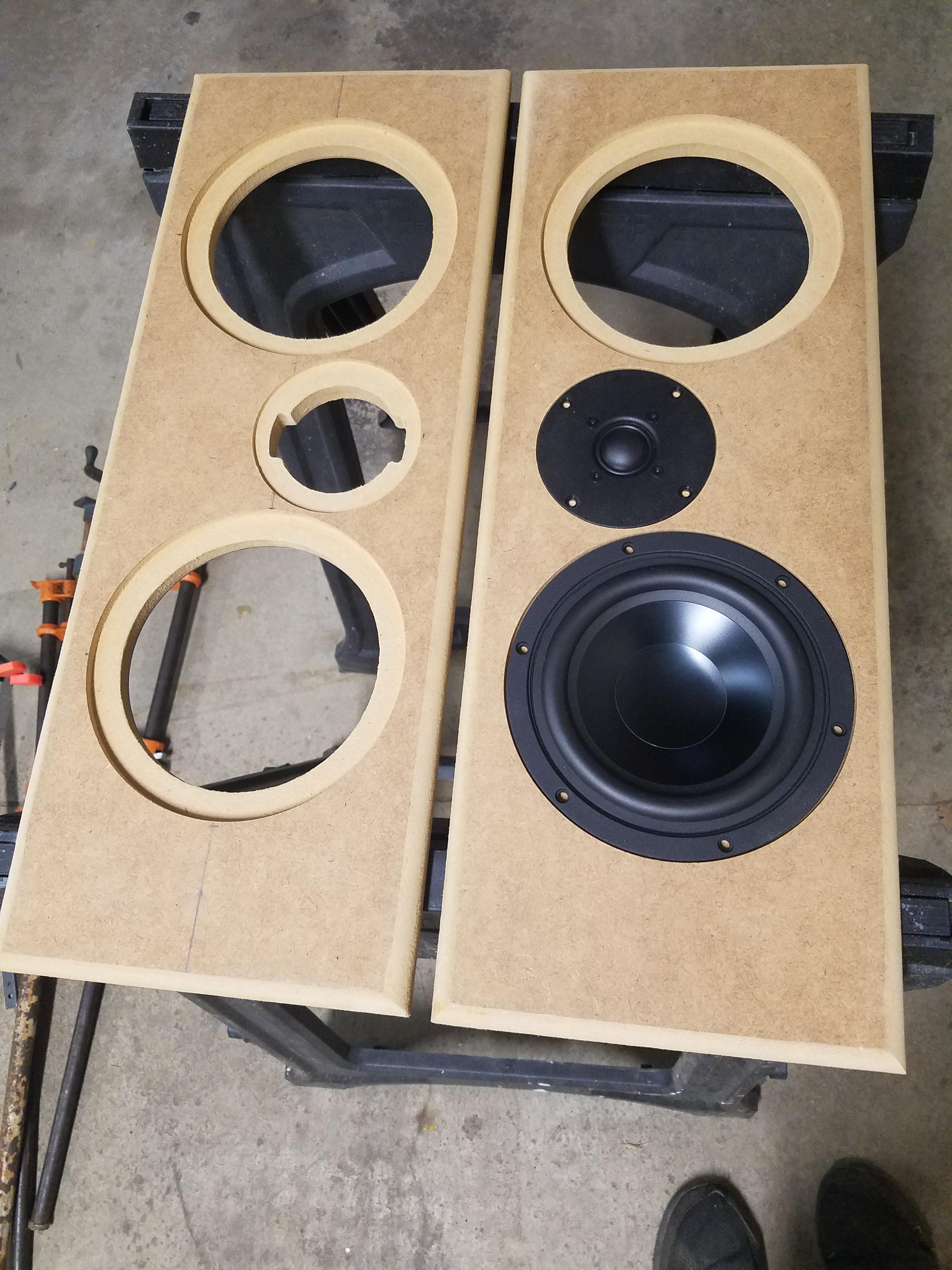

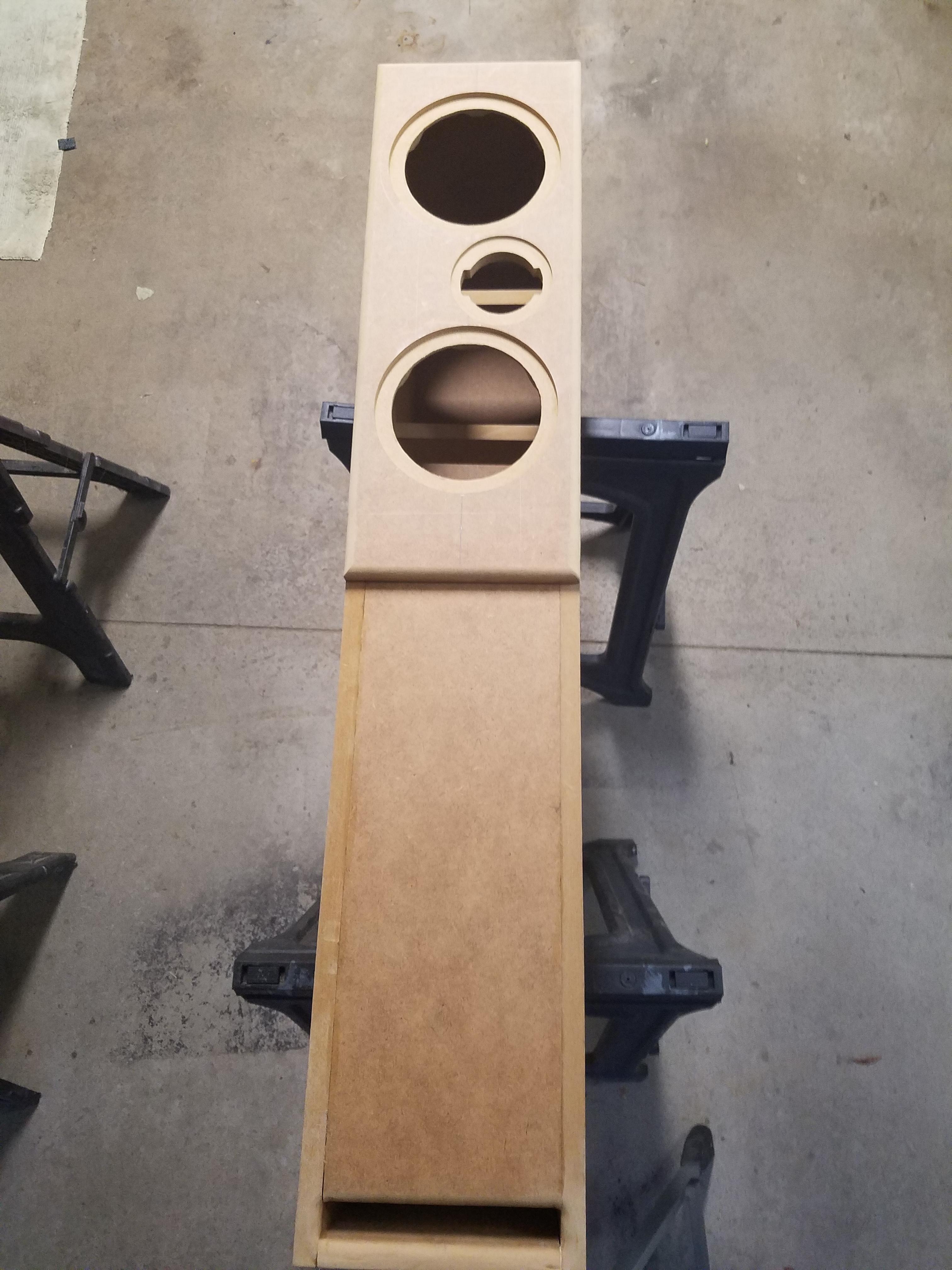

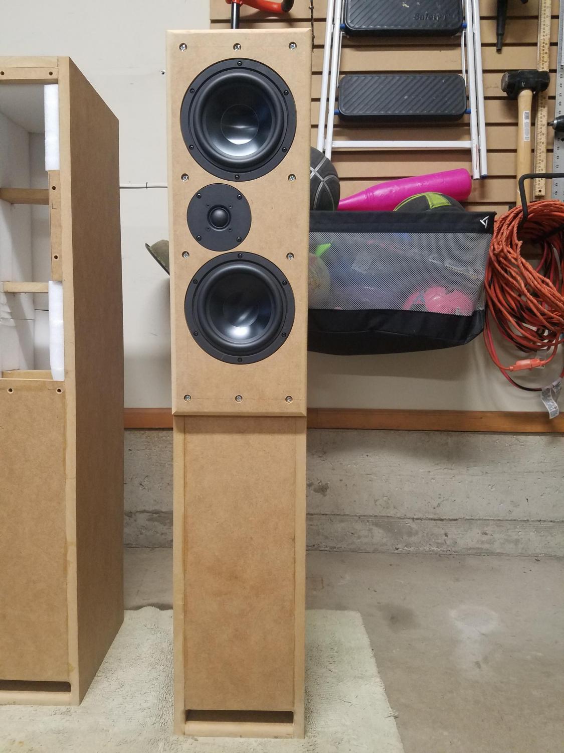

My woodworking skills leave a lot to be desired.  Right now as long as these are simply functional I'll be happy.  Baffles turned out nice though :) About the only thing that's gone right so far.  This is where we're currently at.

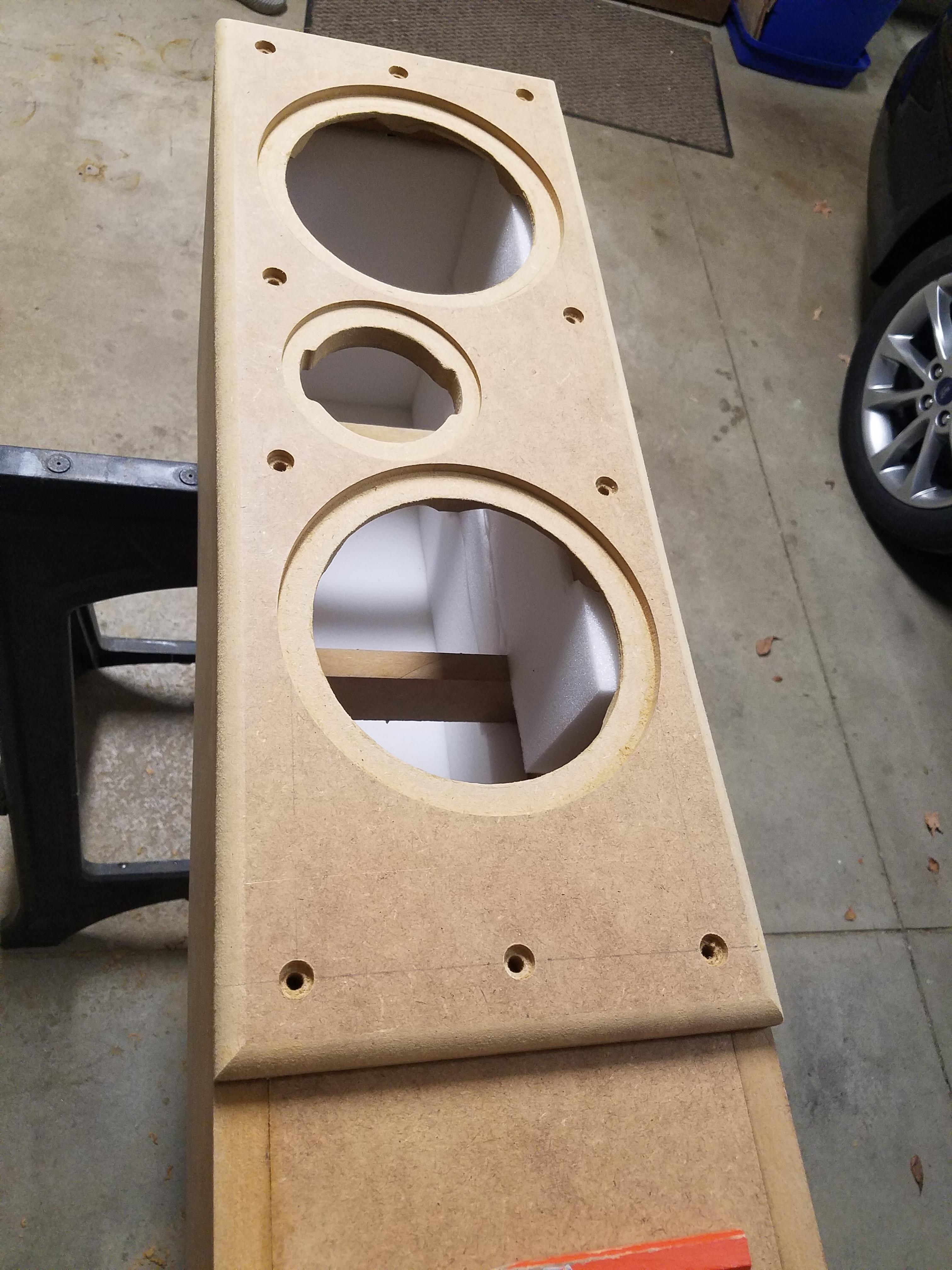

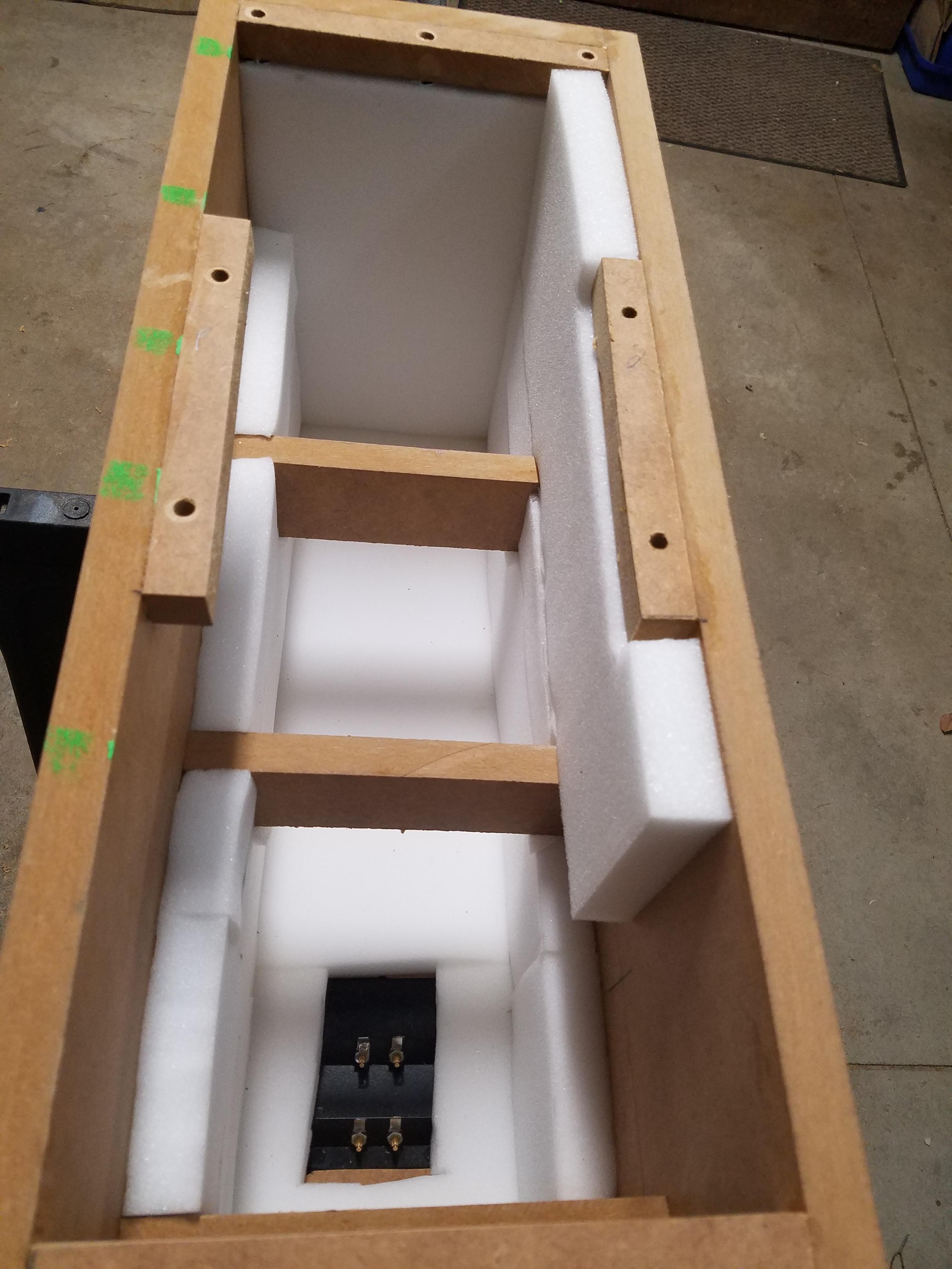

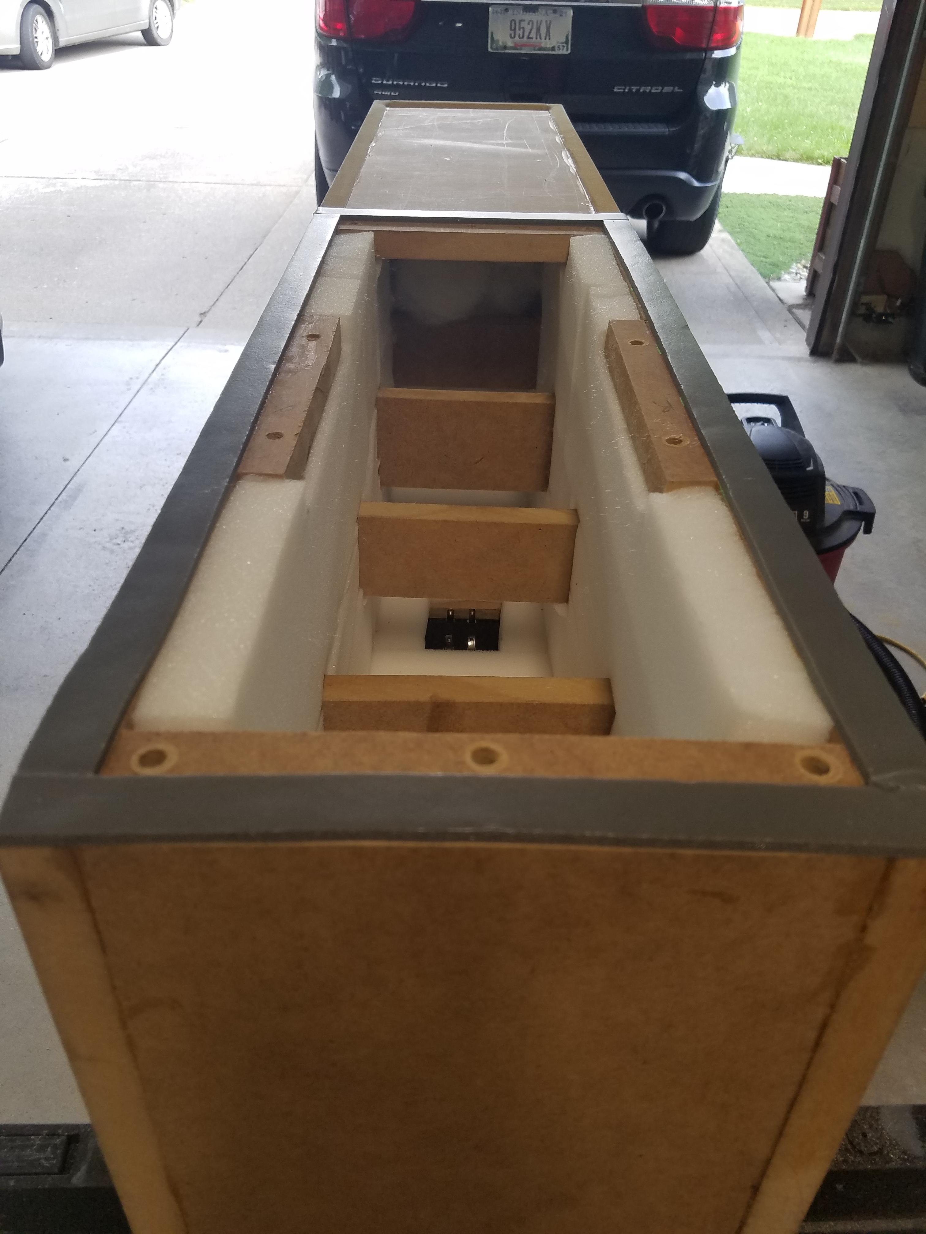

Welp, as usual this shit is taking way longer than I anticipated.  Didnt help I had to spend all day Sat fixing my dryer instead of working on my speaker project :wacko:

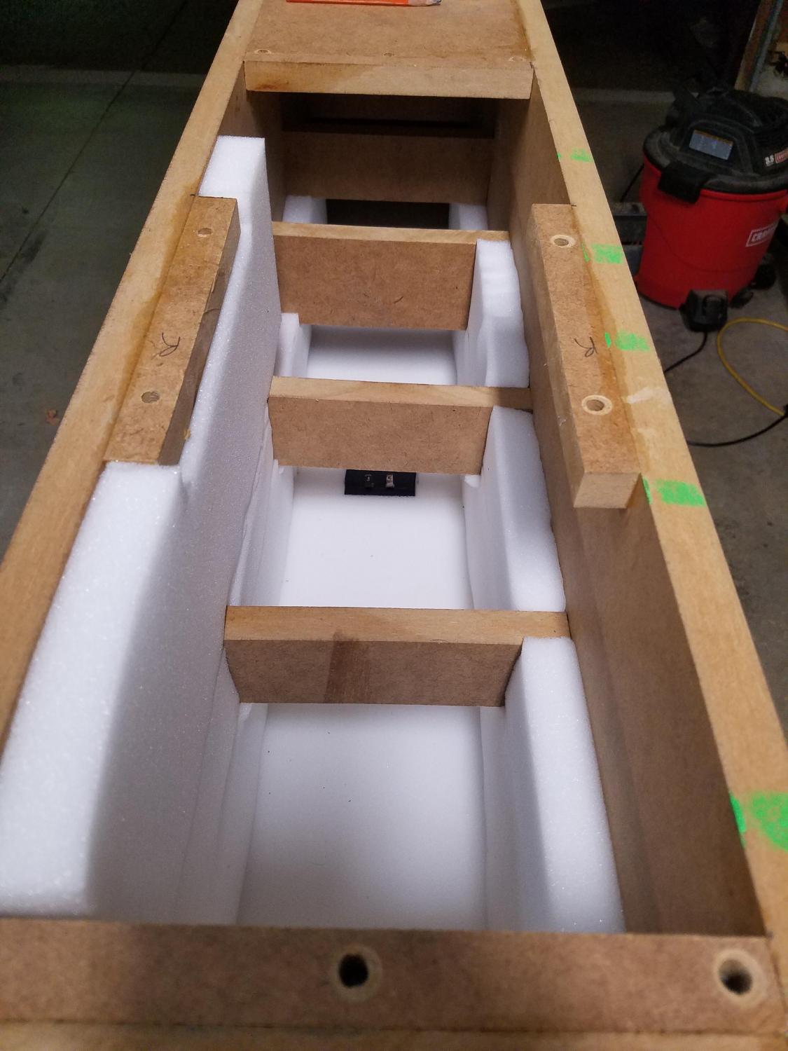

But, progress was made.  Got my binding post plates installed, baffle mounting bracket pieces put on, holes drilled and countersunk, T nuts installed and started on the cabinet damping.  Also realized I forgot about needing to measure the impedance curve....really wish I'd thought about that when I placed my order at PE  >:(

what kind of foam is that?
Share this post
Link to post
Share on other sites
Seat padding from the craft section of Walmart :) It's 1" thick open cell

Sweet, never thought to use something like that.

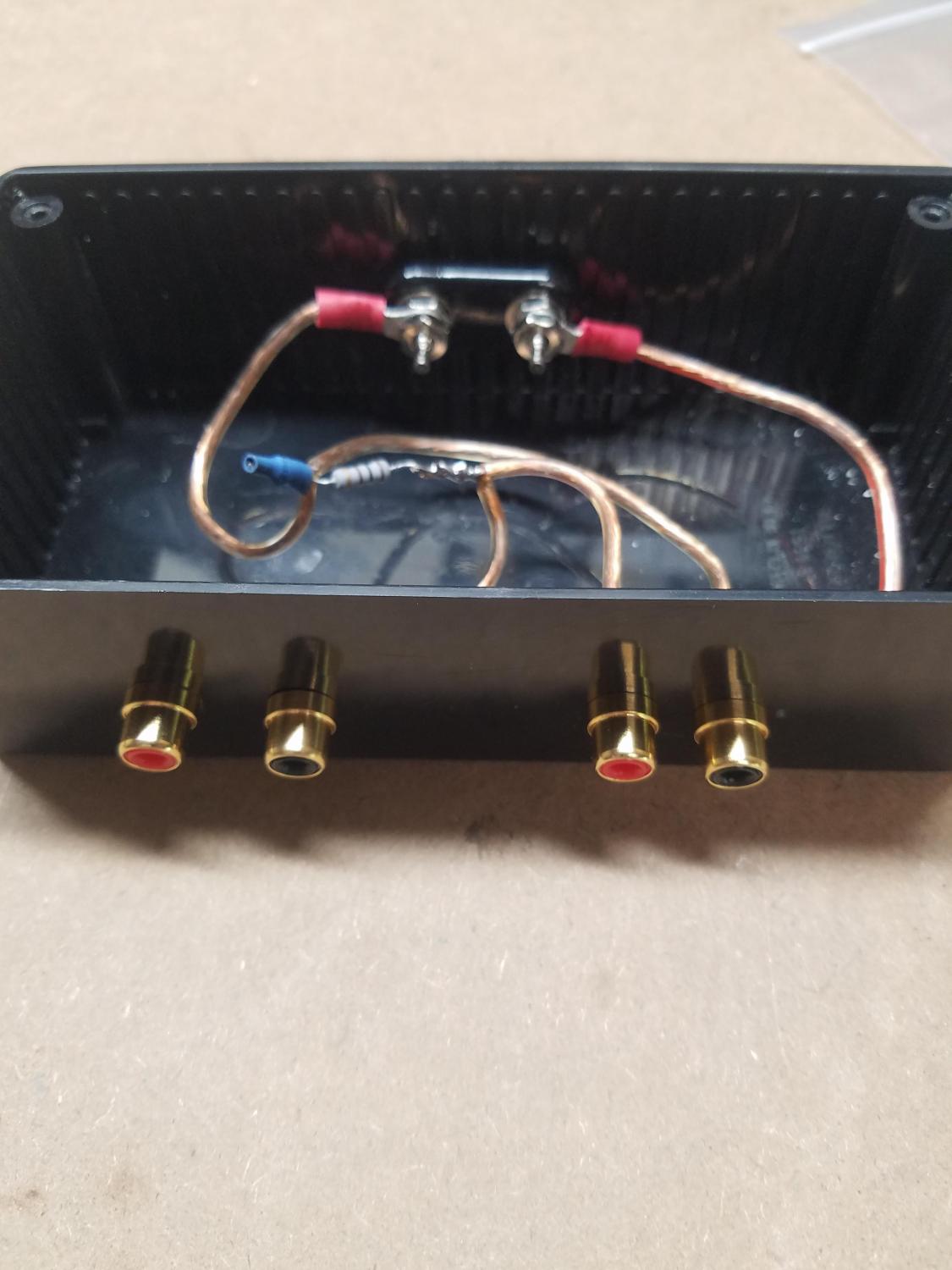

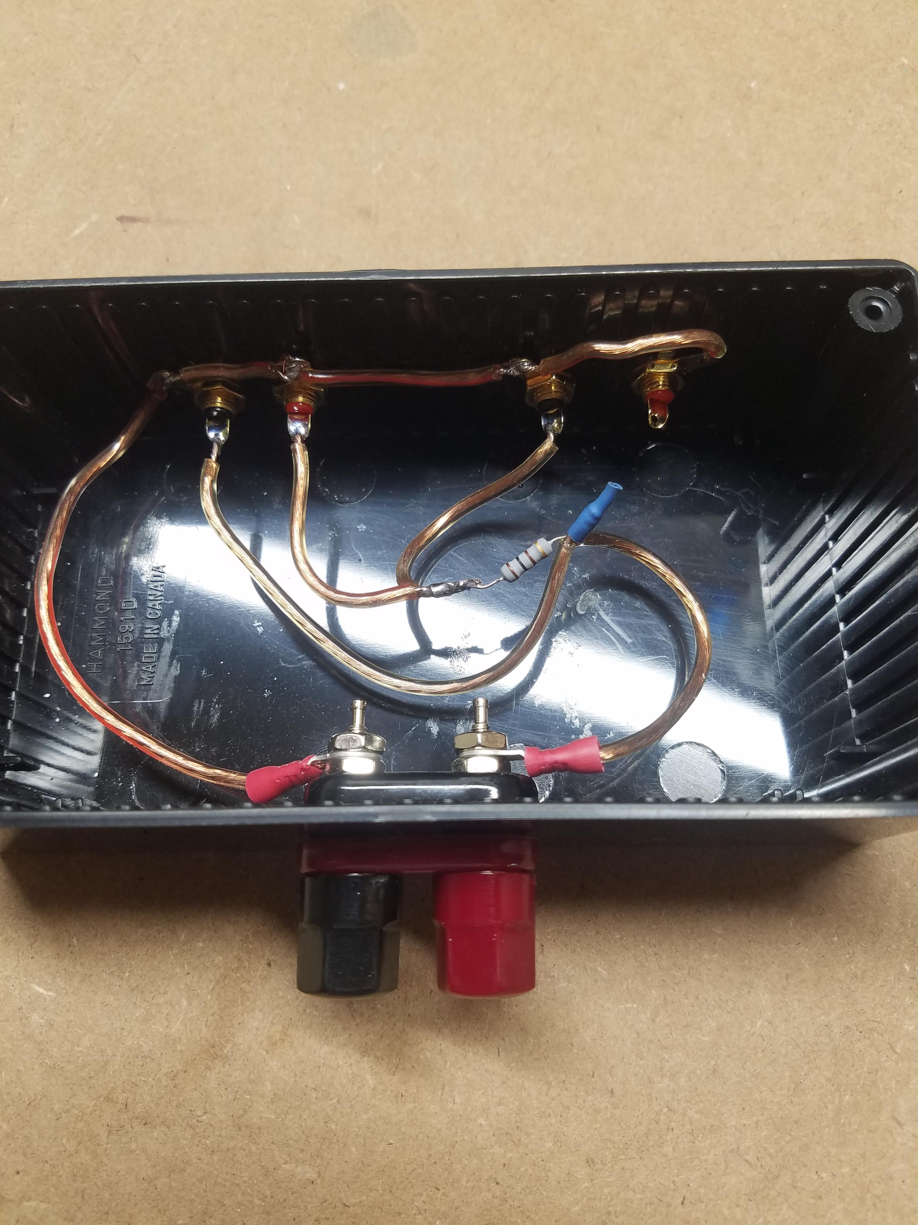

Got my impedance measuring jig soldered up today :)  Pretty happy with how it turned out considering how long it's been since I've soldered anything

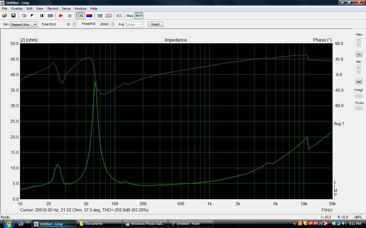

Here's the impedance sweep for the Anarchy's.  Learned a few things:
1) For some reason tuning ended up being 25hz instead of 35hz?  No idea.  I know it's not a measure twice, cut once issue with building the cabinets.  Measurements there are solid.  I figured I'd be off a few hz one way or the other....but 30% was a little unexpected.  I'd considered that maybe it's an accuracy issue with the measurement....but the Anarchy's are infamous for having a cone resonance around 4200hz which is about spot on in the measurement.  So....
2) I had poly fill stuffed in the bottom of the enclosure to start but when I started measuring impedance I had a nearly non-existent impedance peak at tuning.  Removed the polyfill and the impedance peak looks much better than how it was.
3) I knew about the hiccup at ~4200hz which is a cone resonance.  Not sure what's going on at 150hz...enclosure resonance maybe?  Internal reflection?  Not sure.
Anyways.  I had the FR sweeps all done, but going to rerun the sweep for the Anarchy's without the polyfill since based on the Z curve I'm going to be leaving that out.

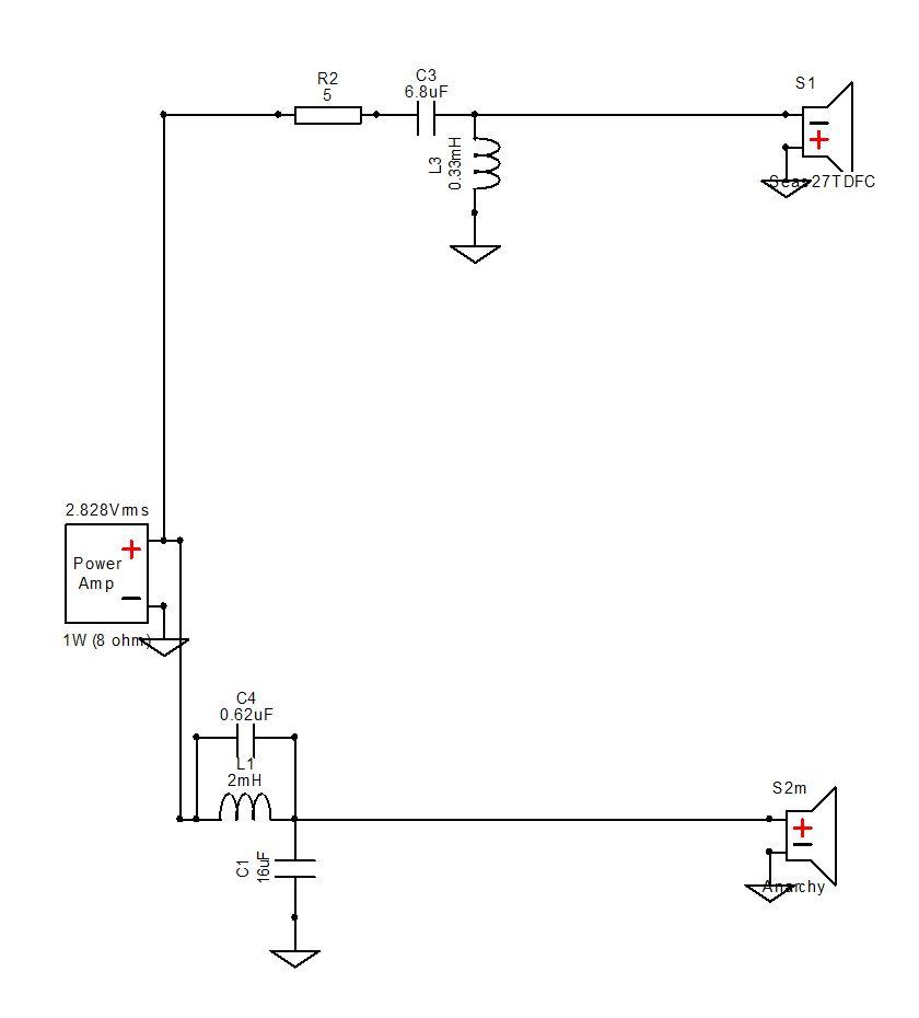

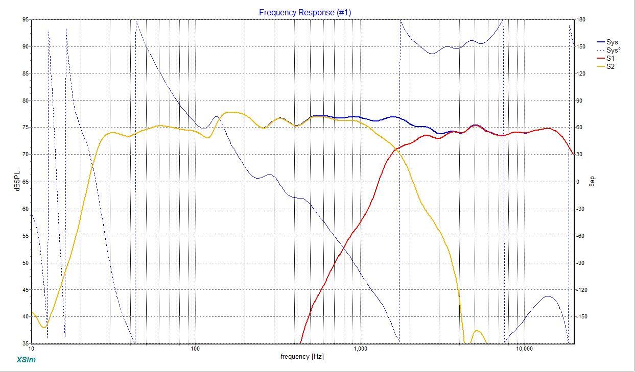

So with a little help I came to realize that the dip in my initial measurements from 2-3khz was likely an issue with my measurement system somewhere.  So I went through and created a new cal file to basically pretend it didn't exist :) My new initial measurements look a little different than above, but eliminating that dip in the tweeter response is really the main difference.  Spent way more time than I care to admit working on different xover sims, but I learned a bit each time.  I'm far from an expert but definitely better than when I started a few weeks ago.  Came up with 3 main xovers that I'm going to try.  This is probably my favorite.  The response isn't the flattest, and the reverse null isn't the best of the bunch...but it's the only alignment that is a 2nd order on both the mids (with a tank filter) and tweeter so the part count is the lowest and it's the simplest design.  I think there's something to be said for simplicity.  Guys like Zaph and Jeff Bagby (RIP) always tried to design with the least parts possible.
I have $160 worth of crossover components on their way to me from PE. to try all three designs.  So hopefully out of that I'll be able to make something that sounds decent :) I just went with non-polarized electrolytics for the caps because, well, they were 1/10th the cost and I'm a tight ass with money, the actual sonic differences are arguable at best, and I may have something in the next couple months that'll require some cash to fund properly.  We'll see.

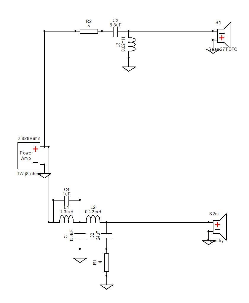

Here's probably one of my top contenders as far as phase and response go.  4th order on the woofer with a zobel and tank filter, tweeter is second order.  My last crossover is just a variant of this - slightly different values for some of the inductors and caps to shape the response a little differently.  But overall layout is the same.  I have a 5ohm resistor on the tweeter to drop the response a little to keep it from being on the bright side, but I am also going to try a 4ohm which would bring the response from the tweeter up to pretty close to flat.  We'll see which way sounds best in reality.

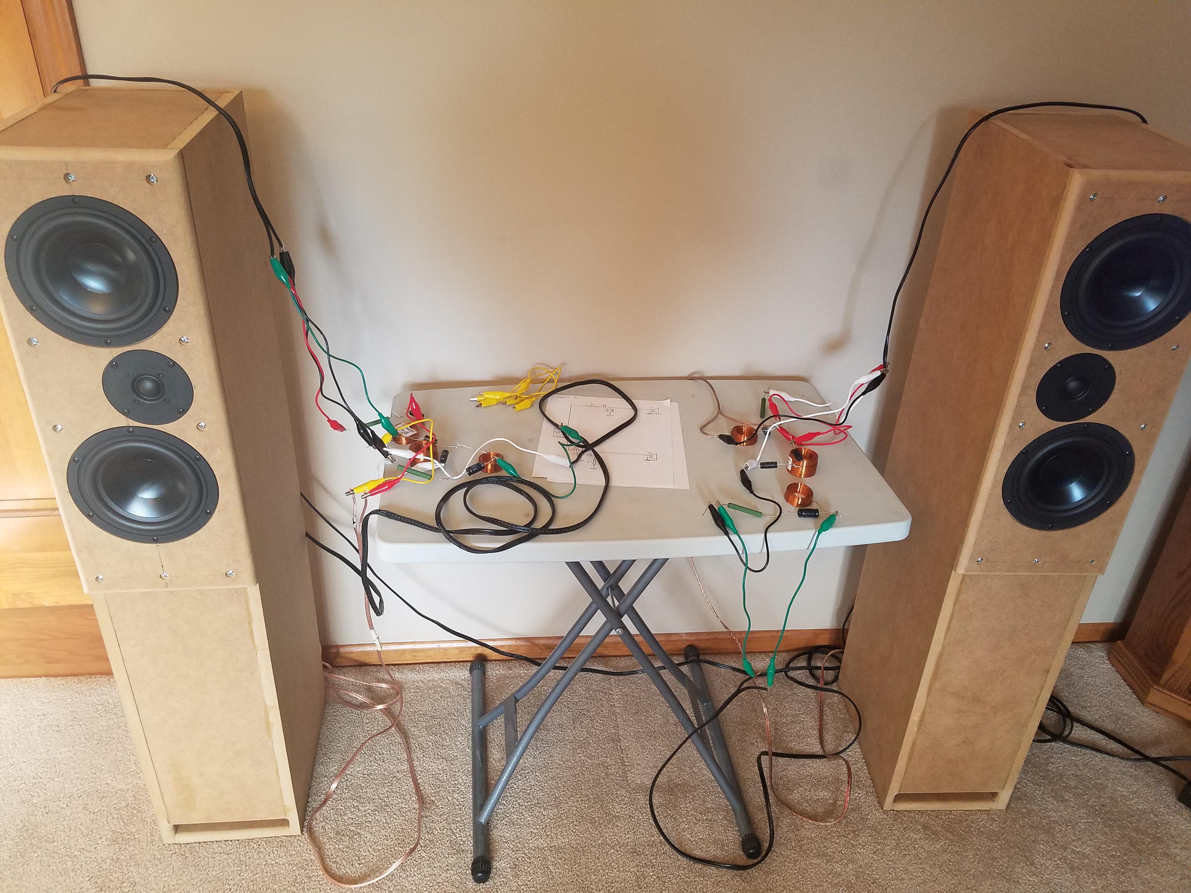

And, it's alive!  I literally spent HOURS figuring out why I had no tweeter on the right channel.  Finally came to discover that one of my jumper wires were bad :(  It was incredibly frustrating trying to track down the issue, and I dont handle frustration well.  Curse words were said (and muttered, yelled and spewed)
