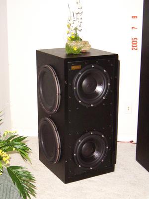

		The results are finally in!!!!!!!!!!!!!! :dancingsmilie: They are fantastic, even with the QSC 1450 450 wpc amp! It's not working as hard with these 15's as it did with the two 12" Titanic MK III's! There is virtually no amp clipping at very high levels! At this point, I have no intentions of upgrading to a more powerful amp! I finished them up last night and I installed four of the Dayton #295-194 15" passive radiators and carefully added weight totaling 1100 grams each, including the mms of the prs. The maximum recommended weight for this pr is 1200 grams. I had about 4 lbs of polyfil inside the cabinet to make it think it was larger than it really is, and I found that the prs weren't in sync because of the mass of the polyfil and the sound wasn't quite right. After removing all of the polyfil, things changed drastically! The cabinet is lined with 2 1/5" eggcrate foam to reduce the standing waves. These drivers are also designed to work with a smaller cabinet. The cabinet is about 5.0 cu ft i.d including displacements of the drivers and bracing. It has a 1 1/4" total wall thickness with a 2" bottom. The finished weight is 235 lbs without an amp installed. I keep the amp in the equipment rack behind the glass to reduce the fan noise and bi amp the drivers with L & R channels. Now for the results.......... :musik05: For those older audio enthusiasts, you will recognize Frederick Fennell's Cleveland Symphonic Winds and Michael Murray's Saint-Saens Symphony # 3 "Organ" with Eugene Ormandy and the Philadelphia Orchestra. The kettle drums sounded to be in the living room along with the rest of the members of the orchestra. The marches were like you were there! When the kettle drums were struck, I was startled! The organ music was superb with Michael Murray's performance! I went on to play Eric Clapton's Crossroads album done in Fort Worth last year and a performance by Fleetwood Mac and Sheryl Crow and I was equally impressed with everything I heard. I listened to the SACDs and DVD's at both high and low levels and no distortion was noticed at all. It was very a very, very, detailed bass, and was clean, and not boomy or boxey sounding. The performance with Buddy Guy, BB King, Eric Clapton, and Jimmy Vaughn all playing together was as stunning as could be imagined with the richness and the quality of the deep clean bass. I put in Joe Satriani Live in San Francisco two nights later and cranked it up. The bass player had two stacks of dual quad drivers (16 total drivers) for his speaker system. My system reproduced the music like you were directly in front of the stage. What else can I say about these drivers! I show a Devcon two part epoxy product to secure the washers, and I want to add that I used one complete two part package for each passive radiator. Any good epoxy will work. I put a good bed of epoxy on the passive radiator and started stacking the 16, 3/4" washers. After I laid the first washer down, I slipped the 2" EMT sleeve over it and finished adding washers. I coated the top of each washer as I added them so nothing will be coming loose to annoy you later. As the epoxy oozed out the sides of the washers, that filled the gap to the emt sleeve and secured it as well. The 17th or last washer is a 1/4" fender washer which held the remaining washers secure while the epoxy cured, and also helped align them on the PR. I have spent a lot of time taking these photos and uploading them to a server to help any of you wishing to have such an extraordinary sounding subwoofer for your home theater or audio system. I have a total of 4 rebuilds on this subwoofer project and feel quite confident that it will be my last. Please feel free to email me if you have any questions, or if you are in the Clear Lake Texas area, stop by for some coffee and an audition of this very musical system. I've noticed that if you aren't a member, or are not logged in, that you can't see the signatures at the bottom of each post where I have my link posted. For those of you that are interested, here is the link to the photos and the construction details: http://photobucket.com/albums/b148/mfishmike/ Thanks, Mike Cason [email protected]

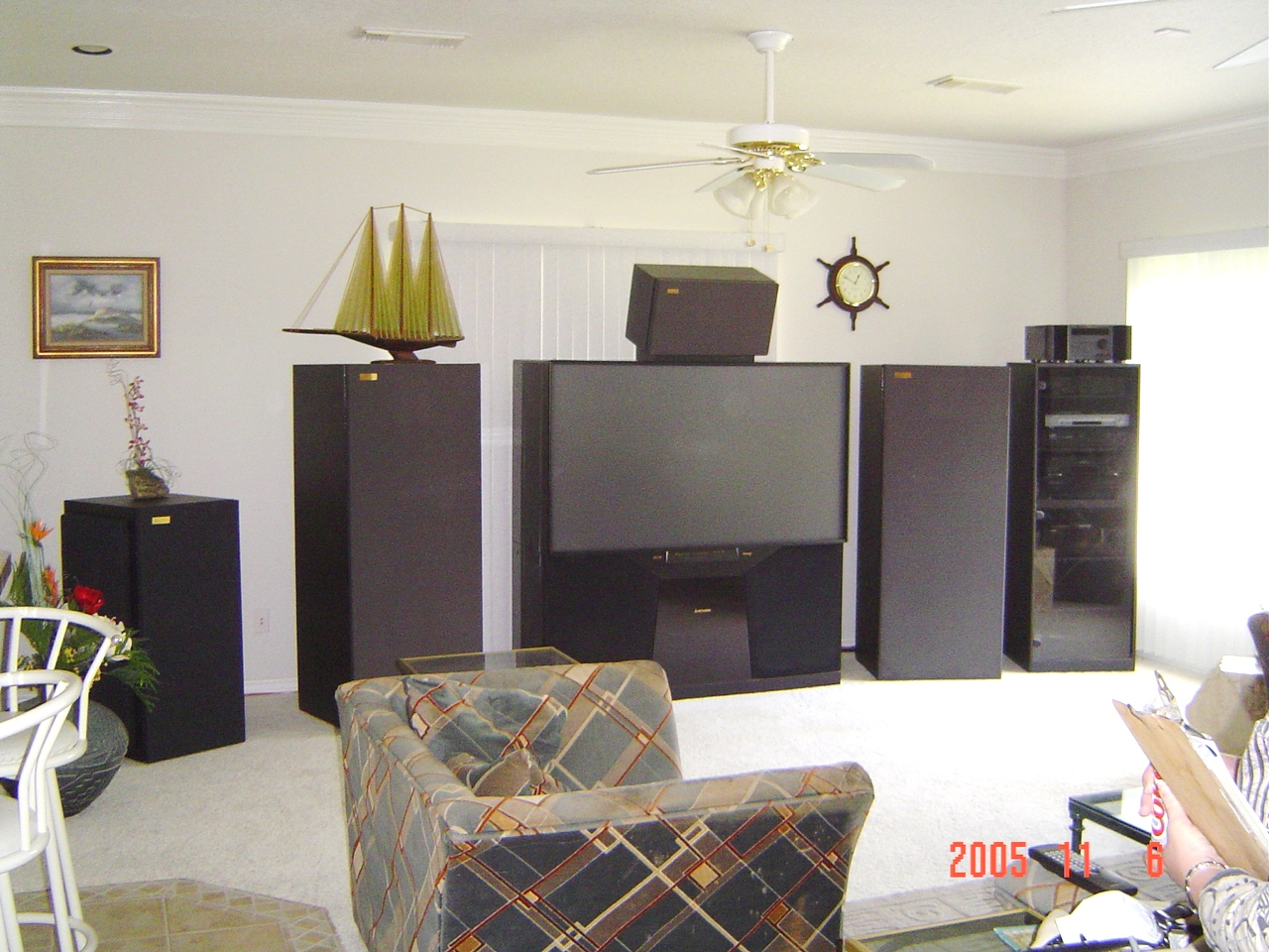

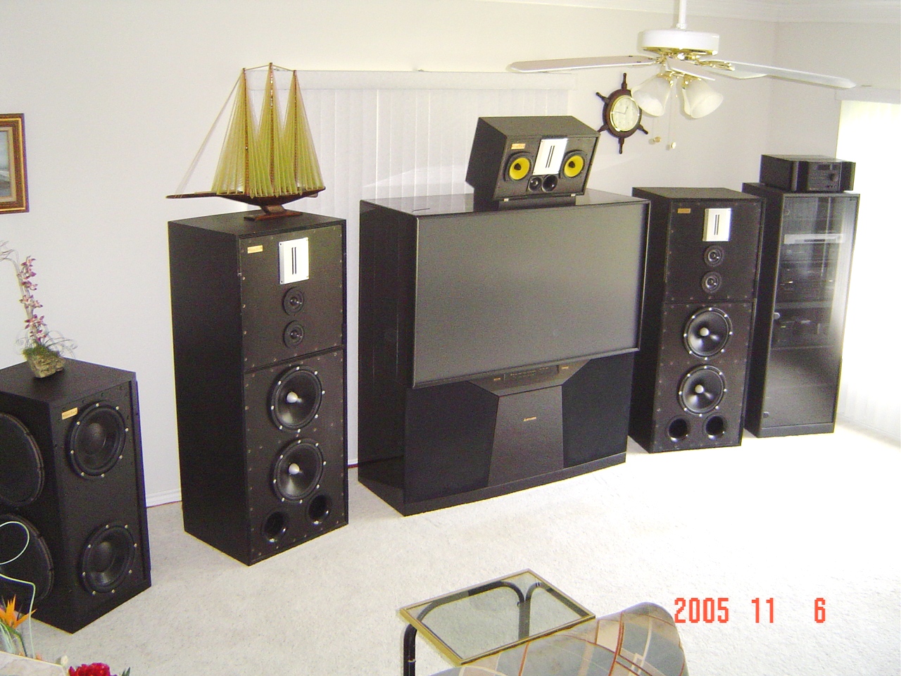

- Single Cabinet and Dual RL-p 15's for Home TheaterHere is the link to the finished project and associated construction photos and descriptions of the materials used. Follow the rest of the posts in this thread to see how I blew out the existing passive radiators, then I had to rebuild them again. I am driving this beast with two amplifiers now and have made posts regarding the final outstanding results in this thread. http://photobucket.com/albums/b148/mfishmike/ I'm rebuilding my home theater subwoofer for the 3rd time and am anxious for the delivery of the 2-Premium 15" drivers. I'll be installing them in a 1 1/4" walled cabinet with 4-1500 gram 15" passive radiators. I've been using two 12" Titanic MKIII's, but am not getting the performance in this type of configuration that I really want. The passive radiators eliminated the mid-bass boom and really smoothed out the bass with the Titanics, but the over all performance was not what I was hoping for. This is an expensive way to build a speaker, but you get what you pay for! I'll have two active and 4 passive drivers in a single cabinet. I'll keep the group posted with the results and am open to emails. I see more posts in this forum relating to auto installations, so for those of you that are interested in the home theater use of Mike's Sound Splinter Premium drivers, watch my posts as I'll have them finished by the end of the weekend. Attached is the photo with the Titanics before I disassembled the cabinet last weekend. I hope to be ready for the drivers when they get here Thursday. Mike Cason
