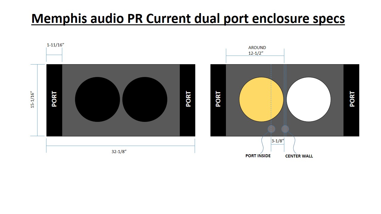

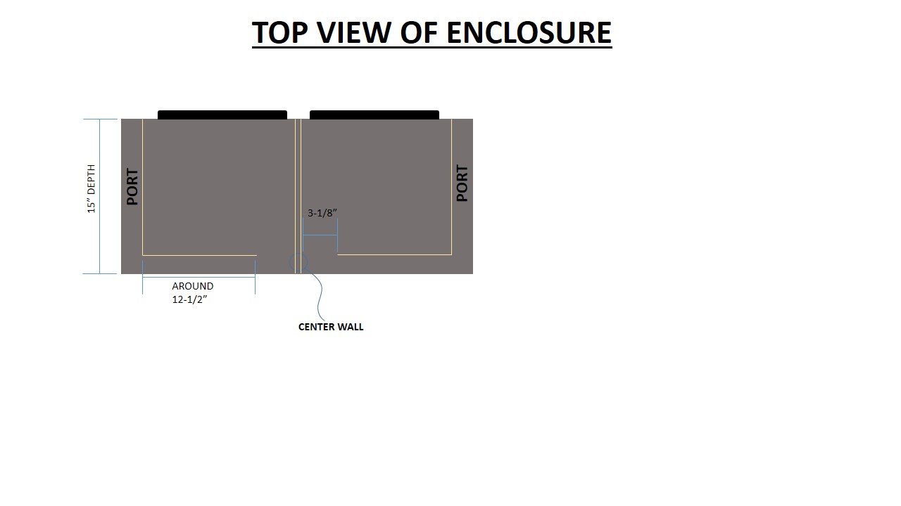

  6. The enclosure dimensions are 32-1/8" wide, 15-1/16" tall, 15" deep. The port is 12-11/16" wide, 12-5/16" long (from front to back) and around 12-1/2" long from side to side. On the inside the port distance from the wall in the center of the box (since each sub has its own chamber) is 3-1/8" From port inside wall to the wall in the center of the box is 12-1/2"

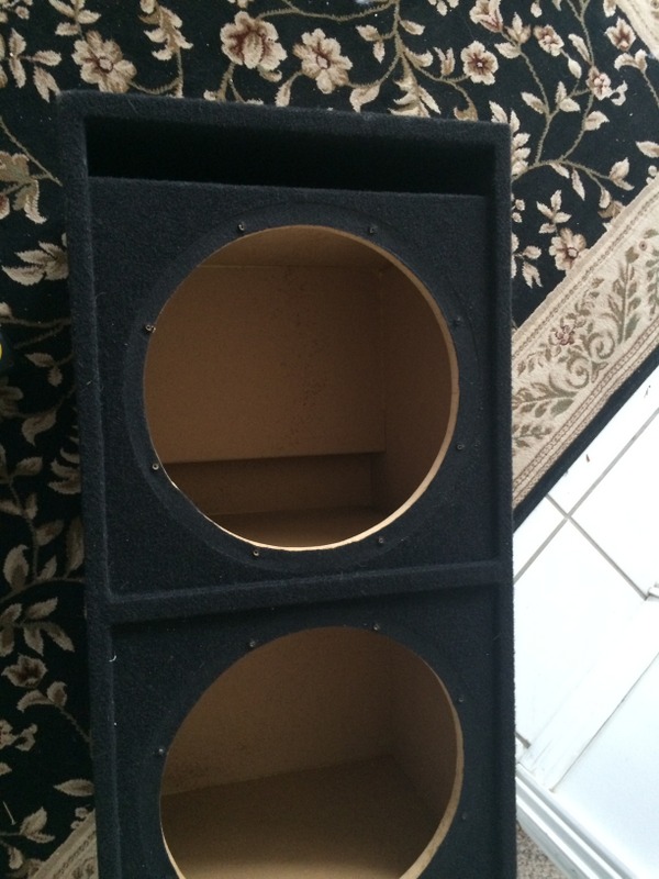

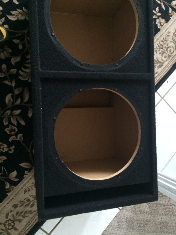

  7. I just got an e-mail back from Memphis Audio and they wanted me to send them pics of my subs. That way they can send me the exact parameters of the subs. I decided I would give you all the information that I could, about my current enclosure, which might help in the new build. I made a sketch of the measurements in PowerPoint, but it says "You aren't permitted to upload this kind of file". If you know of another way that I can upload the Powerpoint drawing, please let me know and I will upload it, or I can just send the measurements to your e-mail. Here is a pic of the enclosure, first is the left side of the box. 2nd pic is the right side of the box.
