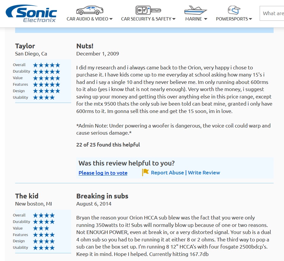

		i found the review from sonicelectronix stating the damage by underpowering subs.. also the second review, the guy says the same thing..

		the first place i read this warning from manager was in the review section on one of the subwoofers they sell. Some guy left a review stating he was only giving it half or 1/3rd the rms and it still sounded good then under that in bold it says managers note: under powering a sub for extended periods of time will warp the voice coil and is not suggested. i tried finding the review so i could post it here but wasnt able to find it .. but i will again and will post it here when i do.

		is it safe to underpower subs by almost half of what they are rated for? staff at sonic electronix said it is dangerous and not recommended because it will warp the voice coil or something like that.. so the xcon is also out of stock?

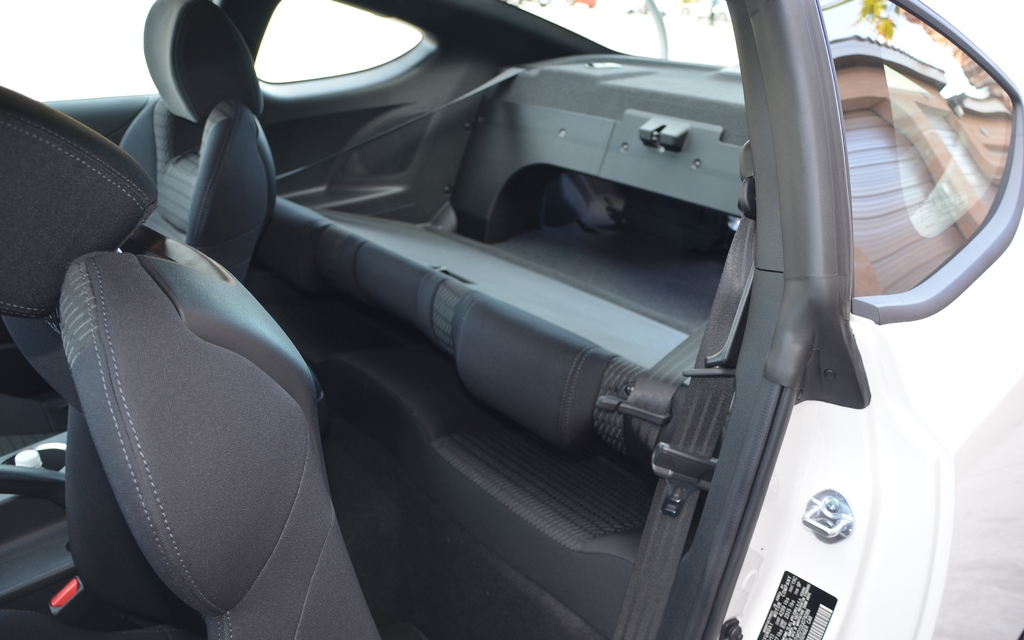

		my box is a design approved and recommended/tweaked by sundowns technical guy. im thinking its my car and trunk.. a lot of the bass gets trapped in the trunk,. when i fold the back seats down , like on most cars, a big hole should appear but for me i have a 8 inch high x 28 wide hole,. its almost like my trunk is a large ported box,. and then i put another ported box inside it,...not a good car to run systems in. Its a genesis coupe btw. The car came with a factory 8 inch JBL sub firing up into the cabin mounted on the rear deck. For an 8 inch it sounded great. why? cuz all that bass was flowing directly into the cabin and bypassing that shitty bass trap trunk. so not only do i have a bass trap trunk,. i have a trunk that has a very small opening where i can only fit a box with max dimensions 13.5 high x 30 wide x 16 deep. So im limited in enclosures. note: i was running a single sa 12 ported,. sounded decent in my car,. sold it when i upgraded to the zv3 12, when the guy who bought it came to pick it up he wanted some help to put it in his car and to adjust his amp. So i helped him, gave it a demo,. night and day difference,. i almost didnt want to sell it when i heard how much louder it was in his car. he had an older acura integra,. hatchback.. no thick metal trapping the bass in his trunk. the cabin and trunk were one unit and all the bass filled up his car proper. My car.. the exact opposite ive almost thought of selling my car and getting a small suv or hatchback.. but ive done too much work on my ride to let it go
