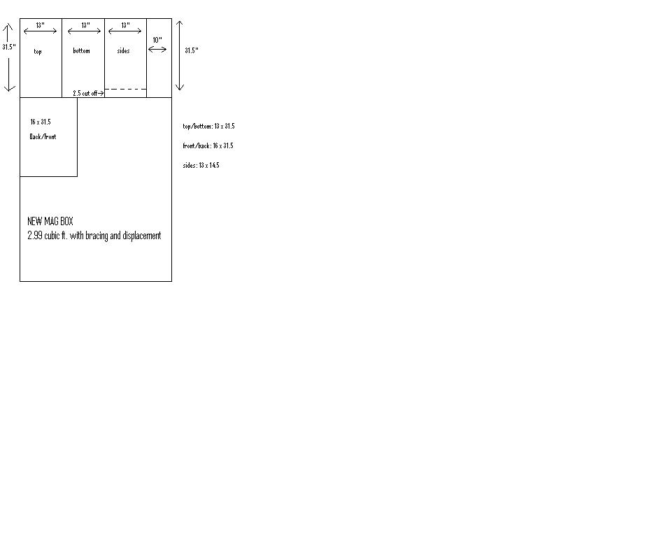

  4. I am working on sealed for my 15 as we speak. Anyone come up with one that's 3.5 cubes at 27 that will fit in a trunk? My box will measure 16 x 14.5 x 31.5 and end up being the 3 cubes after bracing and displacement Just looking for other good ideas for a box that would work for me and maybe help others who haven't decided on what their doing yet. and.... HOLY chit am i excited i get a tomorrow...

  8. making my new box already.... bout 3.2 cubes sealed with doubled front baffle add some bracing an im looking right about the 3 cube mark. hmmm.... wondering if i should flush-mount it....
