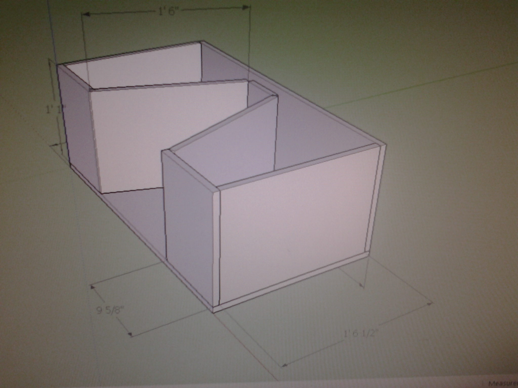

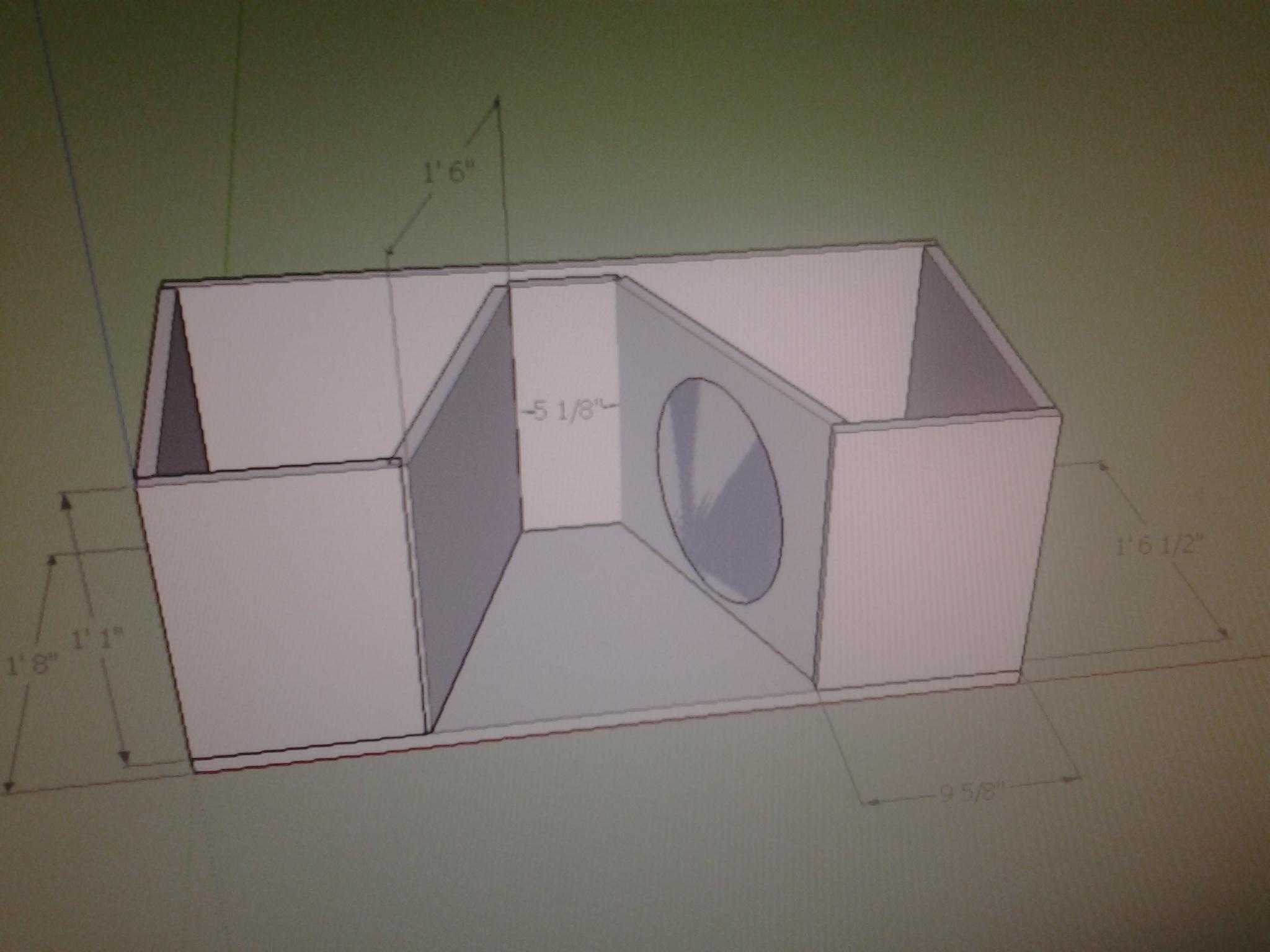

help with air space
Ok I'll try that
help with air space
The internal height of the box is 13". So I would multiply 13x1.2608 = 16.3904. Do I now divide by 1728? Is then I have 0.00949.
help with air space
Feet and inches
help with air space
When I right click the floor and click ( area) then click (section) I get 1.2608 is this what multiply by the height? Or is this the 1.2608 the internal air space?
help with air space
I came up with 16.38 is that rite??
help with air space
Thanks, im pretty decent with tools but not math..lol
help with air space
Yes, just trying somthing new.
help with air space
I just built this box for 2 first gen dcon 12's but cant figure out the cuft3. Need help. Thanks for any and all replys ps. Still learning skech up
