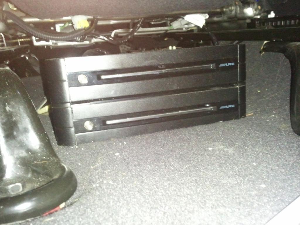

Thanks man. As far as the equipment goes, I think I could have probably got some better stuff if I did more research when I bought it all. I could have saved some money and got some better amps instead of the Alpine PDX. All of the huge power smaller brand amps out there today are insane! I know these mainstream consumer brands that are on store shelves aren't that great. Brands like Alpine, Kenwood, Pioneer, etc. Aside from the head units, you never see any of these awesome builds online using any of these Brand Name amplifies or speakers. I went toward the PDX because of all the fancy tech Alpine describes that they are built with, but more than anything else was the size and that they are stackable. They fit perfectly under the driver seat in my truck which is very limited on places to put equipment while maintaining the daily use of the vehicle. I noticed that when I went from the ID to the Eminence, the sound quality changed. The ID sounded very natural and smooth, and things like guitar strings and vocals just had a much more full and clean sound to them. The Eminence are definitely louder, and sound fine on loud rock music and rap, but everything sounds more compressed together, or maybe muddy. It just doesn't have the same sort of depth and fullness to them. They have been fine for $40/each, but I'm missing the overall sound quality and enjoyment of being surrounded by it. That is why I'd like to get a more normal type of speaker back in there. You think that I should just get rid of the rear door speakers completely? Even versus just putting some decent value priced 6x9s in there and running them on the HU or just a small 2ch to add a little more volume and sound in there? I know that rear fill is really not intended to be listened it, but it does at least put some sound into the back seat.

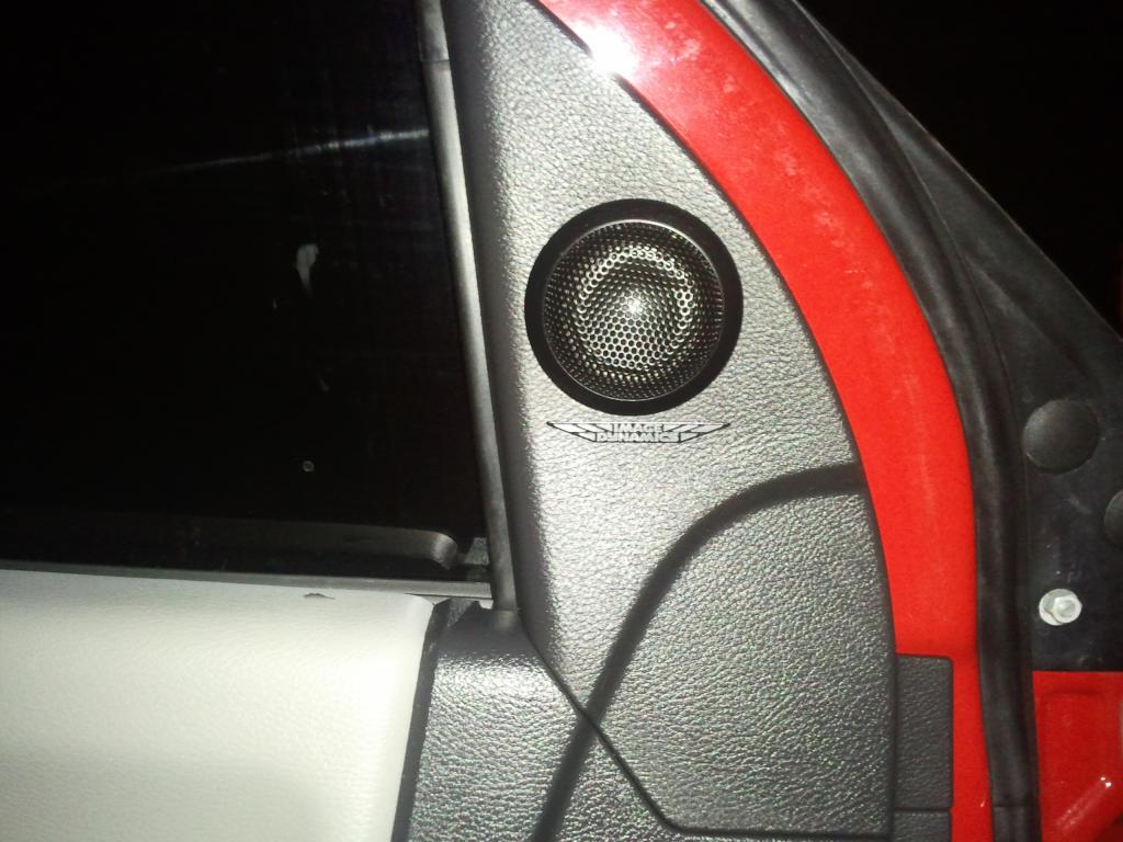

I *think* that the ID xs-28 tweeters are actually pretty good? These still work work fine, and if I can avoid having to buy a whole new set of tweeters, I'd rather keep what I have. When I had the XS components complete with the XS mids, Tweets, and xovers, it seemed to sound pretty darn good. Those XS 6.5's are expensive to replace though, and that's why I bought the eminence that I have now which are going buh-bye. They don't sound nearly as good as the ID's did, but they play loud. I assume the FI N.7's are probably good speakers? But I don't know. I was looking at the PRV originally simply because of the power handling and the cost. Now that I see the FI's are $150/pair vs each, that is something I'd be fine with. I can afford $150/pair, but not $300/pair like I originally thought they were. I know that FI makes good stuff, but I haven't seen any reviews of the N.7's. It seems that these are SQ CAR speakers and not PA speakers like a lot of the other offerings. From what I understand, PA speakers are generally louder and allow for higher powered amps, but don't sound nearly as good? That would make me lean toward the FI. I just need to verify that those 7" speakers are going to fit. If they won't, I'll have to go back to a 6-6.5", and then again I'll need some help since the PRV are no good. A friend recommended the Crescendo's, not sure which one, or the Evil? My ideal options then would be the Fi N.7 along with my current ID XS-28 tweets for the front stage. Then I need to find some 6x9's to fill my rear doors. I may end up running those off the head unit for now, and then maybe get a compact 50-100w small 2CH to power those in the future. Again, I want a good value that will work well for the rear speakers without breaking my bank. As far as processing, right now I have the OEM head unit running into a JL Audio Clean Sweep CL441DSP to flatten the factory EQ, then the front channels run into a Audio Control DQT 1/3 octave digital EQ. People have told me that this EQ is junk, but it's what I have, and with 1/3 octave plus a couple of parametrics built into it, it is going to have to work I can't afford to buy another new EQ on top of the other items I need to put this together. The subwoofers and rear channels we're just coming out flat from the Clean Sweep and into the amps without any further processing. To go active on the front stage, I believe that I need to get another active Crossover since the crossovers on the PDX-F6 limit to high pass to 400hz, which I would think is far to low for the Tweeters. So right now I'm in the market for some sort of quality crossover in order to setup the active front stage. Any recommendations that are good without costing a fortune? And again, with those ID tweeters on the Fi n.7 mids, where about would the tweeter hp need to kick in? I have already spent a lot of money (for me, this is a lot of money. I'm not rich) on the current amps, subwoofers, etc. Add to that the $450 I spent on the new SoundDigital subwoofer amp, plus the money I need to spend now - $150 for the Fi door speakers, $???.?? On some sort of crossover, $???.?? On rear 6x9s, $???.?? On more wire and cables, etc. This will be the most money I've spent on any car stereo. I know that it's not going to be anywhere even close to what a lot of guys have into there systems, but to me it's a lot of money and it's what I can afford, so I am proud of it. I just want to update it and improve it a little bit with this new stuff and have something that is going to sound pretty good and play pretty loud. And to sum this up, I need help with: - knowing that I would be making a good choice in the FI N.7's for the front doors, and if I cant make those fit, a recommendation for some 6-6.5" speakers that sound good and can take the power and stay in that $150ish area. -that my ID XS-28 tweeters don't suck and will work well with the FI 7's and active power -recommendation for a active cross over to allow me to run my fronts actively. I think that I just need an active 2-way cross over for this? The sub amp has it's own built in crossover, unless it would work better to get a 3-way and use that for tweets, mids, subs? -recommended cross over freq for the front tweeters and mids -recommendation on some affordable good 6x9s for my rear doors. Thanks guys for all of your help. I appreciate you guys taking your time and sharing your knowledge to help me get this together the right way since so many of you have so much more experience and knowledge on this stuff. I can't express my appreciation. Im sorry that my posts are so long. I have a hard time trying to get everything that I'm trying to say into a short post. I'm just not good at it. I've also attached a few pictures of what I have now. Those 6" ID speakers that I built a 6x9 adapter for are no longer being used. Since one blew, I replaced them in my front doors with some Eminence crappy PA speakers because of how much the replacement ID XS speakers cost.

Active... Thanks! I wasn't sure exactly what to call that. The Fi's for $150 sound like a great deal. I would just have to make sure they will actually fit. If I do to active, where would a good starting point for the crossovers to use on the Tweeters?

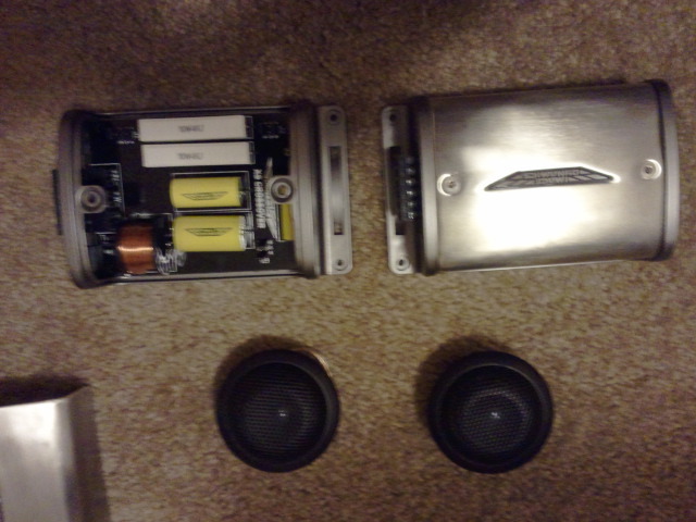

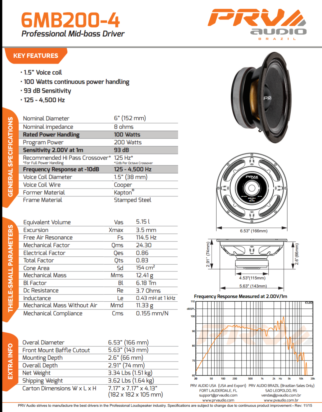

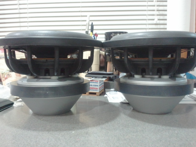

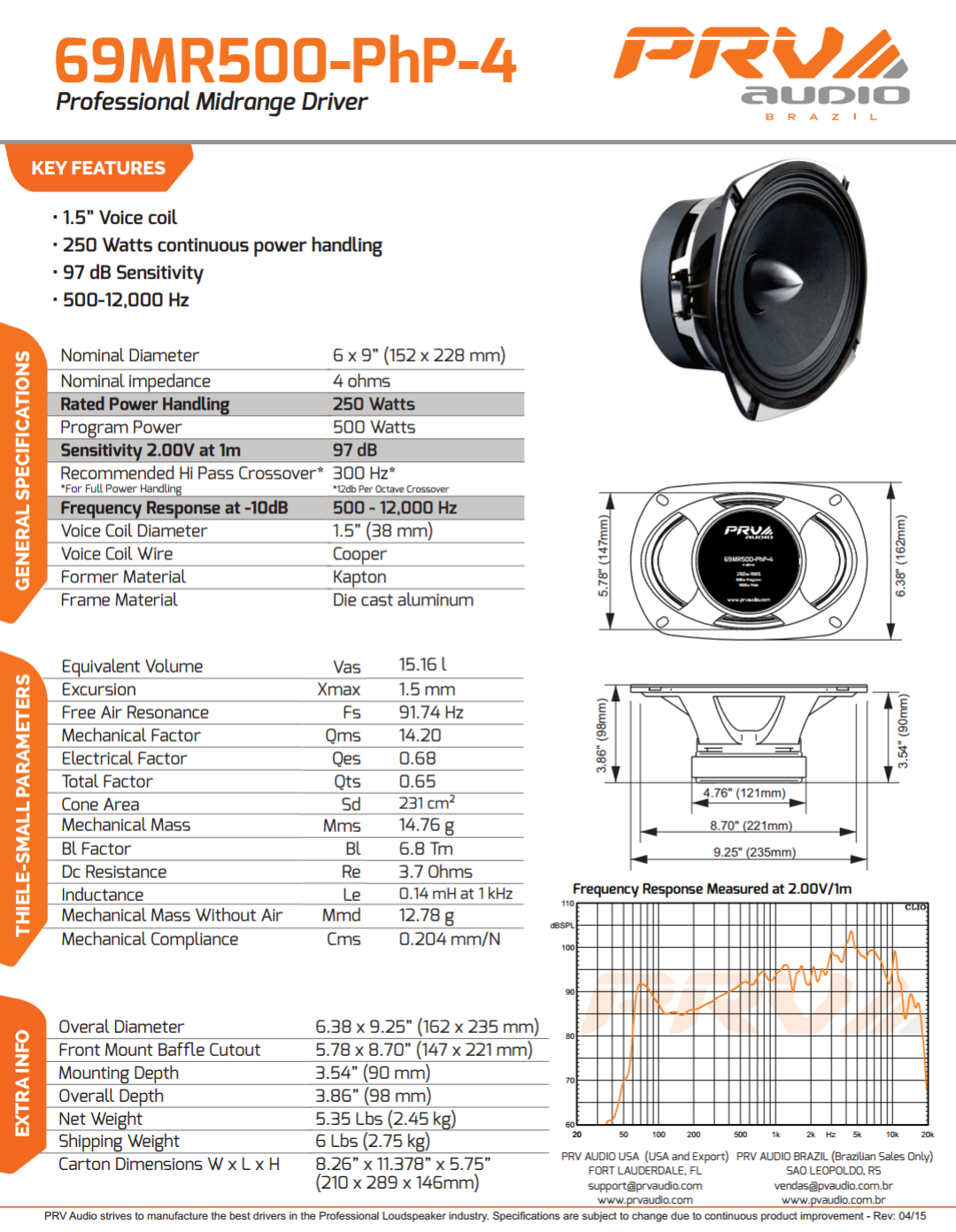

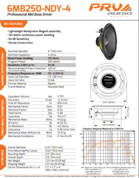

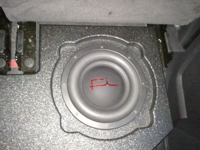

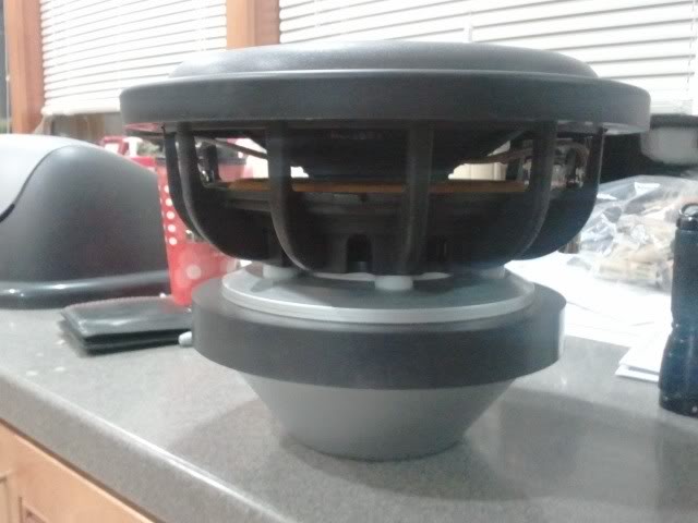

Hello everyone. It's been a while since I've posted here. I've been driving and enjoying the stereo in my truck for awhile, and now I wanted to make a couple of changes and I was looking for some advice and/or guidance in doing so. The current situation... I have a Ram pickup which currently consists of the following: Stock Uconnect head unit -> JL cleansweep -> front channels Audio Control DQT -> Alpine PDX-F6 CH1&2 150x4 -> ID XS-65 Components (using the XS x-over and tweeter. The 6.5 has been replaced with an Eminence Alpha after blowing the XS6" mid) . Rear channels go from clean sweep to PDX-F6 ch 3&4 -> ID CTX69 6x9's. Front channels also split directly out of the Clean Sweep to a Alpine PDX-M12 -> 2 Fi SSD 10 subwoofers (not the current version. Mine have the "funnel??" looking motor structure. Proposed update: I was thinking about using all 4 channels of the PDX-F6 for the front speakers. Instead of using CH1&2 going to the XS crossovers and then to the mid and tweet, I was going to use CH1&2 to the mids, and 3&4 to the ID XS-28 tweets that came with the XS-65 components and probably either FI N.7's or one of the two PRV 6.5 options in the attachment, and letting the rear fill run off the head unit power or possibly a small 2ch amp. I also recently picked up SounDigital black EVO SD3000.1 which hasn't been installed yet, but will go-to the FI 10's. The PDX-M12 will go on the shelf I guess. It seems like a great amp, but @ 1200Wx1 , each subwoofer only gets about 600w each. The people are FI tell me these woofers are happiest with about 1000w each, which is why I bought the SD3000.1 , which I guess I'll have to turn down a little bit to not kill the woofers. Is this a good idea to use the 4 channel completely for the fronts instead of just 2 channels and the passive xover? Or should I keep it the way it is power and xover wise? I'm going to replace the Eminence 6's either way, I just haven't decided which speaker to use. I like the FI N.7 by the description, but I'm not sure if the $150 is for a pair, or each. I'm trying not to break the bank. The PRV looks interesting with the neo mags, but I don't know anything about them. I've never used components with individual amp channels powering each component. I know that there is power loss by using a single channel with passive crossovers, but maybe the 150w/ch is sufficient for that setup? Next question is if I do use the 4ch for each speaker along with active crossovers, where would a good starting point be to set the HP filters for the Tweeters? Lastly, I'm getting some buzzing from one of the rear 6x9 speakers, so I was looking to replace those. They are rear fill, and depending on the setup will either use 2ch of the F6, or run of either head unit power or possibly a much smaller 2 ch amp it the head unit does not provide enough power. Im looking for speaker recommendations. If I stay with the F6 on them, I need something that will handle the power. I saw that PRV makes a 6x9 rated at 250w RMS with a 1.5" coil, which seems like it would handle it. Freq response is only rated for 500-12k which I don't know is ok for rear speakers. Is there another recommendation which isn't super expensive? I'm attaching photos of the two PRV 6's and the one 6x9 that I am considering. I'm sure that someone will tell me I'm doing everything wrong. In trying to learn and that is why I'm asking these questions. Any and all advice is warmly appreciated. Thanks in advance guys!

What would a good option for mids be then? The main reason I out the Eminence in was because one of the Image Dynamic speakers I had went bad. I was looking for something with a little more power handling and not too expensive. I'm totally open to ideas

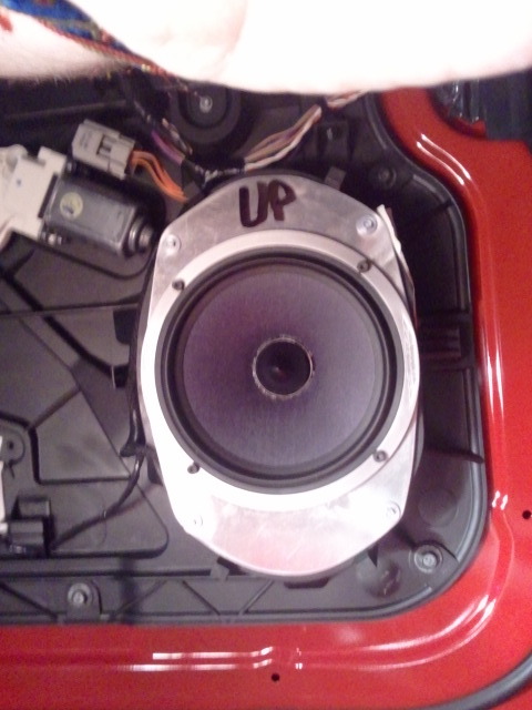

Hey guys. Just trying to get some quick help. I have Eminence Alpha 6 4ohm drivers in my front doors. One is buzzy, and I want to replace the pair. I am torn between the Cresendo PDX-6 , or the Incriminator dpx-6. They are running on an Alpine PDX 150/ch. Is there another option I should be looking at? Or are those two options good? Is one preferred over the other? Thanks!
