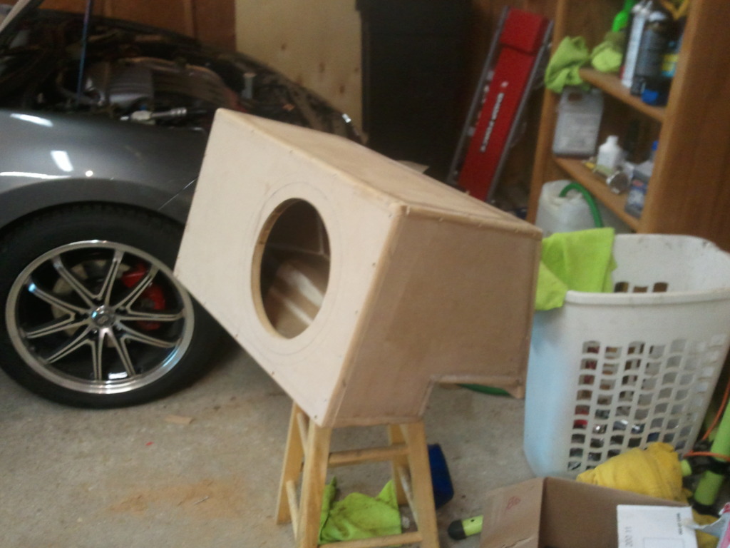

grrrr How come my notifications never work?? Anyway, port 8x2x20something (can't remember, don't have my stuff here) as far as improving, here is what was going on... I had the Type R in a tiny enclosure, and it really just didn't not produce much SPL or play very low. It was a day I had nothing going on, so I broke out the MDF and saw's with the idea I just wanted something that was louder and played lower. I didn't plan on using the 10" Alpine in it when I was building it, I just didn't want to be without any low end in the mean time. Turns out, this little Alpine plays VERY loud and sounds pretty darn good. What I want is a woofer that can play rap like Zoe, Jeezy, or anything else, plus a bass disc here and there, and play it loud and clean. Right now my sun roofer pops out, visors shake, etc. At the same time I listen to a lot of rock music, so I would like to be able to dial down the sub level a few clicks and be able to enjoy loud harder music while keeping my kick drums and bass lines tight and under control (is this asking too much??)

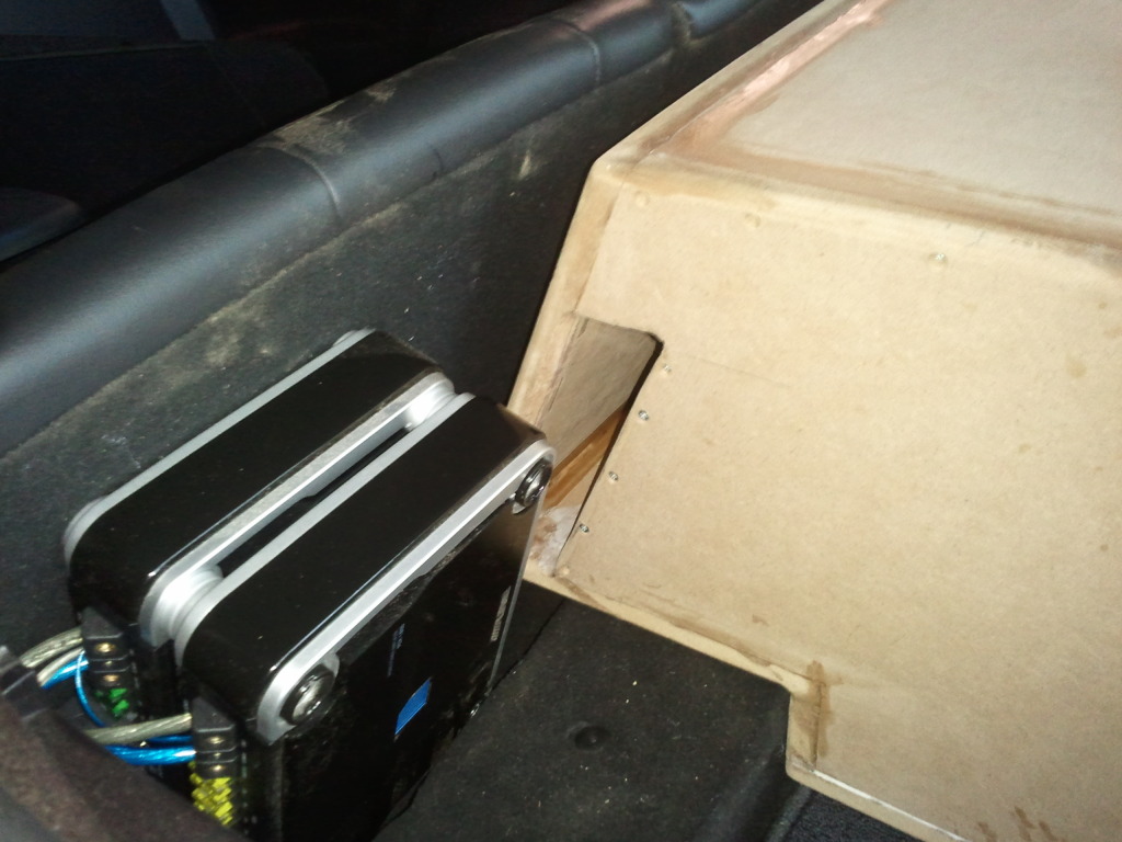

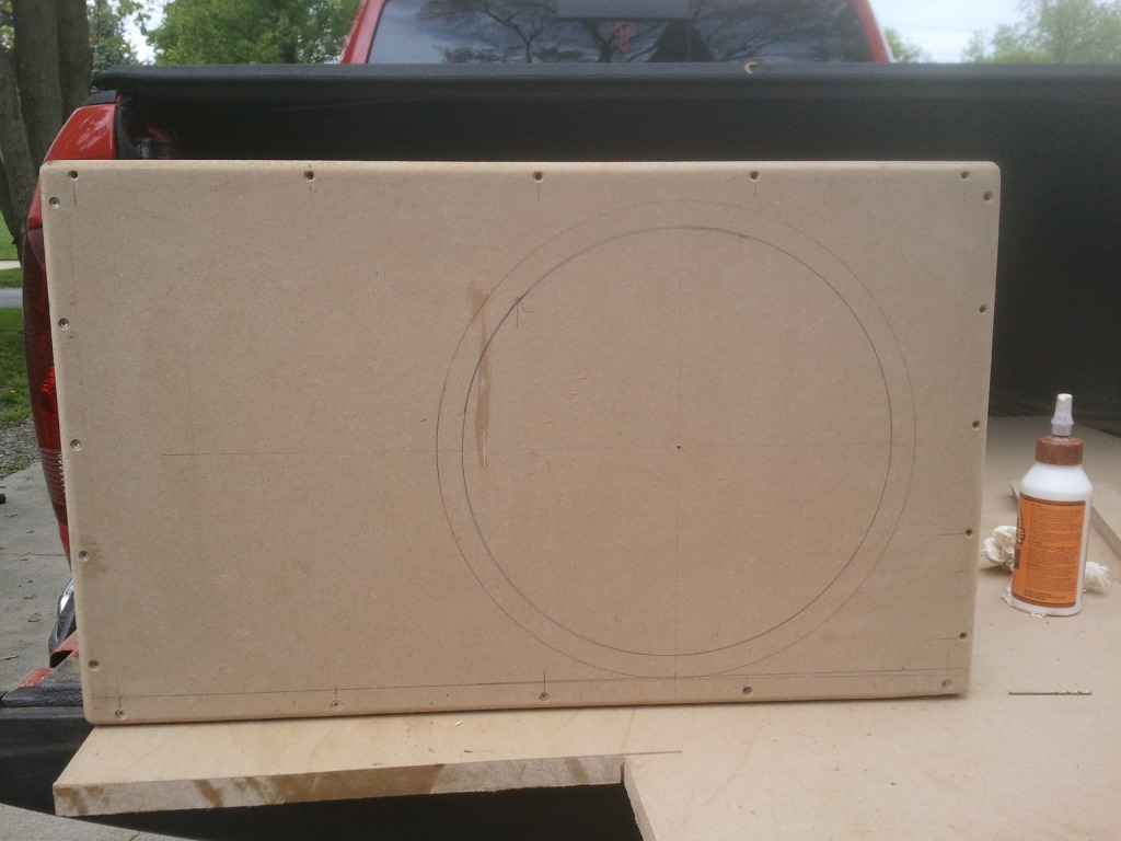

Whats up...first wanted to say thanks to everyone on the SSA forums.. Very glad I found it. A lot of good info and members here.... now that I'm done kissing ass lol ..... I need some recommendations.. I recently built an enclosure to replace the old setup in my Eclipse. I built it to fit how I wanted in the hatch, and did not have a pre-planned volume. When I finished this thing, I ended up with: 1.62 cu ft Slot Ported @ 32hz 7.5" max mounting depth. I layed out both 12" and 10" cut out patterns on it, and have a Type R 10" temp mounted in it so I could still play until I chose on a final driver. I'm actually very impressed how the Alpine is playing in this enclosure. 100x better than it did in the small sealed enclosure it was in originally. The mono amp is advertised at 600w RMS, however birth certificate states 756w RMS. It does this at either 2ohm or 4ohm which opens up a few more options for woofer selection. After searching for a 12" woofer with rec volume which works, mounting depth, and Qts, it seems that most of the woofers I have found want a little bit more volume. I emailed a few companies, but Skar was the only one that actually replied. Kevin from Skar replied quickly, and tells me that this setup would work great with the VVX12. To me it looks like a very good option, however I would like to see if anyone has any input before I actually order the Vvx. I've never seen a Skar woofer, let alone heard one, but people seem to think highly of them here. I would feel better if it was a US made driver, but he assures me they are top quality. Anyway, I'd like to spend about $200 at the most, and if anyone has any other suggestions, or confirmation that the VVX12 might be my best choice, I'm open for ideas... fwiw here is a picture of the enclosure. This is before the bondo, putty, sanding, and finished coating, but you get the idea...
