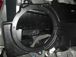

  2. Well I am around 4.6 plus adding a 3/4" MDF spacer so will have alittle more should give me 1/4" ish for pole venting will this work?

  4. It is and have looked at that but its so big in the back I think it will not fit the contours of my enclosure if you look on the left I have a thing sticking out on the box I will need a traditional sub nothing to crazy. I would LOVE to install the SD big fan of that sub. Also on top it swoops down. I have dremmeled this out since picture but the basic structure behind is still there and will give me issues if the sub has to big of a magnet.

  7. So the JL did not fit as it was to wide and hit on some areas of the enclosure. However a JL-W1 fit just fine. I am concerned about this sub as its max RMS is 300 and my amp is 600 in 4 or 600 in 2 ohm on the PDX600. I would like to find a woofer that can deliver the best punch for the money. The JL-W1 is 4.6" mounting depth and I could buy another 3/4" by using a mounting plate which I am leaning towards as it will give me a good area to mount to as well. I know this W1 woofer is tapered more and that I will need as the contors of the box will limit my depth. So again reaching out for recommendations on a 5" mount depth sub around 400-600 RMS. Also should I worry about 600 vs 300 sub I do think it voids the warranty. I also thing 200 can get me a lot more sub else ware.
  8. Hello all. Need some assistance. I have a 2011 Lexus GX 460 with Mark Levinson sound system. The system sounds great except for the sub.I have pulled off the back panel and reveled that the factory was a 10" sub. I currently own a Alpine PDX 600.1 I will put that behind the panel and will replace the sub run a LOC. I checked the factory sub and it was 8 ohm surprisingly but know if I replace and wire up a replacement sub it will not give me what I am looking for. I previously had my PDX 600.1 running a JL Audio 10-3v3 it does not fit its around 6" mount depth. That sub in a small sealed box rocked and am looking for something similar in the factory location. I might experiment with some poly fill in the factory plastic enclosure. So to my question. Recommendation: Need 10" Sub my mounting depth is anywhere between 3.5 to 4". I might be able to swing another .75 with MDF Spacer. I was looking at Jl Audio 10tw3-d4 Shallow-mount 10 but wondering if there are better options. https://www.crutchfield.com/p_13610TW3/JL-Audio-10TW3-D4.html
