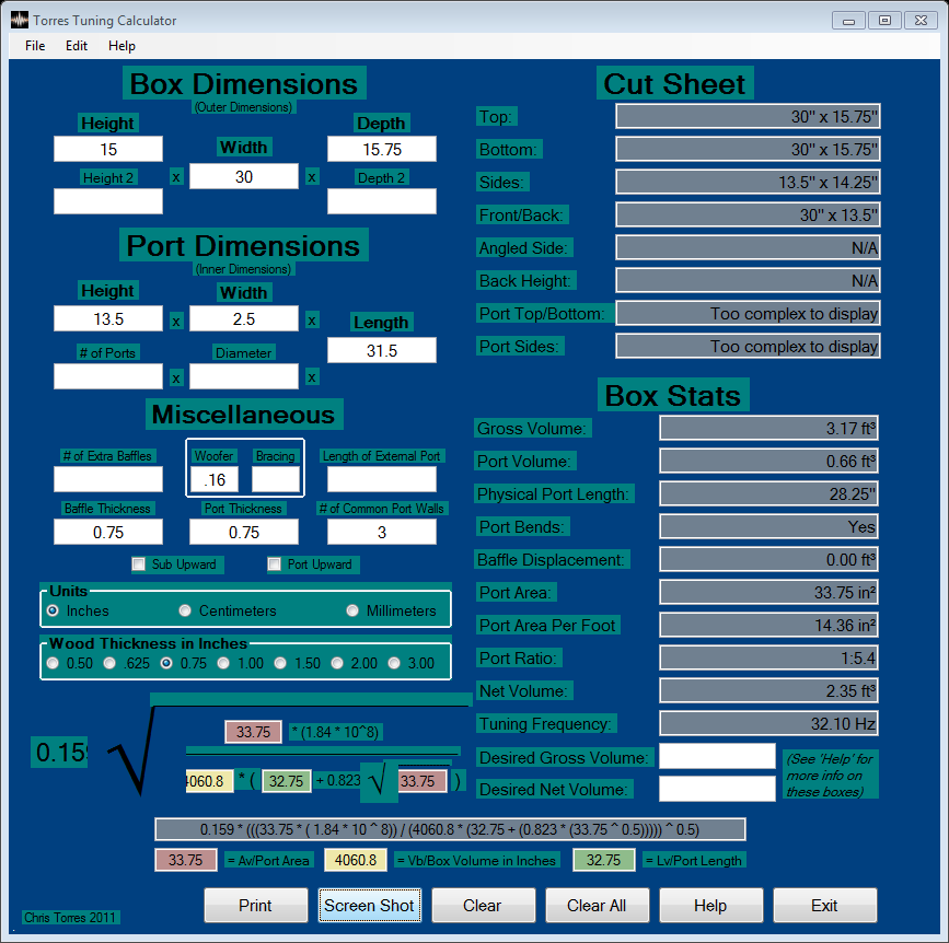

  1. Thanks, are the settings input correctly for the type of box. Is the common port walls amount correct? Once I get some time I'll start building. Also need see if the calculator gets update so that it's correct.
  2. Well, I came up with this box. If the specs are correct in the calculator, then this should work. Would just like a second opinion to verify that this is right and I don't was time and material. I didn't put in total box height since there is no top, but would be 15"
  3. I just got my Fi Q 12" back from getting reconed and now I want to build a ported box. I've never built a ported box and wanted to see if these numbers were right. I downloaded the torres box calculator thing and punched in some numbers that seem to work, but I'm not positive if it's right or not. I have a maximum of 30" W, 15.5" H. Depth has no limit but I'd like to keep it a minimum. I just want a good daily box and was basing this off Fi's recommended 32hz.

    I have an Older 12" Q thats blown. I''ve finally decided to get it reconed but I want to build a ported box for it too. I see the the diagrams and cut sheets for the new Q, but i'm not sure if that will work for older model Q. It's also unfortunate that the cut sheets for that one are a tad too large for my trunk. I have a maximum of 30W 15H 18D, but depth can vary a bit. i was hoping on building the box during the time it takes to get my Q reconed. That should give me enough time to learn how to design a ported box. I have no idea on how to calculate port length and all that jazz. Thanks.

  21. guess nobody has any advice or ideas. I'd try this but I'm not even sure that this calculator is accurate.
  22. Well I just recently bought a Q and since I was eager to listen to it, I put it inside the only box I had. The current box is a sealed box with about .9 ft^3 after displacement. Since its on the smaller side I threw some polyfill in the box as well. Now I want to build a ported box and I honestly have no clue as to where begin. I read through several pages, and found some plans but they don't suit my needs. I also searched online for calculators and only came across the RE calculator. I don't know how accurate it is but it kind of gave me an idea how port length affects tuning frequency. I'm a little tight on space and have a maximum of 30"w x 16"h x 16"d. Matter of fact, I'm not even sure if i can get the box into the trunk with those dimensions. I know it will fit in the trunk, but getting it in might be a problem. The smaller the better, but I don't want to sacrifice quality. Here is what I came up with by just punching in numbers into the calculator. If this calculator is correct, I still think the box is a little on the big side and wouldn't mind making it a little smaller if it doesn't compromise the sound. Advice and or suggestions are welcome.
