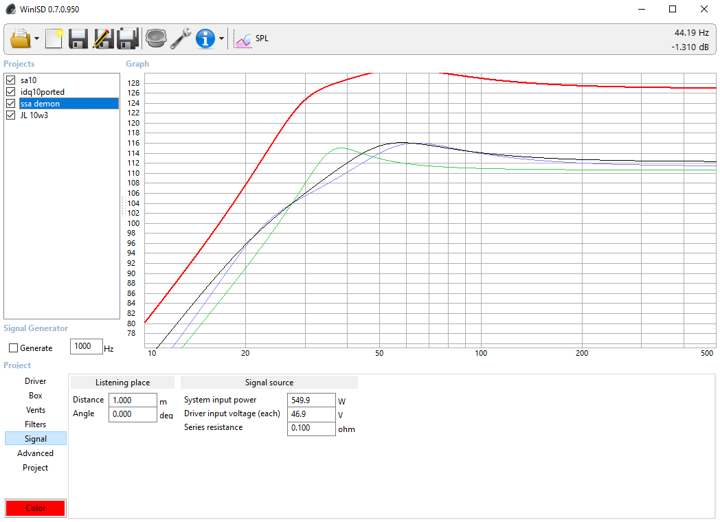

  5. I have a 2.05ft box tuned to 36hz for 2 10" drivers. I had 1 sa10 in a 1ft box tuned to 35hz and it's way too peaky for my tastes - shakes the whole car on lows but has hardly any output at higher frequencies, so music sounds "uneven". I'm trying to find a sub that has a smoother frequency response and sq but still gets decent spl. I've graphed 1 of each sub below, in a 1ft box tuned to 36hz (w/ the sa10 for reference). Each is at their recommended rms. I have no idea why the Demon is so off - I can't figure out what I'm doing wrong but I've triple checked all t/s numbers (if someone wants to try and graph that one for me feel free!) I'm limited to a max mounting depth of 6". Thoughts? red = demon black = 10w3 blue = idq10v4 green = sa10
  6. Long story short - I have a '19 f250 underseat box with 2 10" 2.2ft tuned to 36hz. and am trying to decide on drivers for it. I have a Sundown sa10 in a 1ft box tuned to 35hz - I'm happy with the lows but it drops off in the higher frequencies quick - in songs with a lot of dynamic bass frequencies I can barely hear bass in some parts and other parts it shakes the car, so it feels "uneven" during the song. I'm looking for a setup with loudness but also smoother over a larger frequency range. I've modeled an idq10, jl 10w3 and Sa10. in 1.1ft box tuned to 36hz (below). When I change the idq10 to two drivers and double the volume (2.2ft) the graph doesn't change. Shouldn't the dB go up? I figure that if I want the loudness of 1 sa10 but also a smoother frequency range I could go with 2 idq10's. Am I way off base here? Blue is sa10 Green is idq10 Orange is jl 10w3
