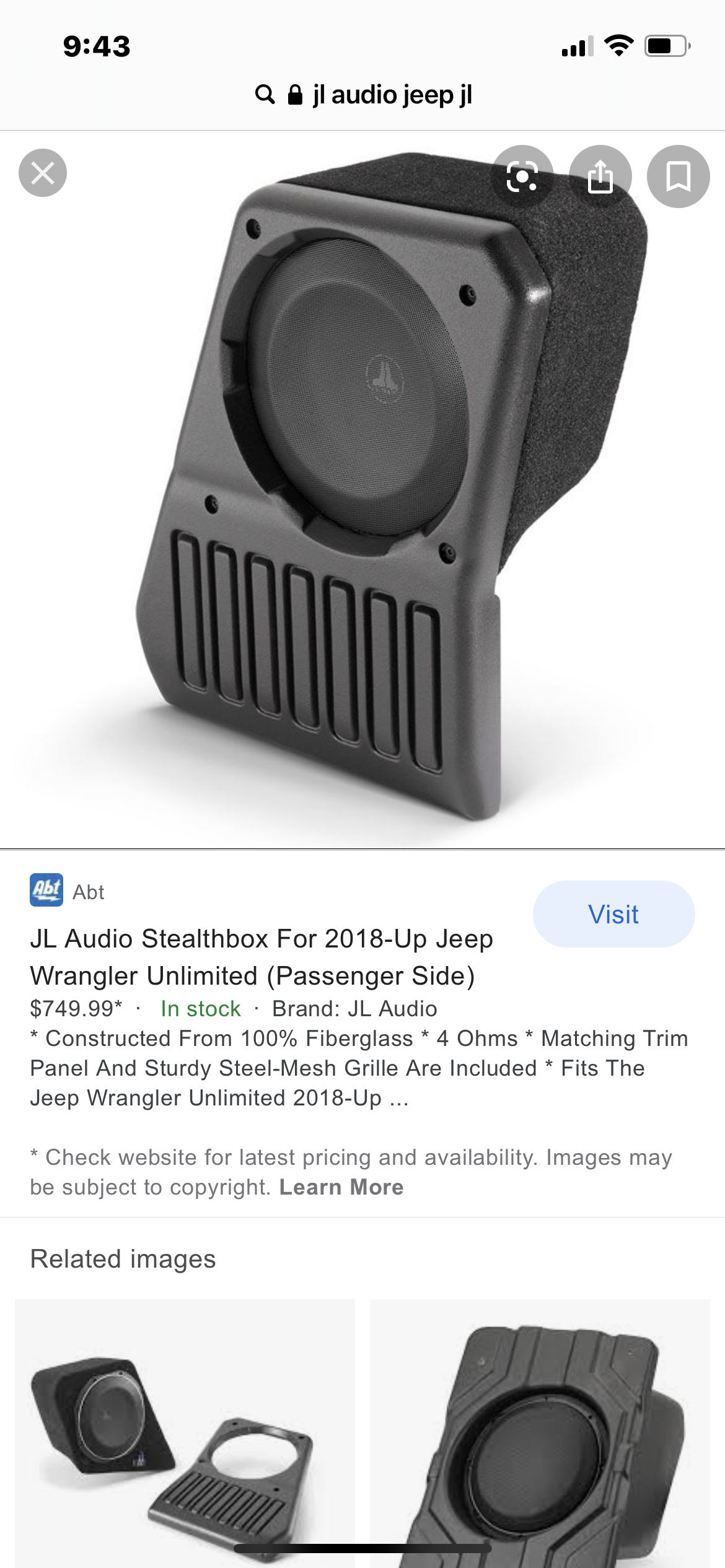

		Well, I understand Home Depot will actually cut the wood for me, so I can dot it myself. How it would turn out with the correct aero port and tuning is more of a concern of mine. I would really like to figure out a way to utilize the upper space between the back seat and rollbar and go out approximately fifteen inches or so from the edge of the wheel well. Also keeping it short enough to fit under a Tono or cargo cover (15” or so). This will deter the transients around my place of work from trying to yank it out. if I had a 3D scanner, it would help a ton. the JL audio stealth box made for them is similar to what I have in mind. However, they only use the upper space, which ends up being a very small enclosure. It also sticks up too high for a cargo cover.
