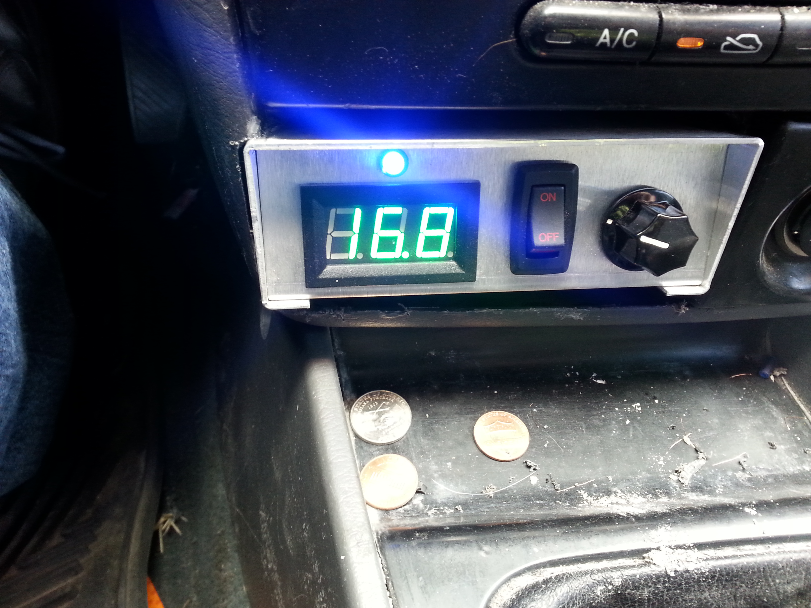

  9. Voltage regulator. I don't run it that high. Just to show for kicks

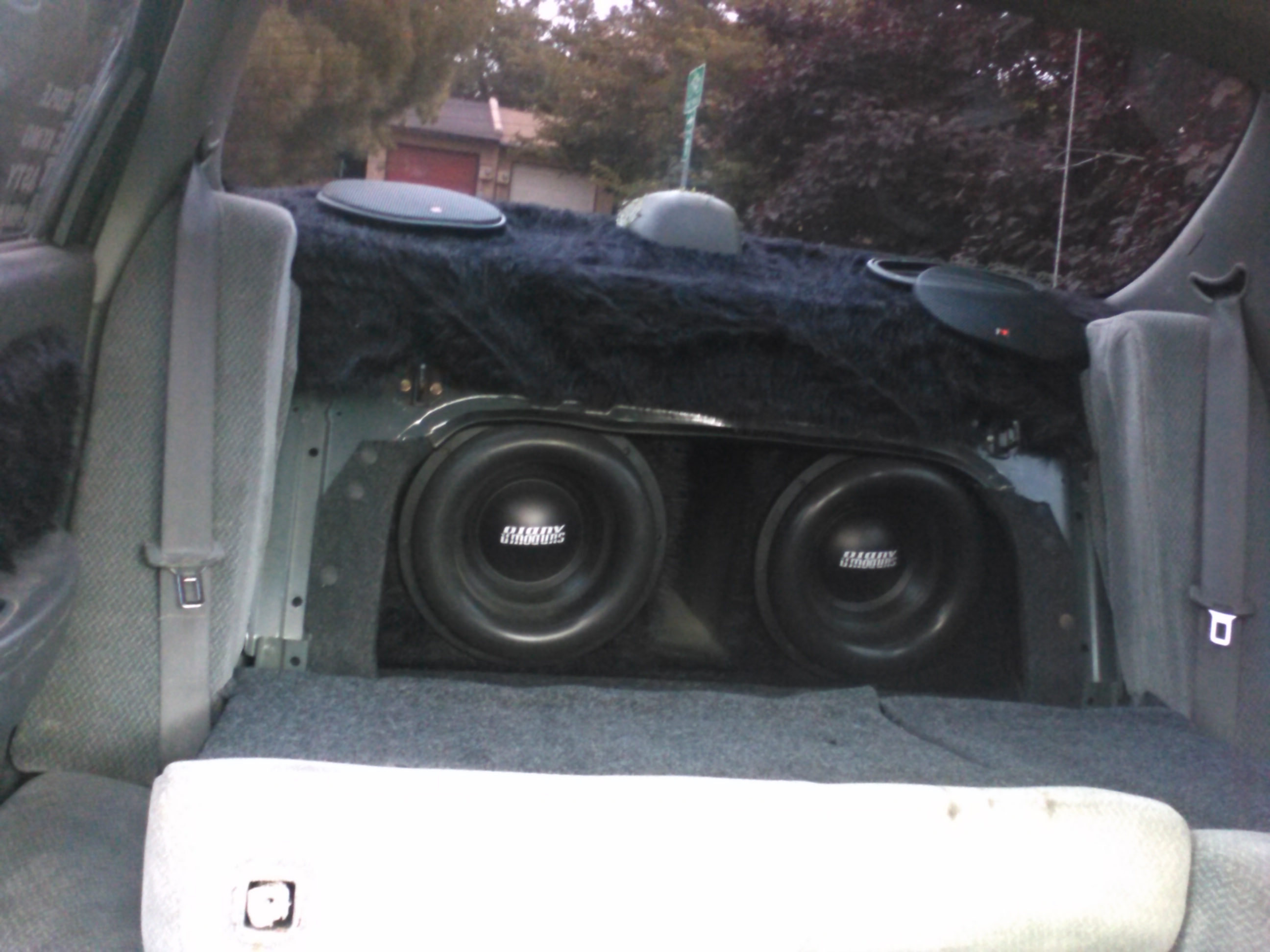

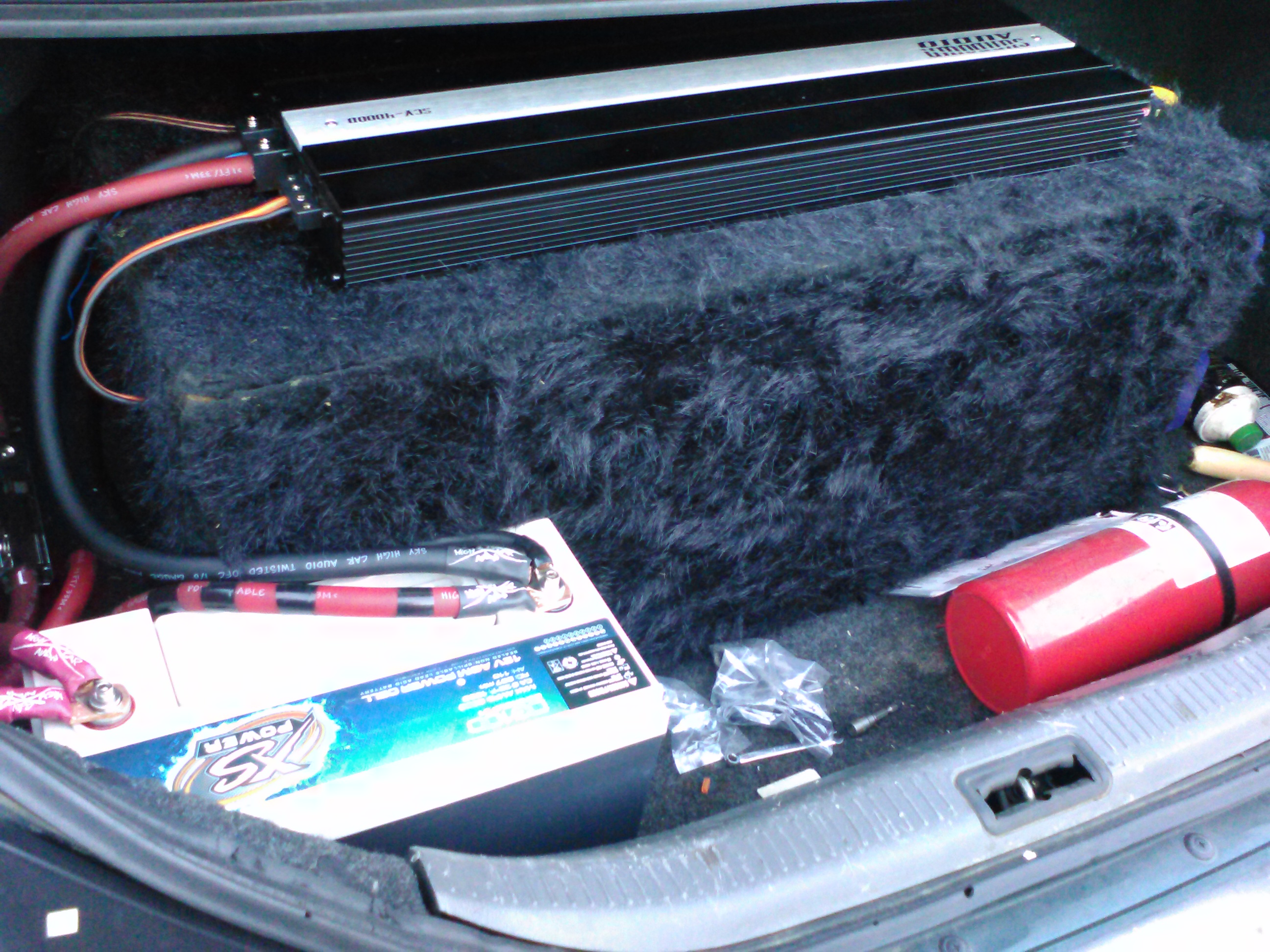

  10. I have a sundown scv-4000 amp, wired at one ohm. The sub's are 12" Zv4's sitting in a 4 cubic ft box, tuned at 40hz but loudest at 48hz. I have a 300 amp alternator wired with the big 3. All the wires 1\0 gauge. I have one Xs d3100 battery. Door speakers are 6 " Morels components. Rear deck are 6x9's morel components. Head unit is pioneer DEH-08prs. Vehical is 2002 KIA spectra ls. The KIA has Mojo Mat in the interior and trunk double lined on head liner. The doors are done inside and outer side. The system is hitting 141.1 on the DB's. The amp has been tuned if that makes sense? I have a few pics more to follow.
