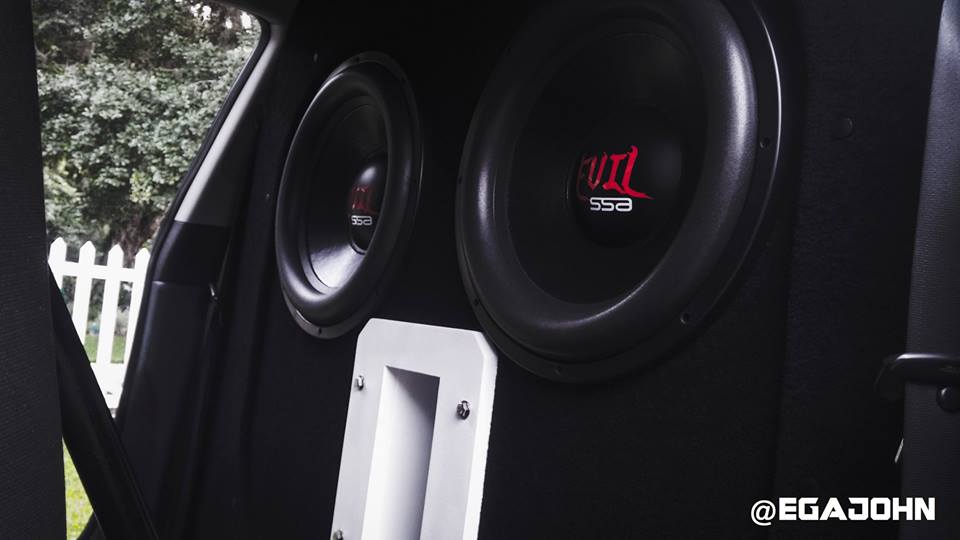

  4. The current box now is 10.13 cf after all displacement the port is 4.5"w x 9.25"h x 9.5"d I know the port is too small. Can you give me specs to make propper port?
  5. 95 Honda Box builders in my area gave recomendations of 1.3cf to 1.6cf per sub for sealed section then 2:1 ratio for ported section of sub. then 12-15ci per cf for port area
  6. I have 2 SSa Evil 15s with 4 Stiff Spiders on 2 Crescendo BC5500s in a Hyundai Accent Hatchback Will this 4th Order Wall Design Work? Sealed chamber 3.25 Cubic Feet After Displacement Ported Chamber 6.25 Cubic Feet After Displacement Port 6"wx14"Hx10.25"D Tuned to 45hz (84 Cubic Inch Port Area) Thank you in advance
  7. I have 2 SSA Evil 15s My box Outside Dimensions is 41W x 31H x 21D / Double Baffled all the way arournd 1.5" Birch My box Inside Dimensions is 38W x 28H x 18D I have 2 Braces 1.5" x 3.5" x 38" and 1.5" x 3.5" x 18" I need help with designing a port. I would like to be tuned to 28hz / As you can see my Port is too Small. I dont want to remake the box i would like to Remove the Port and Fix this Box. Box inside Cubic Feet Empty 11.08 Brace Cubic Feet .17 Both Subs Displacement / 2 x .22each = .44
  8. We made the port so we can interchange it. The box was origonally built for PSI subs. What would you sugest
