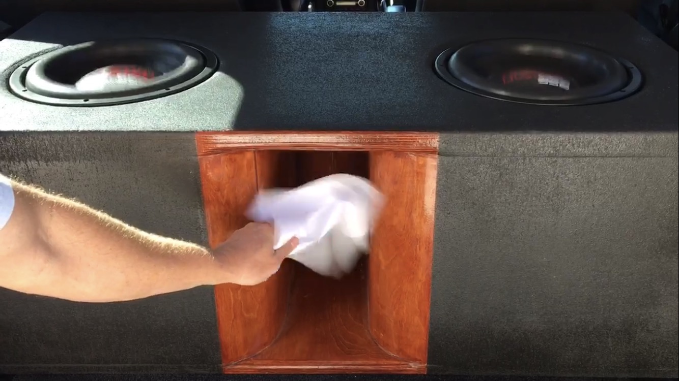

  2. Can someone help me out with some dimensions for a sealed box for 2 Icon 12's? Need 1.25 cu ft. per speaker. Going in an Escalade. Have 46.5" width avail. Currently in a badass ported box I built. Want to try out the sealed enclosure for SQ. Attached a pic of my current box.
  3. Thanks guys. Yes it does have the rough texture. Changed my mind about the piano finish and went with the ruff stuff. Yeah it would look good with some lights. You have any suggestions on those?
  4. Okay pretty much got it finished up. Went with the Rustoleum Restore 10X. About $20 at Home Depot. Did three coats. The stuff is awesome. Also stained port with Minwax traditional cherry then clear coated with Minwax spray polyurethane.

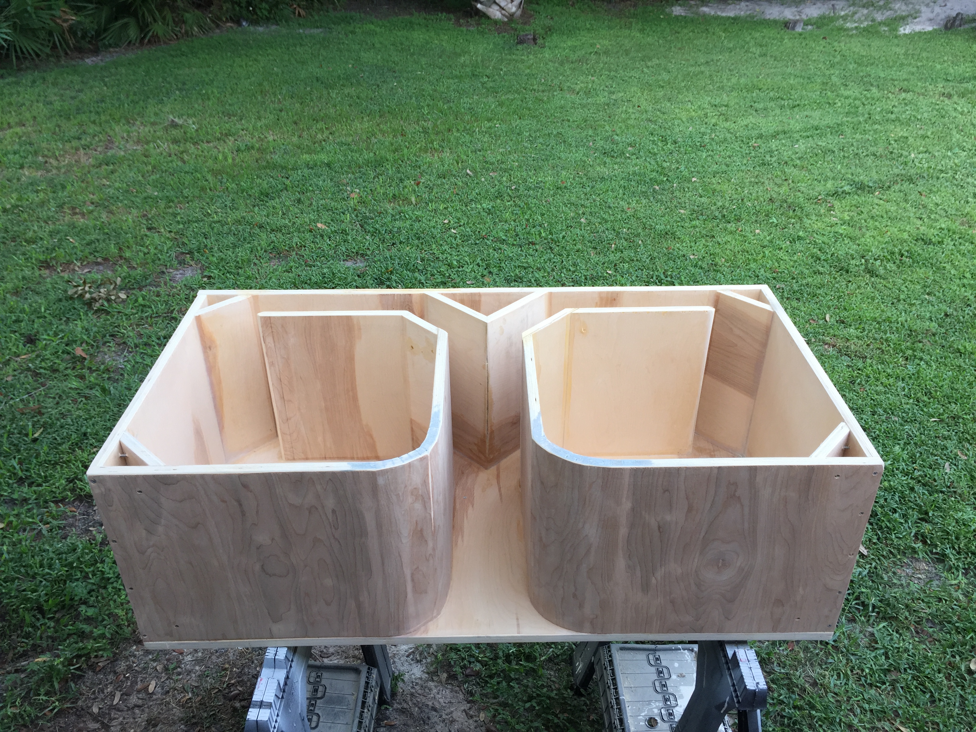

  10. Just finishing up a ported box I did for my Icon 12's. Still have to cut out the woofer holes. They'll be facing up. Anyone have some suggestions on how I should finish it? Stain, paint, carpet? Port painted white? Or stained? Any ideas appreciated.
  11. Do you know what the recommended port area is for the 12" Icons?
  12. Thank you for the design. Appreciate taking the time for that. just a question...why does the port look so huge? Will this fit my goal for loud SQ? Isn't the above design 19 sq in of port per cube? Shouldn't I be around 15-16 sq in of port per cube?
