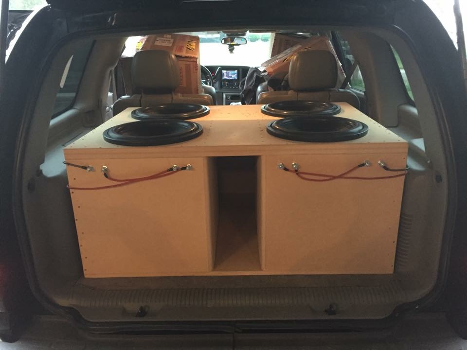

Not a big difference in 26 and 30hz really....raises F3 and F10 about 4hz to 28 and 23 which will likely not even be noticeable inside the cabin. Those 4 15s are tuned at 32 and will play into the 20s easily. I imagine if he really wants to focus on hair tricks we will just work out what frequency and which door/window to hold open and make sure to keep that in mind....tuning at 30 actually gains me about 3db of total output.....32hz tuning doesn't seem like much of a gain and the F3/F10 go up significantly....at least in the 30cu ft box. If I lower the size of the box the curves actually get a lot closer together but the roll off is steeper....this seems like that point of diminishing returns coming into play.....I'll play with both numbers a bit and see if I can find a sweet spot. Thanks M5.....giving me a lot to think about but now I'm getting somewhere other than spinning my tires :-)

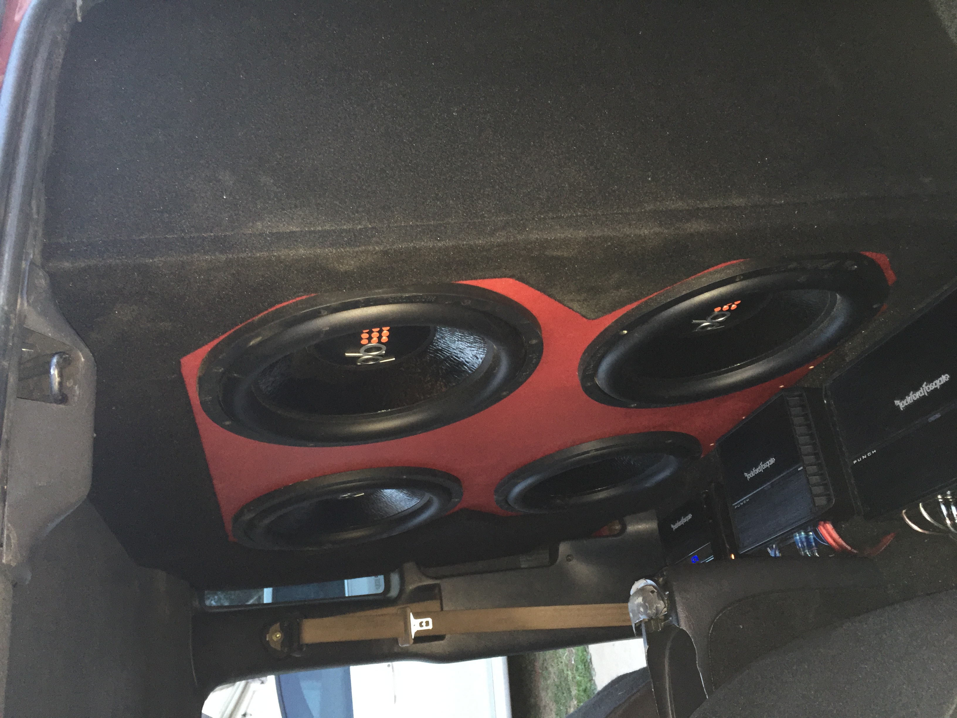

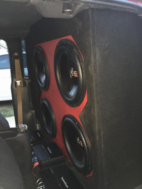

And here is something more like what I hope this install will look like when finished. I like using mirrors....yes we did this one a VERY long time ago lol
