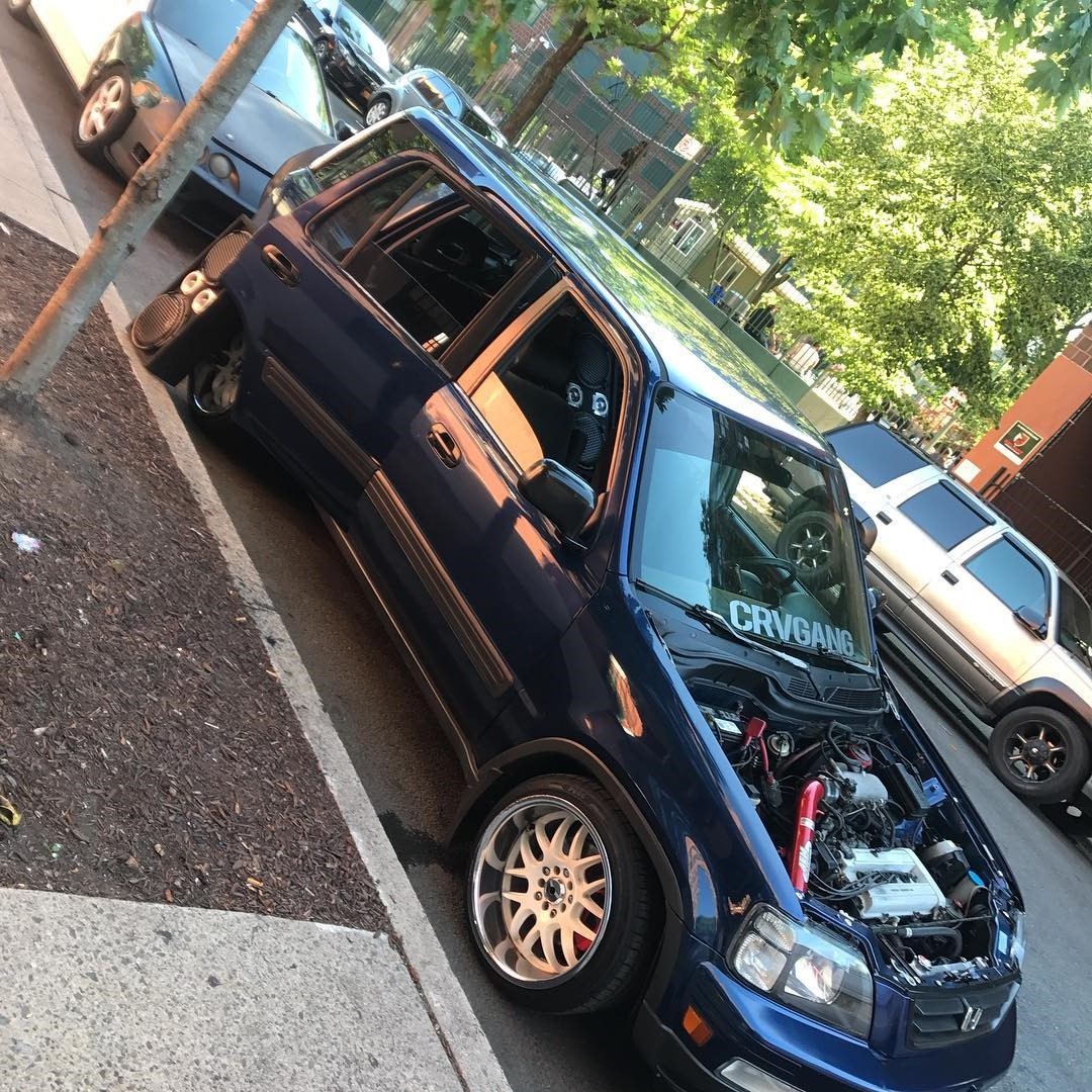

  9. Wouldn't power compression be an issue then?
