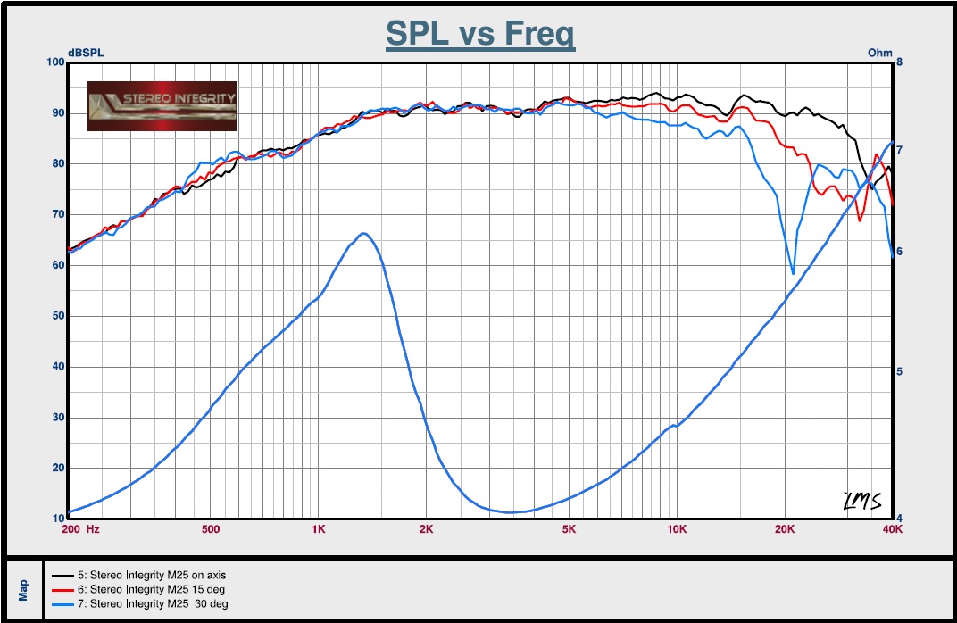

		I'm really digging the SSA Evil Tweeters and 6.5s. One other company I've looked at is the Stereo Integrity M25 Tweeters and TM65 Midbass. Here are the charts for them. Looks like they could be crossed in the 2000-2800 range and perform well, especially on-axis with the tweeters.

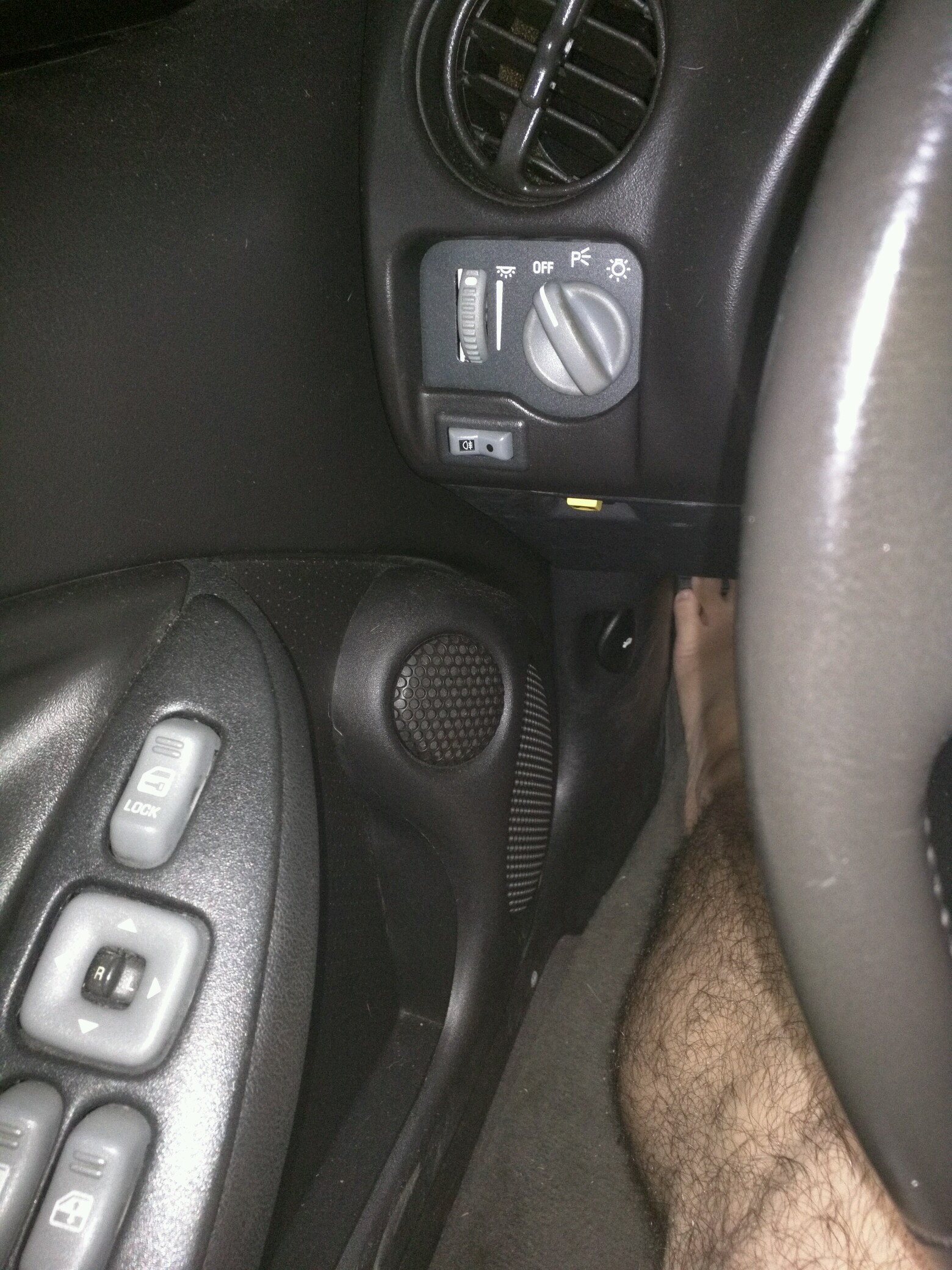

		I think I can angle it for 15.

		That's what I did. It's flat against the speaker grill. The tweeter itself may be angled back a little more. So I think we're safe to assume less than 30 but not 0.

		Okay, did a measurement. It's 5 degrees off-axis on the passenger side and 30 degrees driver side.

		Passenger side is pretty much right on my face. Driver aims in front of me. Off by 25 degrees or so.

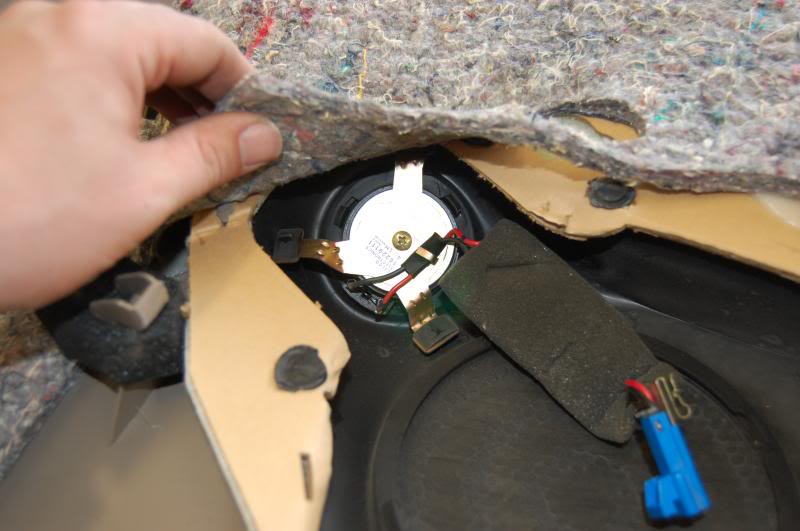

		Door is very deep. I think it's like 4.5" there. And I can run a 7" by modifying the door. It's off axis in that range. They are definitely angled up toward the ears but they are down low in the door, so not ideal. But it does provide more room there.

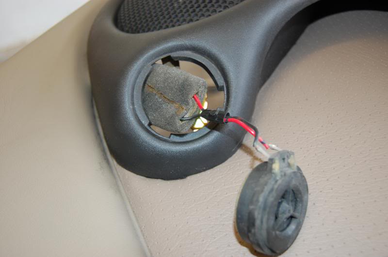

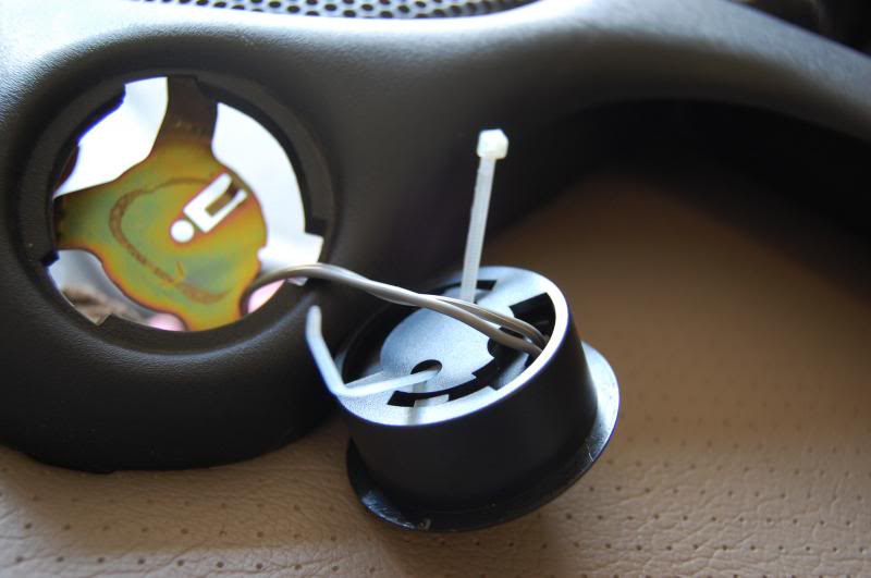

		Both are in the door. Tweeters are angled up. The dimensions for the tweeter are that the door holds a 1.95" diameter tweeter. But everything would be a surface mount there. It has a bracket that I could ziptie or tape the tweeter to. But there's no "mount" so to speak.
