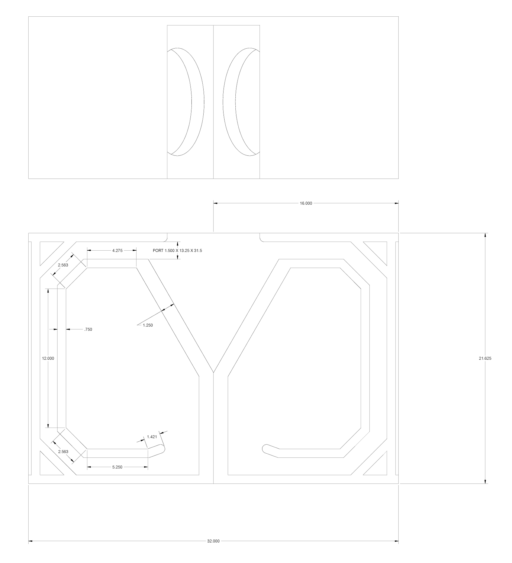

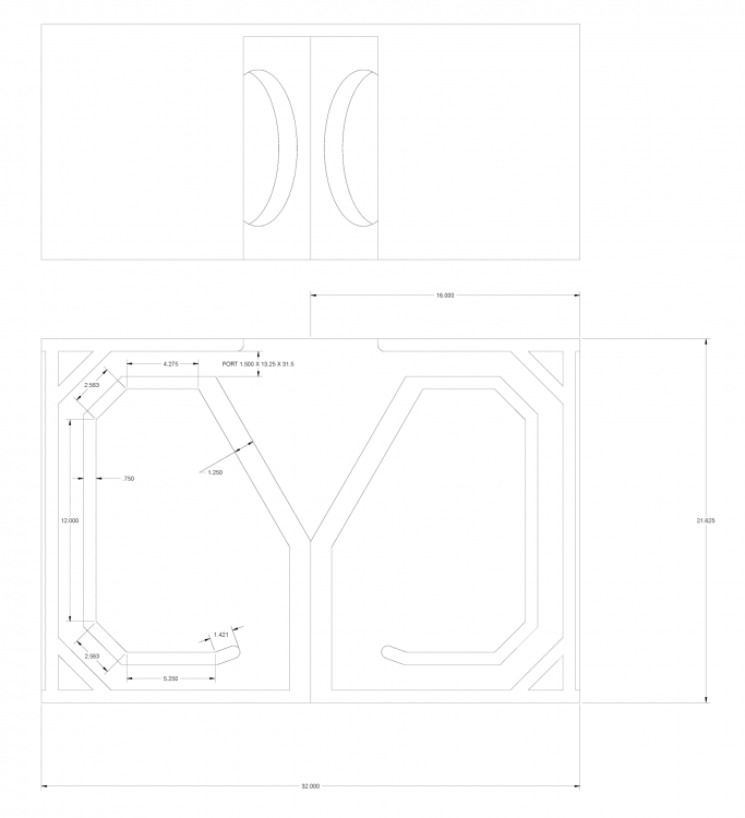

		Actually I was going to do 2 8" subs in the beginning, but was afraid I would not get the bass I waned, so I changed it to 2 10" subs. I have a few different blow through box ideas, but the one above is the one I was leaning towards the most. another had the subs facing the same but the port came out between them. another they were facing each other. You get the Idea.

		Lol! that was my original plan with 2 10" soundqubed hdc3.110. Kind of a band pass blow through. I kind of got talked out of it on another forum. Also got pointed away from the soundqubed and to the ssa icon. I got away from 2 10"s to one 15". Funny it is almost full circle again. That being said I am not going to rule it out. Won't it require more space though?

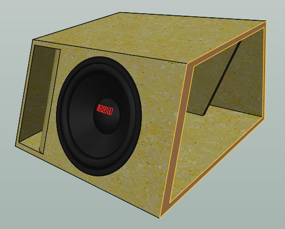

		Here is the updated version of the one shown above. I am still not sure what port length I should be going for. BOX.pdf

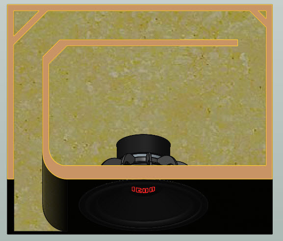

		This Box has a net of 3.2, so I might need to make it a little deeper. Should I also use 45 degree braces in the corners and in the ports? is the 3.2 going to be too small? Thanks Oh and the port inside the box has the same angle as the outside so the top and bottom have the same length.

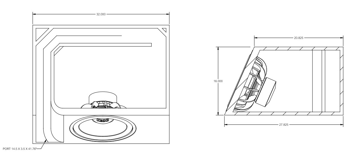

		Ok max height is 16" max width is 33 inches I would like to do a ported 15" ICON. I am trying to figure out my port. I was thinking of tuning at 30HZ. I would have a port height of 14.5 width I was thinking 3.5, but can change that to what is needed. What length port would I need? I am trying to stay close to the 3.5cuft box Would a 3cuft box for or is 3.5 the smallest I should be considering? thanks

		Never mind. I think I am going to just do a sealed box. that won't fit height wise. if I do a 15" it is going to have to be on an angled baffle.

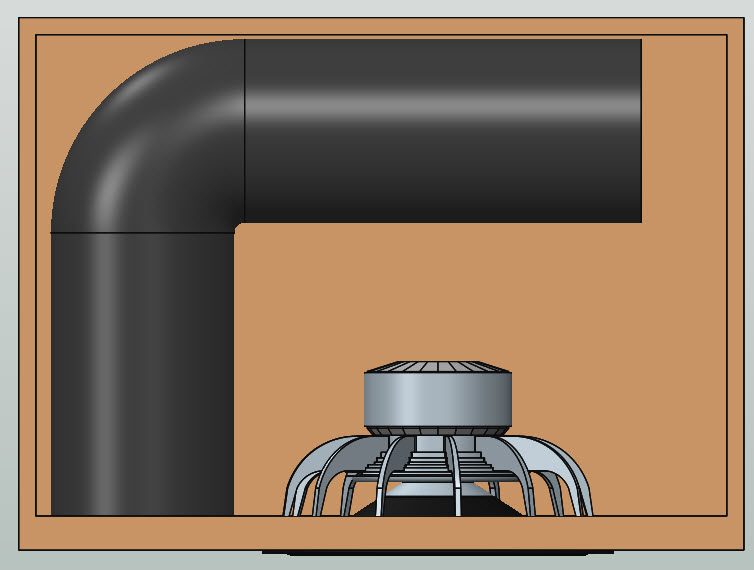

		Ok thanks. I was planning on 2 10"s before so 1 15" is not an issue. Here is a quick mock-up of a box. it has about 3.64 cuft net. That will shrink a little more, as the pvc elbow will be bigger than what is shown here. also this does not have any braces in it yet. just playing with an idea. I think it will fit in the car. I am using an 8" port 40" long.
