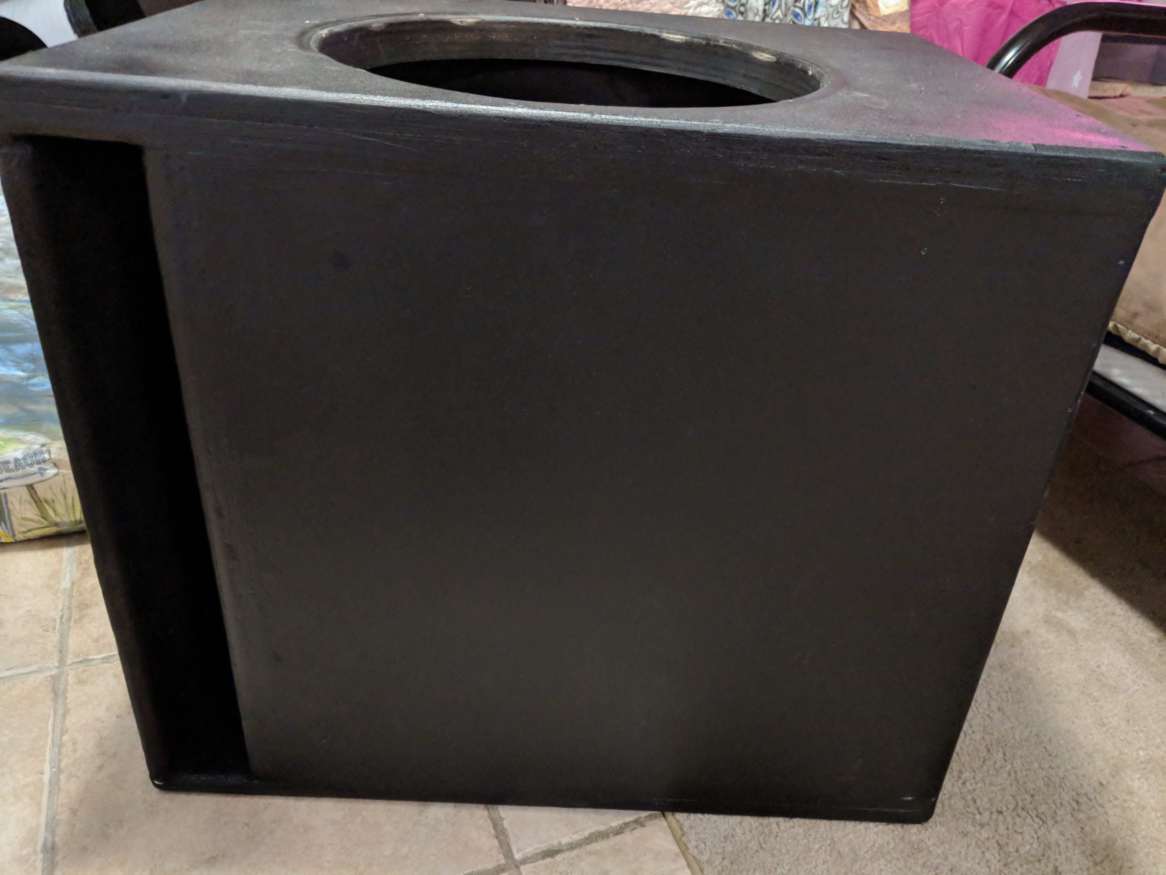

		Any suggestions I have 2 box one black slot port specs are: 3.6 net after displacement tuned to 32-33 hz 2.5" port width 48 square inch of port area, both box are the same size 20d x 26w x 21h, and the aero box specs are: 4.5 net after displacement tuned to 32-33hz, 3 4" aero port 38 square inch of port area, wanted to put a sp4 v2 15 which would you guys prefer to used, I'll do a dual 12 or 15 on my other upcoming car but for now is single 15"

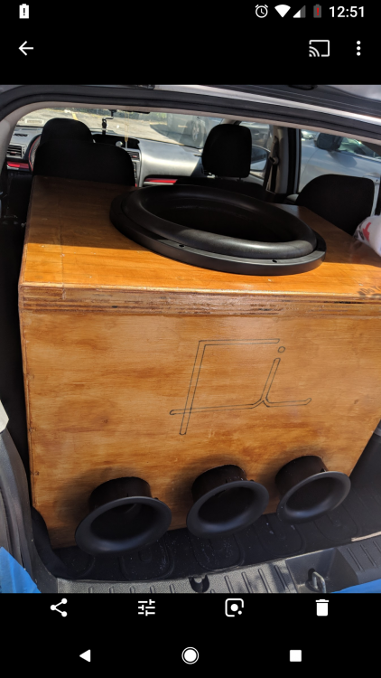

		Can you do bend 90° in aero is it as efficient as let say a straight aero port or will it also degrade the sound quality output
		Going from sundown zv5 to find btl neo
		Wow that's alot of port length and if I do like 8" it's like 18-20" my thing is I want to do sub back port back hatchback m soon might be a SUV n tnks man for the reply

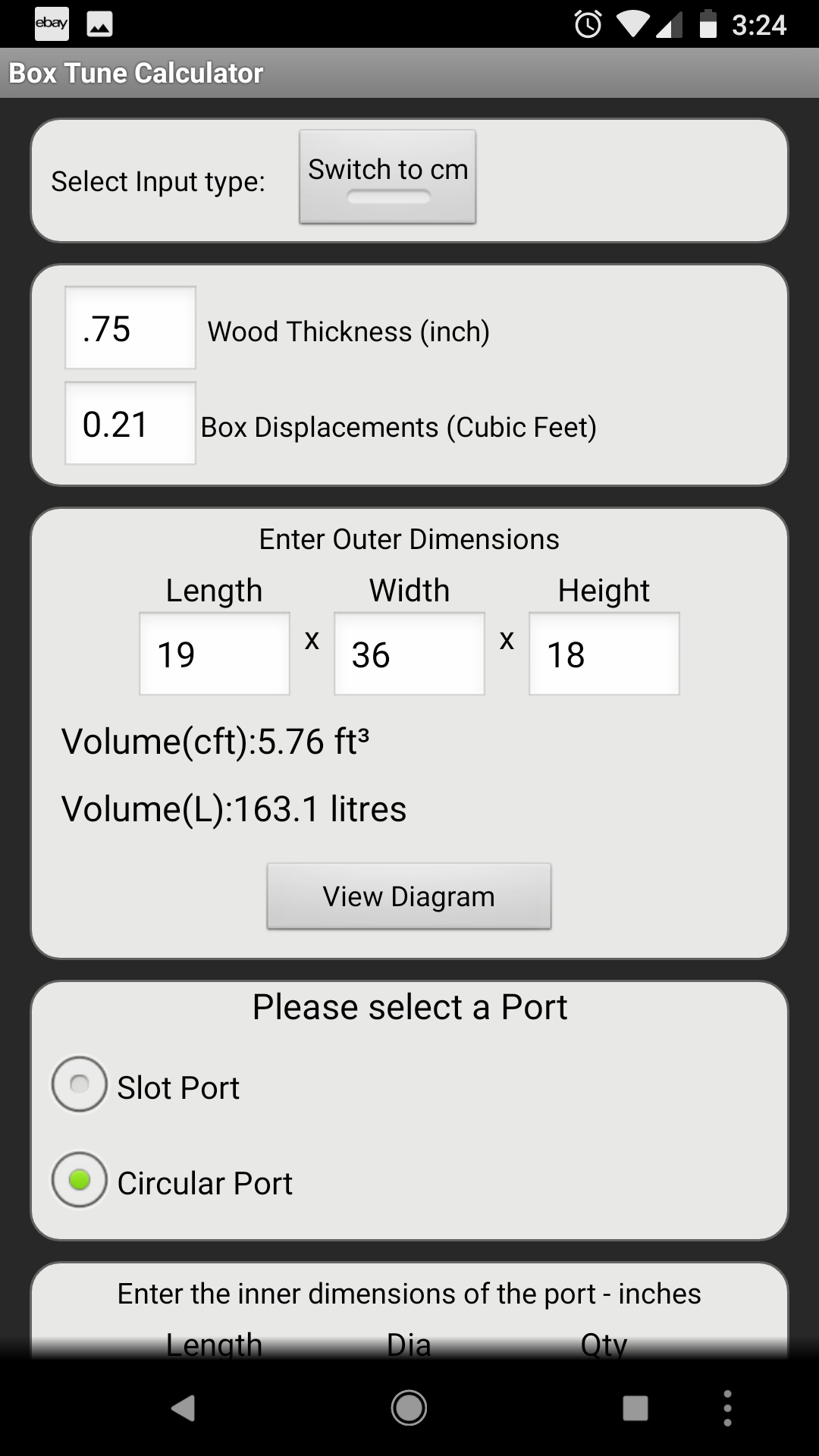

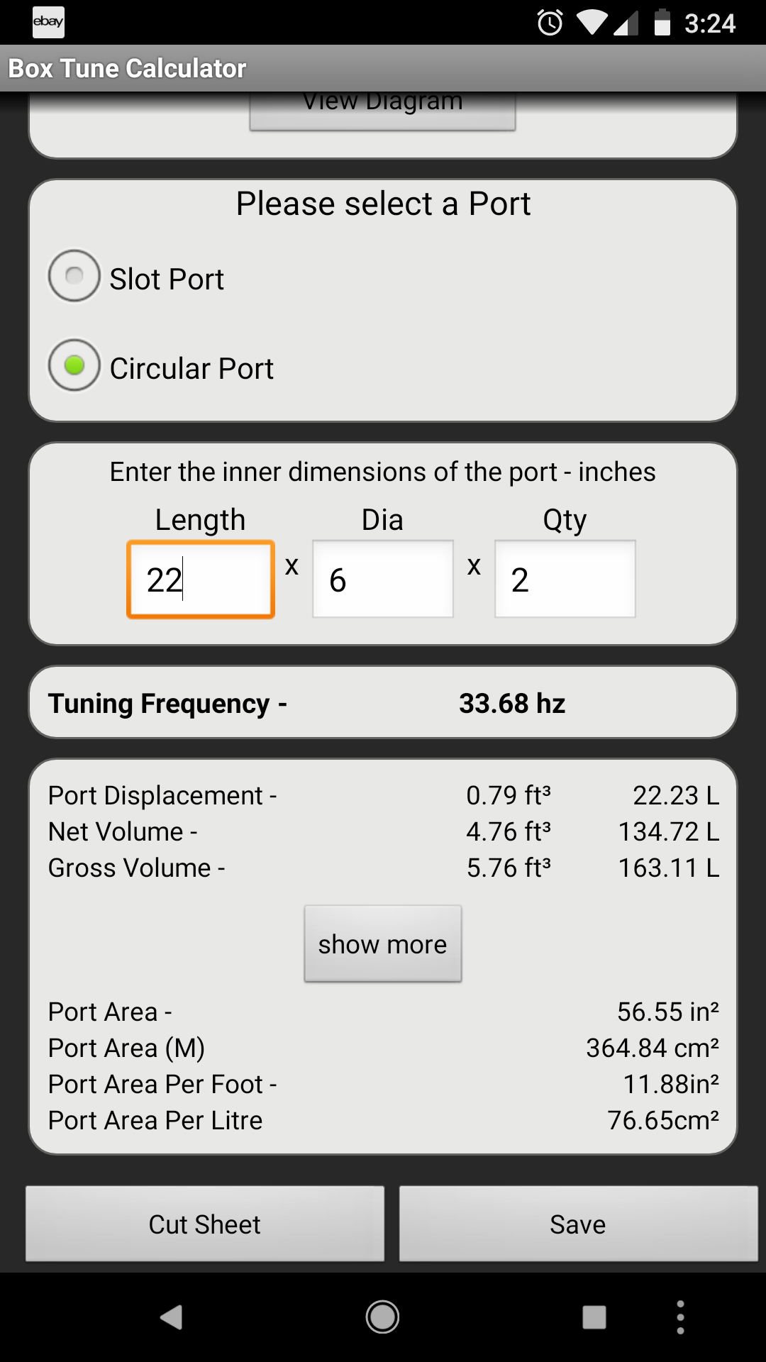

		Ok think going to need some advice here so going to build a box on my own using the spec below for the fi btl 15 neo but I'm little confused on the spec in inserted in the Android app(box tuner calculator) is the length which is 22" dual 6" port, so when I'm ready to get the port do I meet 2 6" port 10" length each or is it 2 6" port 22" each also my other car I'm really thinking about a ssa evil too much ppl I've read all over have good story about them so will be trying one I'm the near future ps I know I type extremely had for other to read lol I myself sometimes don't understand lol n tnks for the love Aaron
