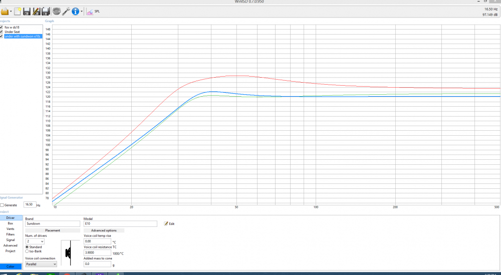

  5. Here i added the Sundown EV3s in blue

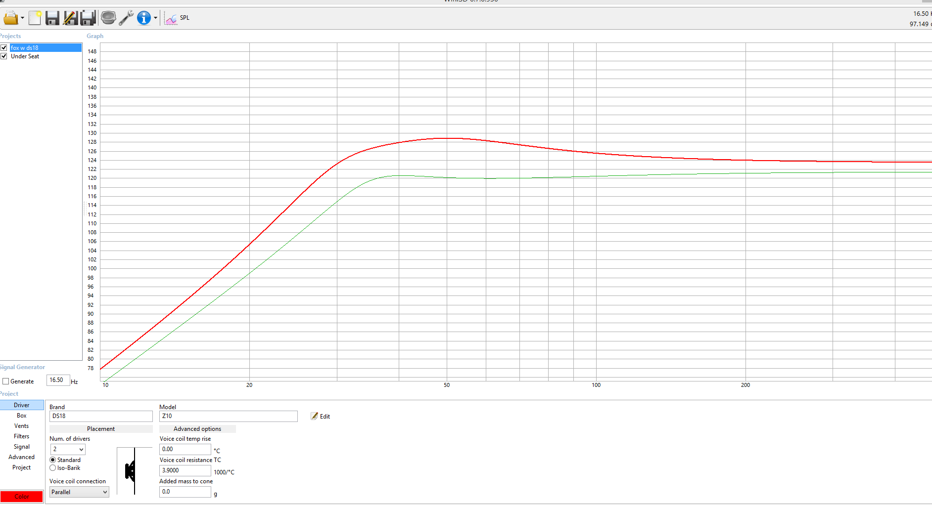

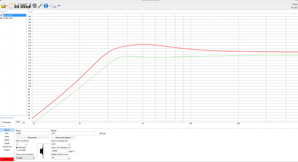

  6. I appreciate the input! and that is why I'm here asking questions. I know most of the sound is in the box but a custom box and seat lift together is over 500$ if i remember correctly and I don't have that sort of throw around money. This is the second box I have owned for this application and right now I'm just trying to get as much out of it as possible until i graduate and start making enough money to throw at this. As i said, I've got my gain set to be bout 1400-1500w rms instead of the correct 2k rms, i would like to get all of the power from my overall system even if the gain is small, a gain is a gain. From using WinISD after watching a video on how to do it, and the DS18 brand woofers on 2k rms had an insane 8 db gain across the curve. Red is the DS18 and green is current. Ive helped a friend install some lower model DS18s in his ride and they were super responsive and loud for only 1200w rms on 2 10s. And I see people bash Skar all the time but i personally have not had any sort of problem with their woofers besides resale value is crap.
