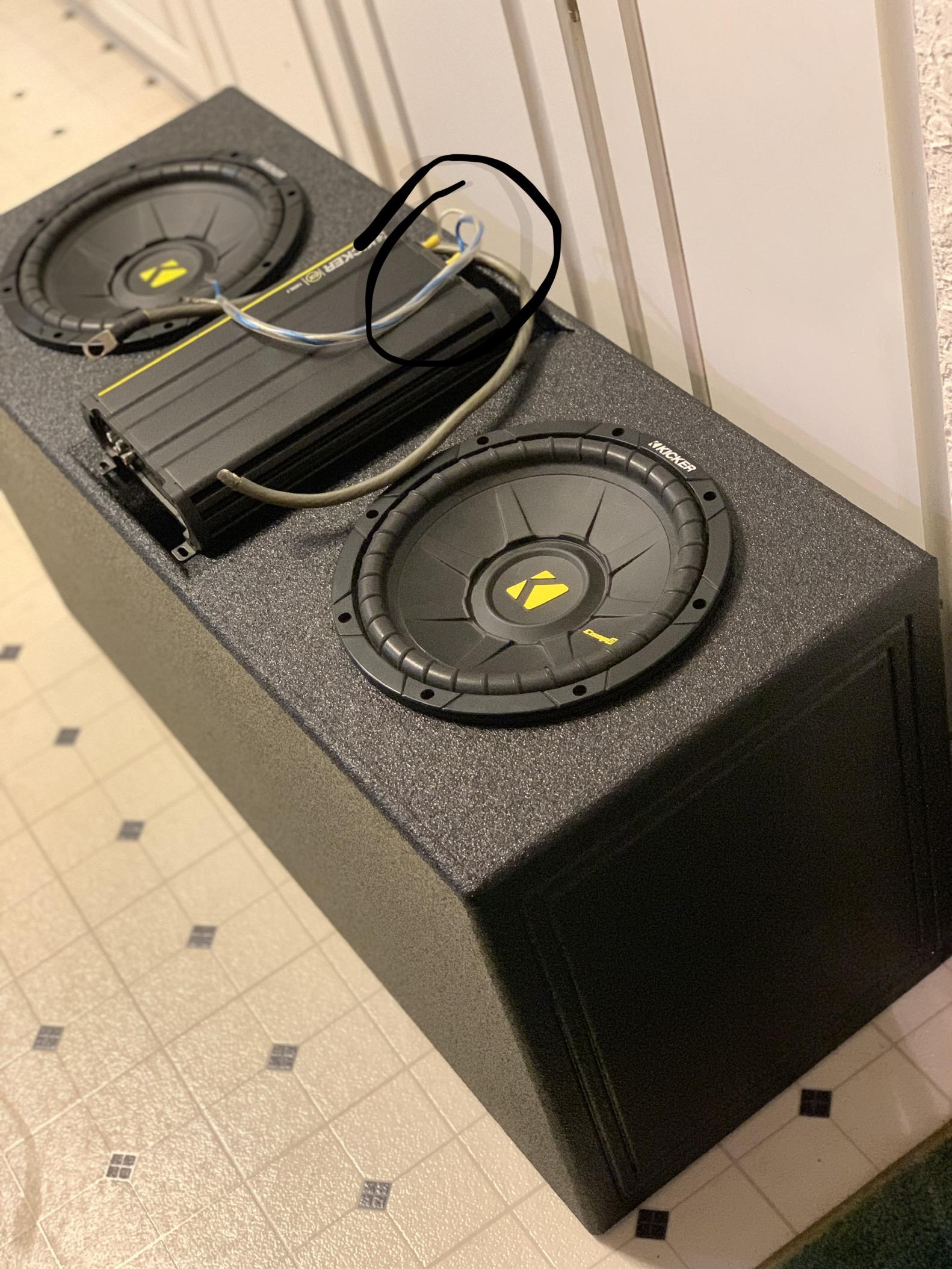

		I know the amp can hold 1 ohm and the enclosure is 2.0 cubic feet per sub and is capable of 30hz

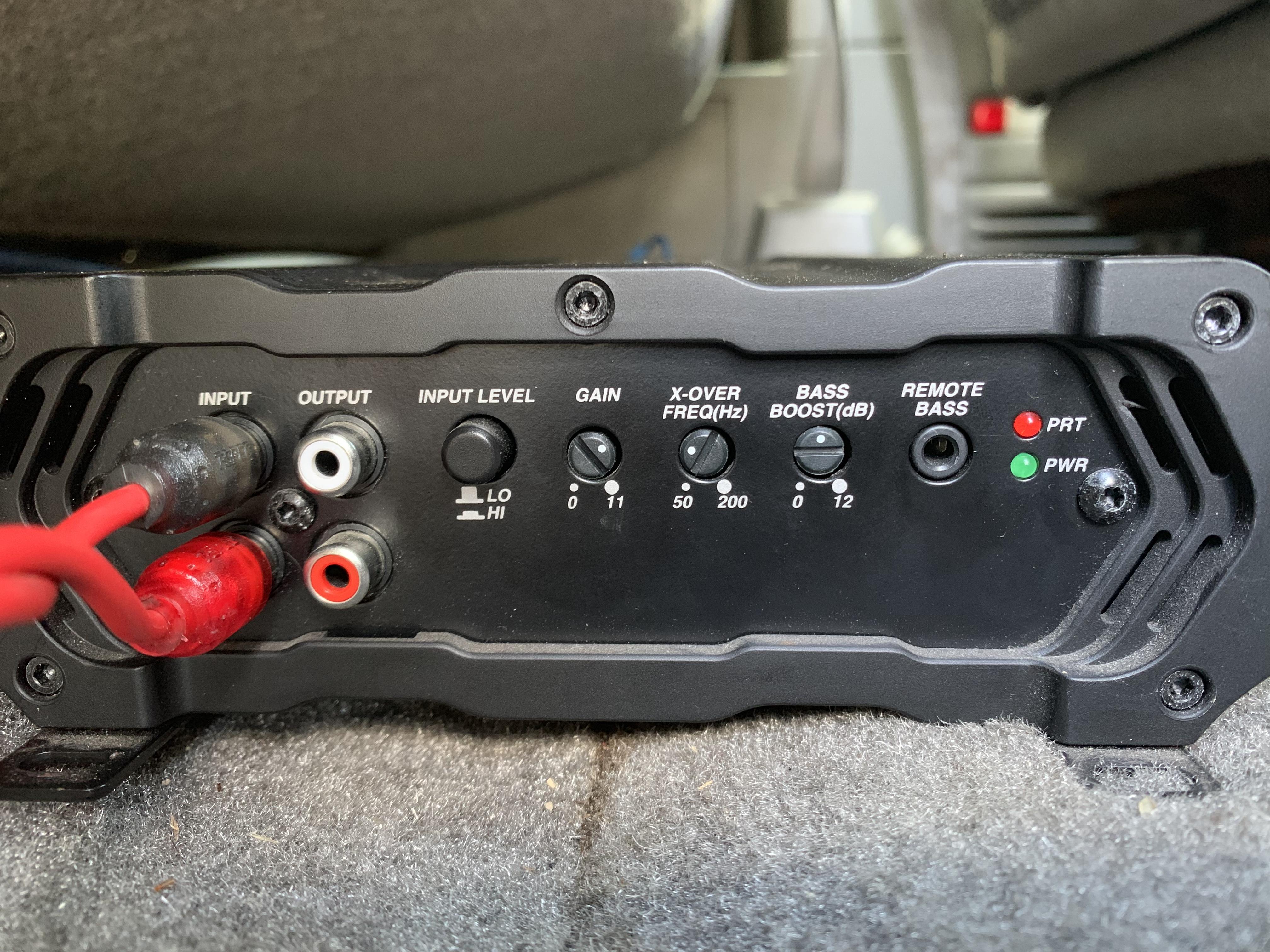

		So I need to turn my bass boat down ??? I am not familiar on amps and I don’t want to drive 30 min again for them to “Tune” it so I’m trying to fix it all myself

		The wire did turn a darker color and seemed to heat my amp up more.. do you have any suggestions on what I should do?? Should I tune my amp on a 50hz pull with a dmm ??

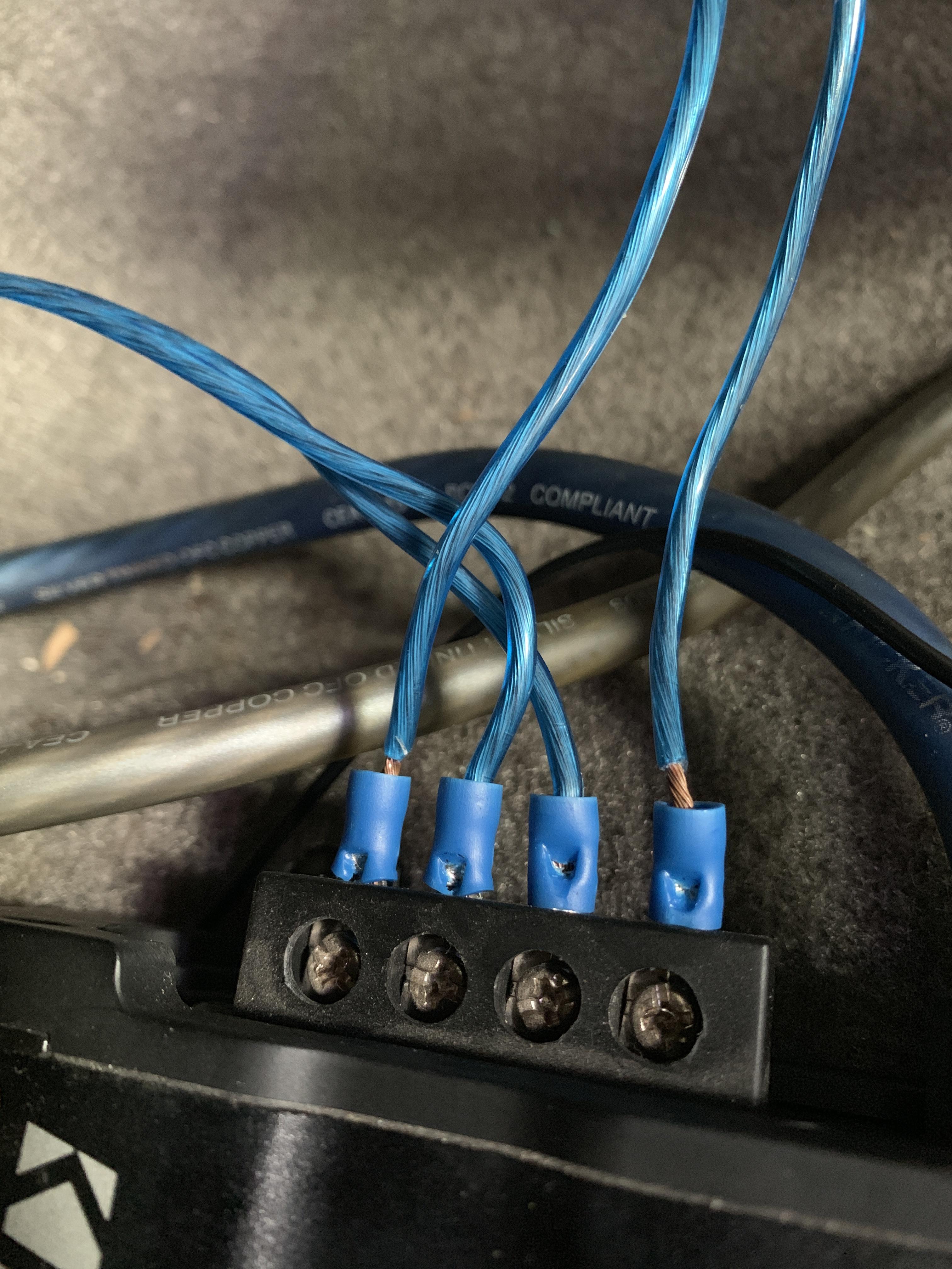

		So what do I do to make them not smell ? The only thing that I switched from running not ported to ported was the wiring from amp to box... the non ported box only used one set of +- on amp but the ported is running both +-. Btw I was running 14 AWG on non ported and 18 gauge on this one but Tuesday it will be on 12AWG PICTURE BELOW

		The only reason I was listing peak wattage is because I only smell it at high power and they are ran to separate spring terminals so I smell it at peak . But hopefully, this new 12 AWG wire will do the trick... I've ordered it along with Rockford front door speakers and kicker rear... Schedule delivery is next Tuesday so ill let yall know next week if that fixed my problem or not.

		I just talked to Crutchfield and they think they know what the problem is and come to think about it that makes more sense... I am currently running 18 gauge from sub to box and they said for that watt im pushing out that I should be running minimum 12 gauge...

		Thanks for your response! The subs still look in perfect condition and still perform as they should! The subs are rated for 1.2 - 1.8 cubic feet of air space but crutch field said 2.0 cubic feet would work just fine. Peak watts are 600 per sub and 300 RMS per sub. I've taken the subs out and checked everything and they still look brand new and they don't make a crunchy noise when you push on the cone... The guys at the audio store told me that it should be fine but I don't want to mess it up.

		This is what its currently tuned at... But if you need I can send you the picture of what it was previously tuned at also.
