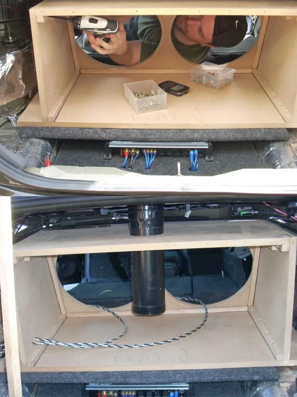

  6. You're referring to a build something like this?

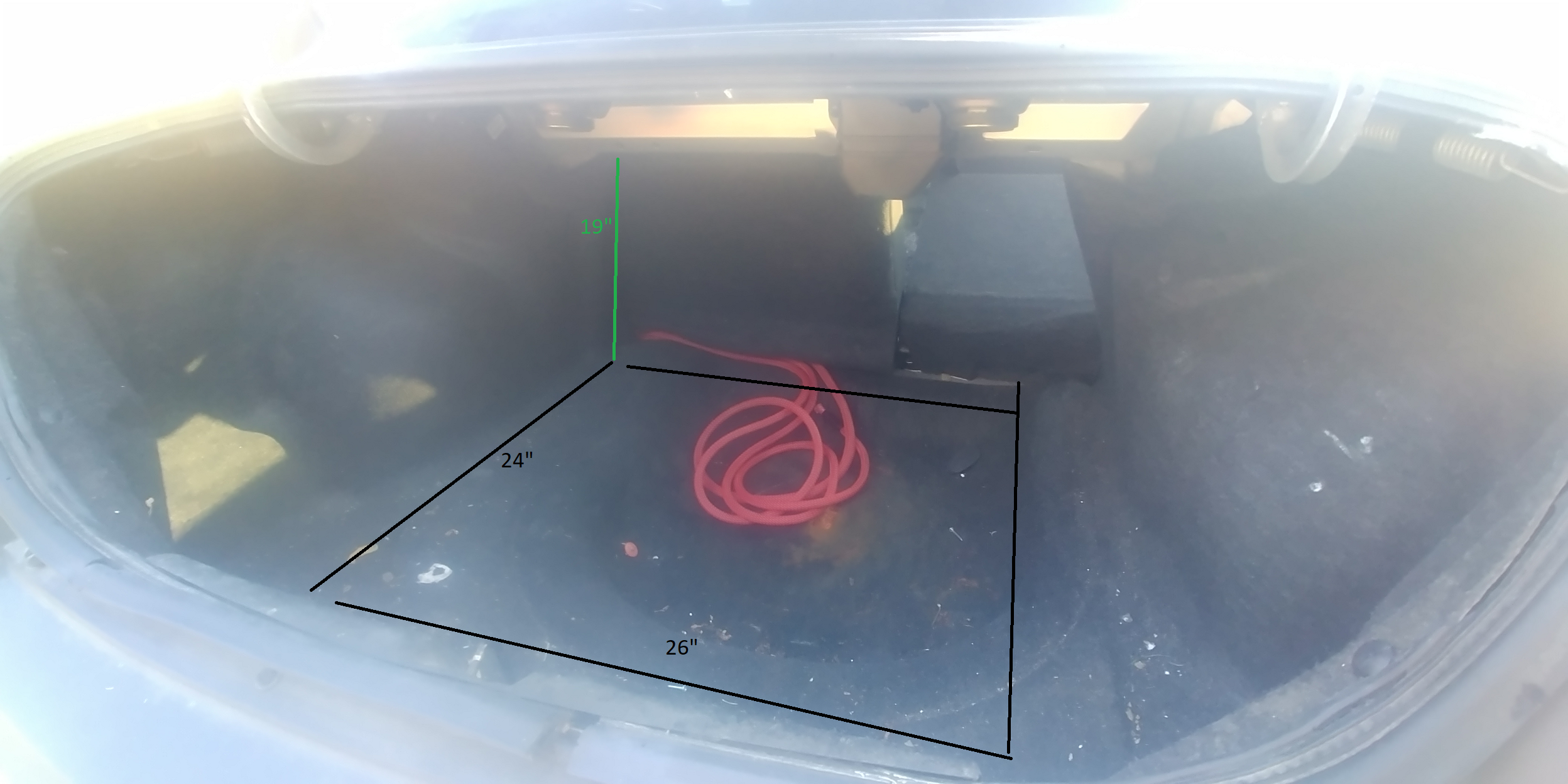

  7. Maybe even a downfiring sub into empty spare tire well could be option. The tire well is 24" x 24" x 6".

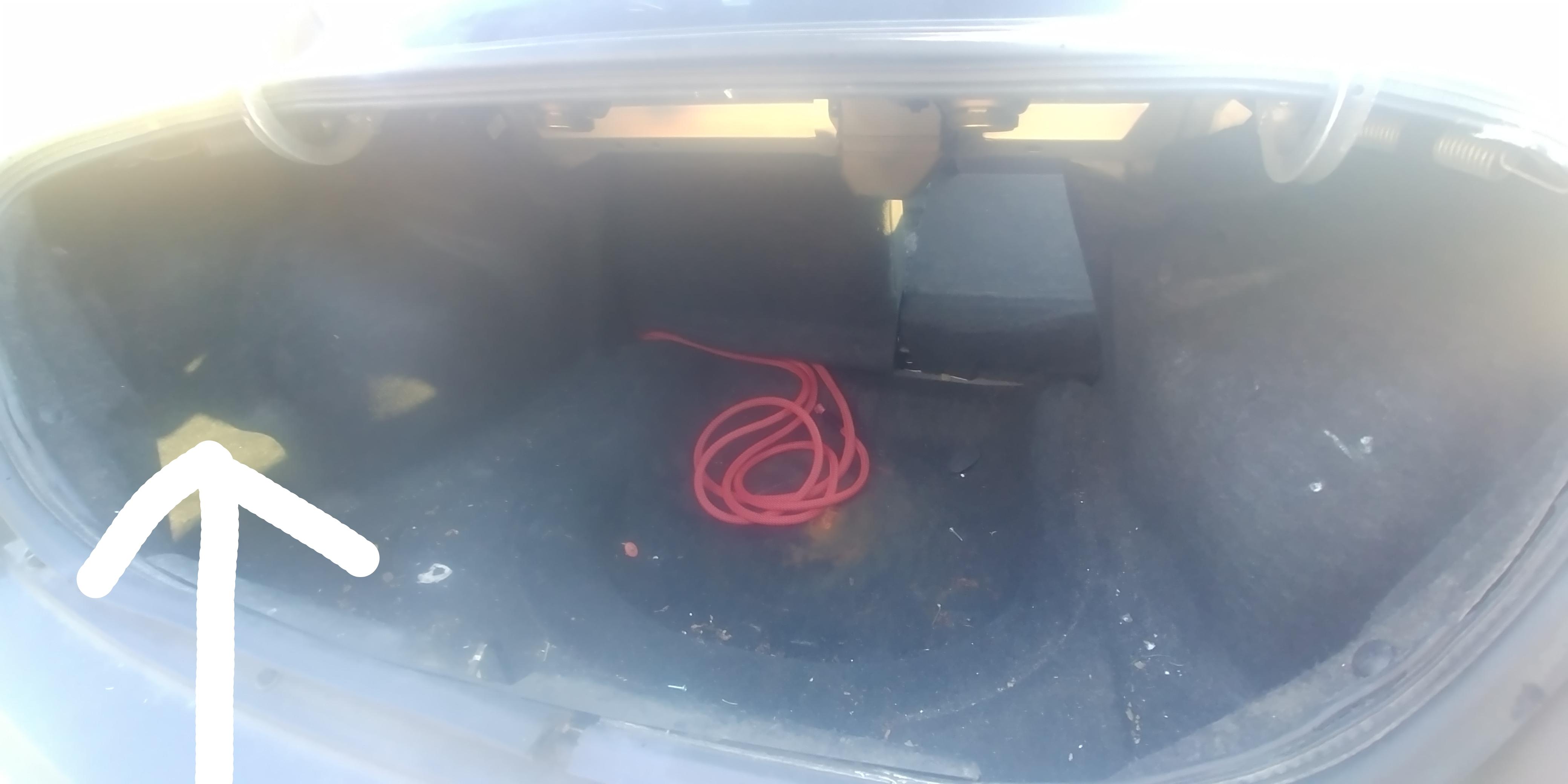

  11. If i went with a standard ported enclosure, im having trouble figuring what the optimal sub/port orientation would be in my trunk. Ive seen some convincing writeups that lead me to believe that a ported box is going to have the best performance when in rear of trunk facing the rear. However, it seems like the sub should have at least 6 inches of air space between rear of trunk. So, i lose some potential air space by having the box off the rear like that. With a series 6th i could build to max dimensions of trunk and blow through rear deck. Id have to use a smaller sub, but that was the thinking anyway. Im open to going the standard port route, i just could use some guidance when planning the orientation and position of sub/port in box. Heres a pic of my trunk. Was wondering about the idea of building my box all the way to rear of trunk and have sub facing the side to fire into corner of that recess area in corner of trunk, where i drew the arrow. This could let me build a little bigger box this way... But im not sure where the port should face with that idea. I dont want the port facing the rear do i? It would be right up against the rear wall of trunk.
