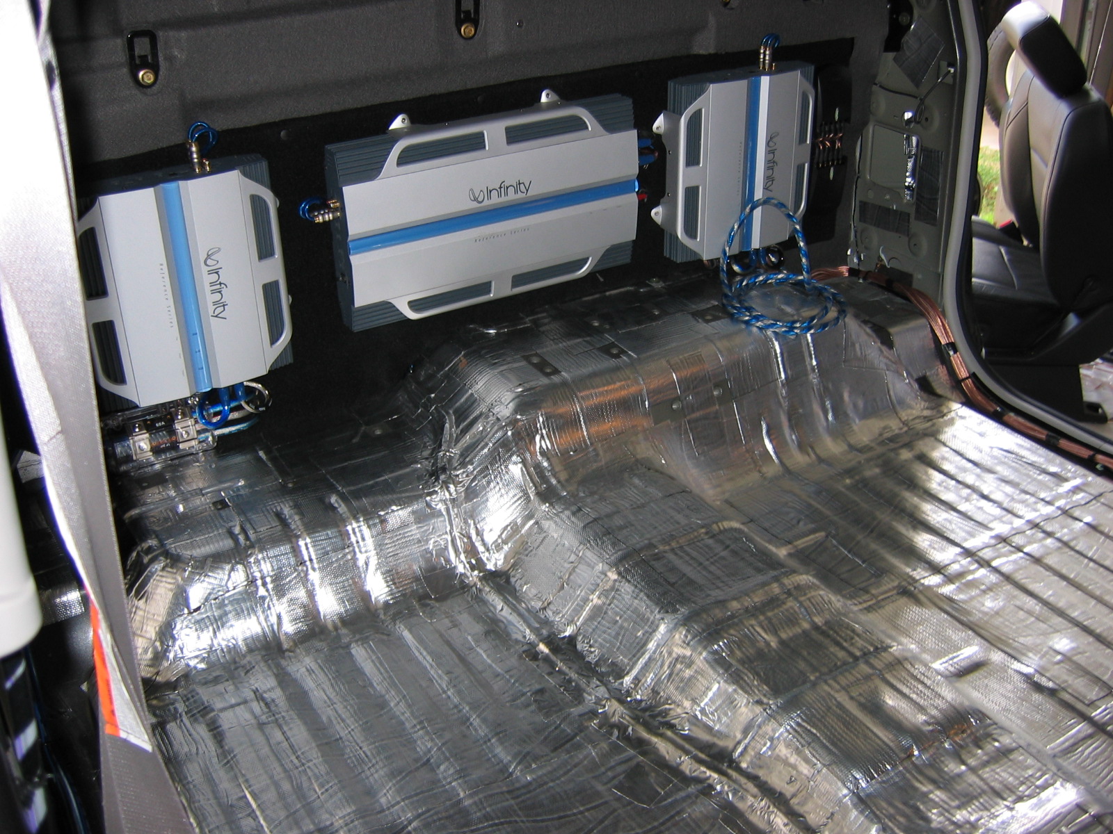

  20. Thanks for the replies guys. 60ndown, sorry but there's no way I could squeeze an RL-p 12 in there, it has a mounting depth of 6.91", even bigger than my Infinity VQ's. mrray13, you're saying that 850w at 4ohm should be enough for two of those RL-i10's, so around 425w per sub? I just want to make sure, as my last sub was powered of a bridged 2-channel sub, and I'm not all that familiar with mono sub amps. Another question yall might be able to help me with. The Infinity 1210A is a mono sub amp, but it has two sets of speaker outputs. The manual is kinda crappy and just states if you are using one sub to wire it to the left output, which is how I wired my amp rack. The manual doesn't go into how wiring should be setup with multiple subs, especially ones with DVC and how to wire them for a desired load. I'm guessing I'd wire them like is show here in wiring option #2, and continue to have them wired to only the left set of speaker outputs? Another option would be to go with the RL-i8 and have two forward firing, which is what I had done with my Rockford Fosgate 8"s. But it seems like it'd be better to go with the 10's as long as I can manage enough space underneath and above them under the seats. What do you think? Thanks again, Sammy Here's a pic of my amp rack:

  22. Hey guys, glad I found this place. I'm finishing up an install in my Nissan Titan and I've run into a wall. I've got all the comps, amps, HU, changer, everything except for my subs installed. Problem is my mounting depth restrictions. I have already gone through two RF 8"s (didn't like the sound), a cheap Infinity 10" (not enough) and now I have two Infinity 10VQ's sitting in my living room because their 6.5" mounting depth is going to be nearly impossible to squeeze under the rear seat and still manage enough air space. So I was recommended the SS RL-i 10" by a friend. Its mounting depth should work fine, but I wanted to ask you guys if it will suit my needs. I'm not into HUGE spl, but I want a good mix of SQ and bass when I want it. The amp I have for driving the subs is an Infinity 1210A, which according to their specs puts out 854w rms at 4 ohm and 1300w rms at 2 ohm. Judging by the last two boxes I made, I figure I can fit around .75 cu ft per sub in a sealed enclosure. I've never made a ported box, and not sure where to start. So what do yall suggest? Would these RL's be a good choice for my application, what kind of impedence/coil/wiring, and what kind of enclosure should I go with? Thanks in advance, Sammy
