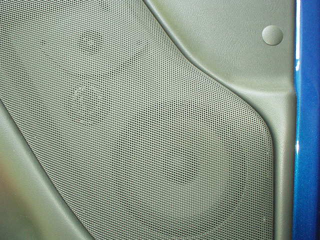

the focal's in the doors.....
u can still see teh factory tweeter on top...had to drill a hole to mount the focal..ain't nothing like drilling a hole in a brand new truck..hehe

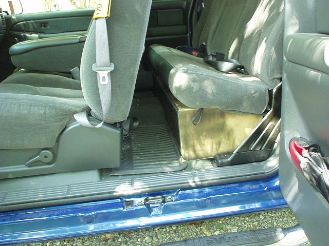

as u walk up on the driver's side...
did ya know there is more room under the driver's side, like 2", to the hump in the floor?

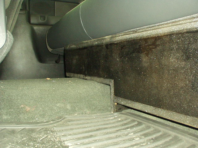

here, u see the box as it runs along the floor.....
there is a 1 1/4" from the baffle to the floor...and a hidden surprise..hhehe

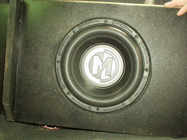

the sub...yep, yep..
the surprise? it's recessed...so it get's the full 1 1/4" for excursion(like the pr will need that!!)

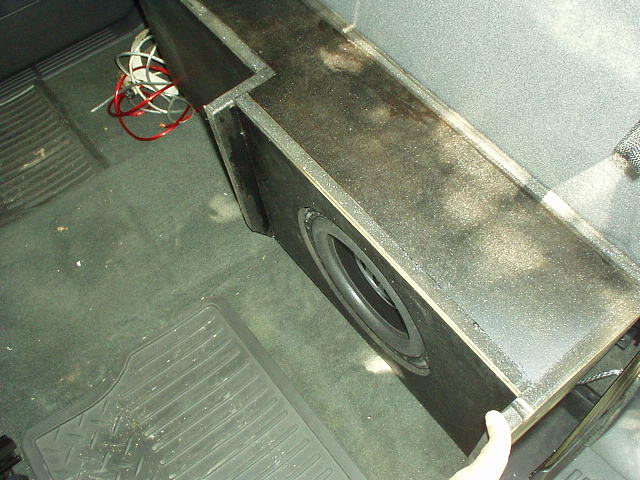

here's a better pic of hos the sub is recessed..

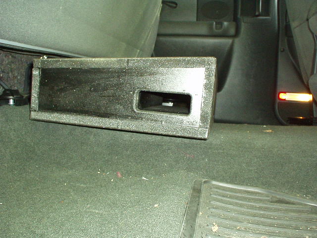

the port....a whooping 6in^2 of it...lol..it's 11.25" long, tuning in the 37hz range i guess.....
yep, the paint has metal flake in it..it's the left over from the grand prix box...i ran outa regular black..
so whatcha think?? more pics soon!!
