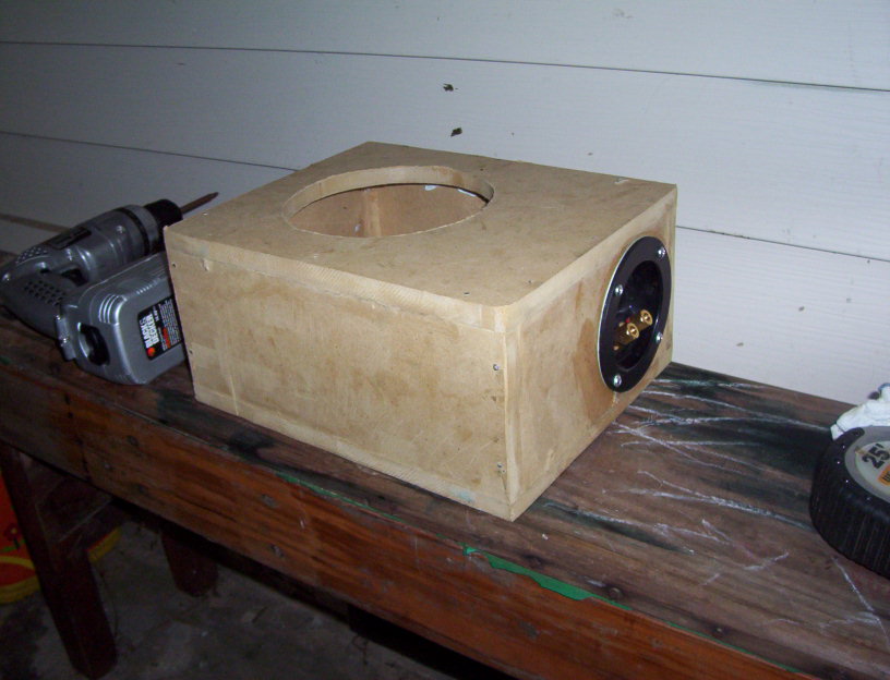

October 31, 200421 yr Author Here is a pic of yesterdays project for me. .2 cubes sealed and will fit under the drivers seat of my wife's Voyager. Right now it is cut out for my Vifa PL 7 but I have a feeling it will end up a Koda in no time. But I thought I would give the Vifa achance first:)Another box tip. While 2 people is not necessary it sure is nice.Also, if no have no sawhorses an old sub box works just fine.
