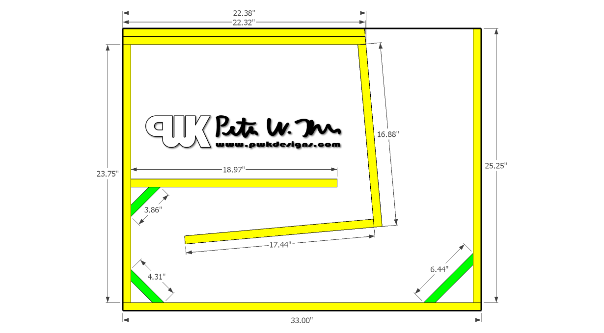

that is a picture of the design. it's built to exact spec
Do we have to guess volumes and tuning ? Maybe somebody had some experience with 9917's and can figure out if the volume is ok for the power you have...but without some more info nobody can figure out exactly what happened.
I remember reading about someone mechanically damaging an AQ HDC315 in one of Pete's designs. Too much volume for the power he had.
You could take some pics of the subs after the damage, maybe that could give some clues.
I am not sure of the tuning.. the box is 11.42 cubes though.

http://img.photobucket.com/albums/v248/Owners1/box-1.png

how wide is one of the boxes ?

Looks like the re-cone was done poorly and the person that did the re-cone did not shim the coil in the gap properly. Causing the coils to rub against the pole. DD should take care of you .... For a price. PWK works closely with DD so I am sure his design would work with that series.
