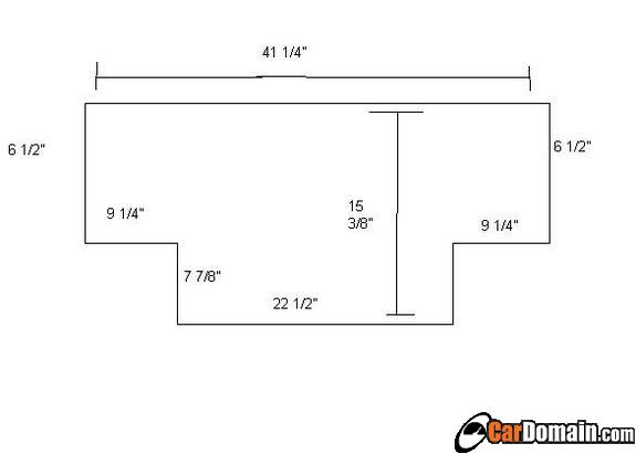

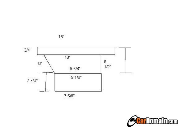

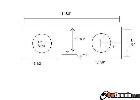

July 13, 200520 yr Author http://thirdgen.org/techbb2/showthread.php...threadid=306257here are the plans from a third gen website to build a box for the well. i tried for hours, but couldnt figure out how many cubic ft. this would yield me. could someone please take a look at this and tell me if it will give me enough for my rl-p's? thanks a lot, Shaun
July 13, 200520 yr http://thirdgen.org/techbb2/showthread.php...threadid=306257here are the plans from a third gen website to build a box for the well. i tried for hours, but couldnt figure out how many cubic ft. this would yield me. could someone please take a look at this and tell me if it will give me enough for my rl-p's? thanks a lot, Shaun<{POST_SNAPBACK}>Plenty for the RL-PMy figures came up with roughly 2.28 before you add in the 8" slant. Your probly looking at 2.4 total. so 1.2 per sub, wich is plenty for the RL-P-Justin
