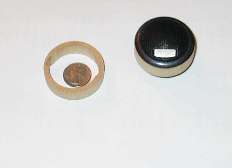

Here are shots of the tweeter baffle and the insert that I made to hold a laser pointer for aiming the tweeters. Currently they are aimed at the opposing headrest like the originals. I will play with their position after I have a chance to break them in and listen to them a bit.

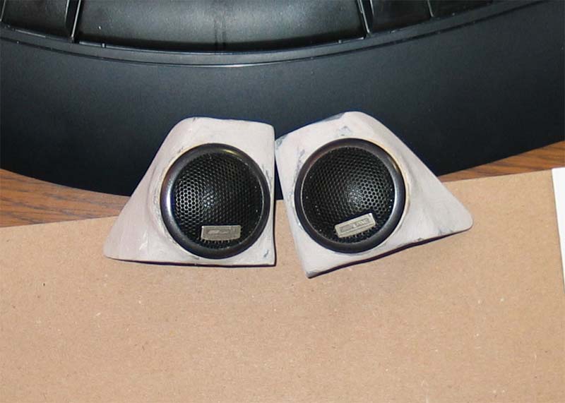

Tweeter pods here, only need one more touch up with the bondo/sanding routine and then I am covering them in vinyl. Now I am just waiting for my crossover to arrive--perhaps an amp rack since I am adding two more components as well but we shall see.
Stock sail panel locations--highly modified to fit though. If it sounds like bunk because of the separation, I will remount them in the kicks with such a small format tweet they go down there pretty easy, especially with the angle pad mounts I can modify from an old set of Infinities.
I am waiting for a little bodyworkpatch on the tweets to dry before I paint them. Going to try and make them flat black first and see how that looks as I have the paint.

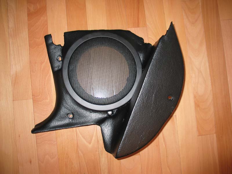

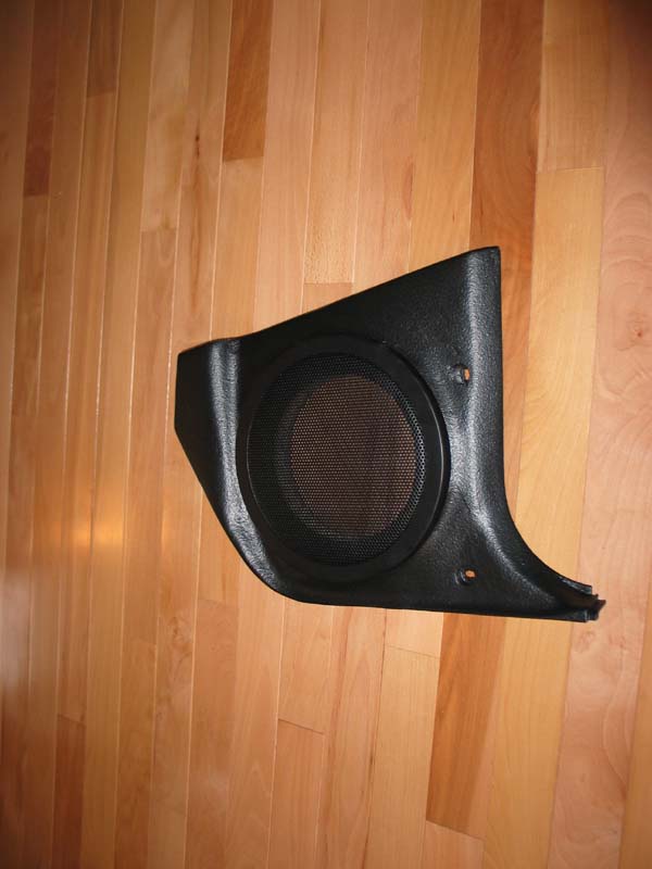

Here are the kicks ready to be installed. The portion of the drivers side on the top left will be covered by the hood release and the other top is actually under the level of the underdash covering so I wasn't too anal about making it nice since you won't see it and I don't have lots of patience. The other bummer is in order to use the grills that I found I have to put screws all the way through on the driver side since I didn't lower the dead pedal enough to not be in the way, I was originally planning on using 7" grills but couldn't find any. I had to recess it into the pedal. Here are pics.
You couldve glued them in place.
I wish, then the "relief" cut in the dead pedal would have to be 2x the size of the grill instead of just the size. I'll use black screws and they will be by my feet anyway. If I find 7" grills later the problem will be solved. Those were only like $5 ea from Madisound.

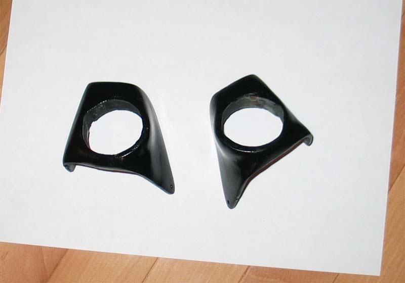

Tweeter pod picks. And yea, I probably should have painted these flat but it is what I had...couple little spots too, but will install tomorrow and see how she looks. I am sure the picture would be better with drivers, but I don't want to mung the paint while it is still so soft.
