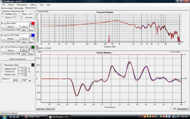

Took you up on your sarcastic suggestion and performed some "real world tests".
Measurement system consisted of my laptop connected to an M-audio Mobile Pre using a Dayton EMM-6 mic. This was connected to my HT receiver driving a Coustic 306P 7" mid. So this includes the entire signal chain, from source to amplifier to speaker reproduction. I used HOLMImpulse to perform the measurements.
The short cables consisted of a 3' Dayton RCA cable and 3.5' length of Stinger 14ga speaker wire.
The long cables consisted of a 17' Stinger RCA cable and 10.5' length of Stinger 14ga speaker wire.
The first (red) measurement was with the short RCA cable & short speaker wire.
The second (blue) measurement was with the long RCA cable and short speaker wire.
The third (green) measurement was with the long RCA cable and long speaker wire.
As you can see from the graph, the measurements at the initial impulse for all three measurements pretty well overlay each other. Within the resolution of the measurement (tenths of a millisecond), they are for all intents and purposes identical. If there were going to be significant differences due to cable length, it would be revealed here in the impulse measurement as the "slow" signal cable transfer would have an initial impulse later in time.
The results indicate rather definitively that there is not going to be any real world difference in the performance of the system due to any realistic differences in speaker wire (7' difference) or RCA cable (14' difference) lengths within a typical car audio system.
In summary.....the physics dictates that the differences are beyond the realm of audibility and well below a level that would affect system performance in the slightest. Real world testing confirms this to be true as there was no realistic difference in impulse response time between cables with relatively large (relative to typical audio cables) length differences.
So, we are left to revert back to my original analysis. You are simply attributing the issues you experienced in various systems to the wrong variable. The variable you are attempting to claim was the cause of the issue, delayed signal transmission due to varying lengths of cables, can simply not be the cause......either directly or indirectly. If you have an explanation as to how any of the systems you described were able to defy the laws of physics, I'd be more than interested in hearing about it. Otherwise, we'll agree they obey the laws of physics and you're understanding of the cause of the the issues within the systems was simply incorrect.
*For reference, the impulse is negative because the mic was located on the rear side of the speaker when I measured. Also, an absolute time measurement isn't important here, we simply needed to determine what the relative differences in impulse time between measurements were. As long as the results are consistent, the absolute value isn't of consequence. So the absolute value of the impulse isn't properly aligned as I simply didn't take the time to mess with it as the results were consistent. I took multiple measurements with each cable to verify the results were consistent with each cable.
Damn, the picture is smaller than I had hoped sad.png I think it still conveys the information though.
