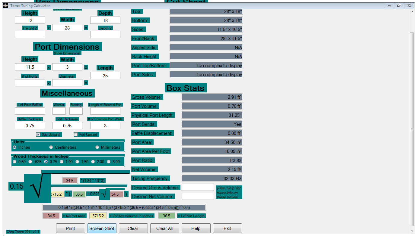

January 22, 201312 yr Author here what i came up with on torres calc. can you guys check and advice thanks.

January 22, 201312 yr Designing a box smaller to handle more power can be tricky, you are much better off designing the box around what's best for the sub and then turning down the gain on the amp. Listen for funny noises and be alert to any burning smells when you're putting that much power to those subs.
January 22, 201312 yr Author Designing a box smaller to handle more power can be tricky, you are much better off designing the box around what's best for the sub and then turning down the gain on the amp. Listen for funny noises and be alert to any burning smells when you're putting that much power to those subs.ok thanks what you think for the calculations are they accurate and good? i would like to start the build today so the input would be really appreciated thanks
