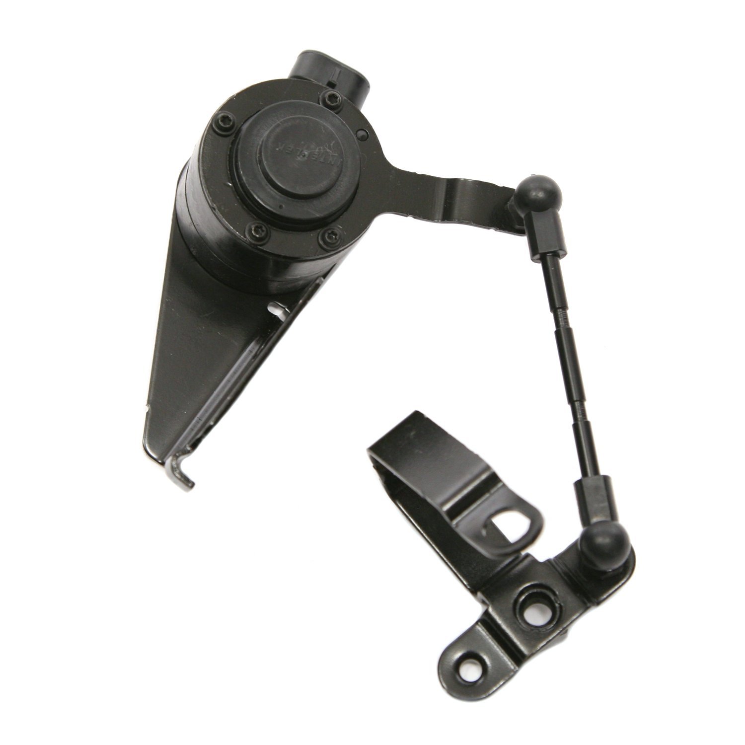

Want to lower the rear another .5" or so...but my suspension links are JB Welded since they wouldn't thread on. Looks like a rather standard link end, but I can't find them. Any thoughts on where I could?
Little plastic pieces on the end of the rod
http://www.rockauto.com/catalog/moreinfo.php?pk=3903627&cc=2002721
http://www.amazon.com/Delphi-ER10016-Vehicle-Turn-Sensor/dp/B0089RSXR8/ref=sr_1_1?ie=UTF8&qid=1404916243&sr=8-1&keywords=DELPHI+ER10016
