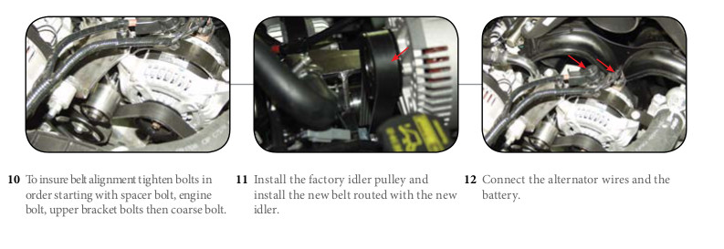

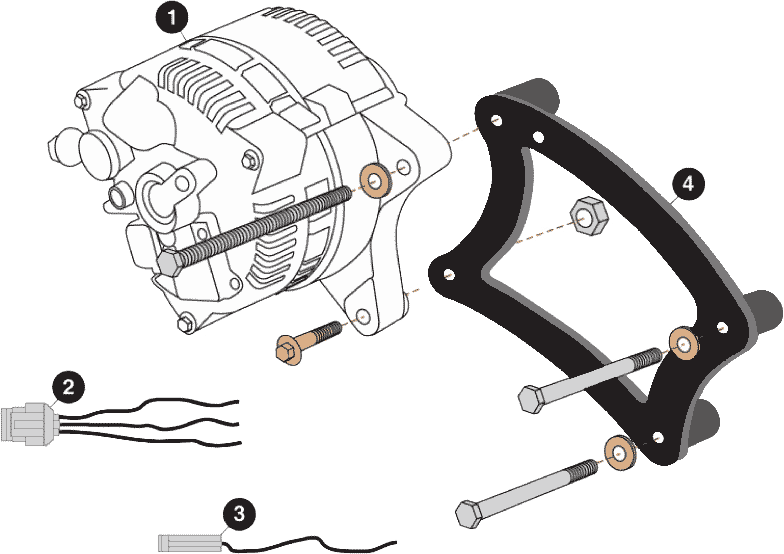

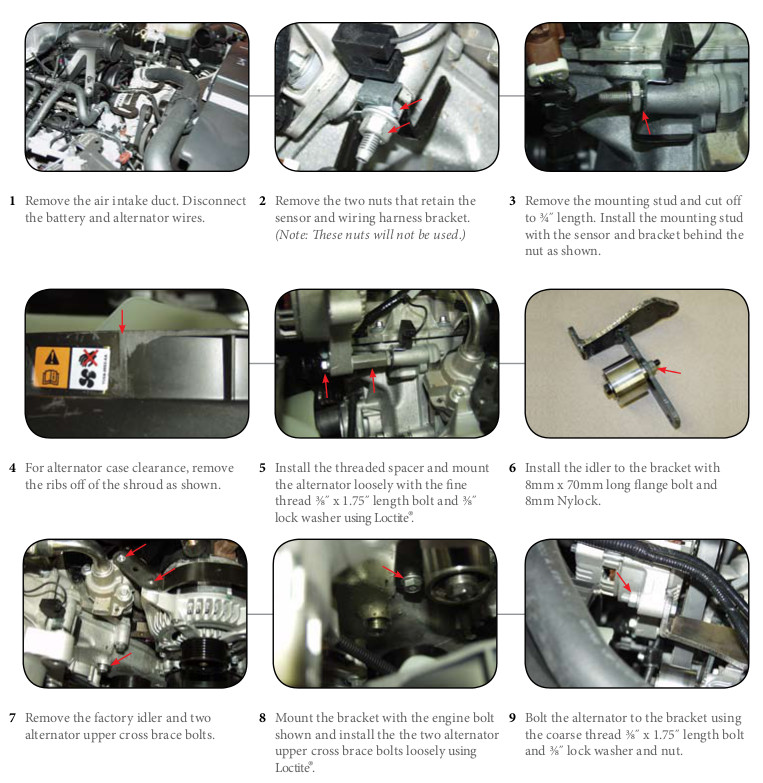

Posted March 1, 201313 yr For the Crown Vic.Town Car 4.6 Now the Exp.Navi 5.4 Im a bit confused on what they did exactly.maybe someone can explain it better. says its from an 08 navi, but alot the bolts should be the same.
March 1, 201313 yr Author Could have been my GIMP editing lol http://infiniteinnovations.thomasnet-navigator.com/category/all-categories-limousine-parts-dual-alternator
March 1, 201313 yr i have looked at that kit before, i would like to see a pic of it installed. it looks like its inverted, not a bad price.
