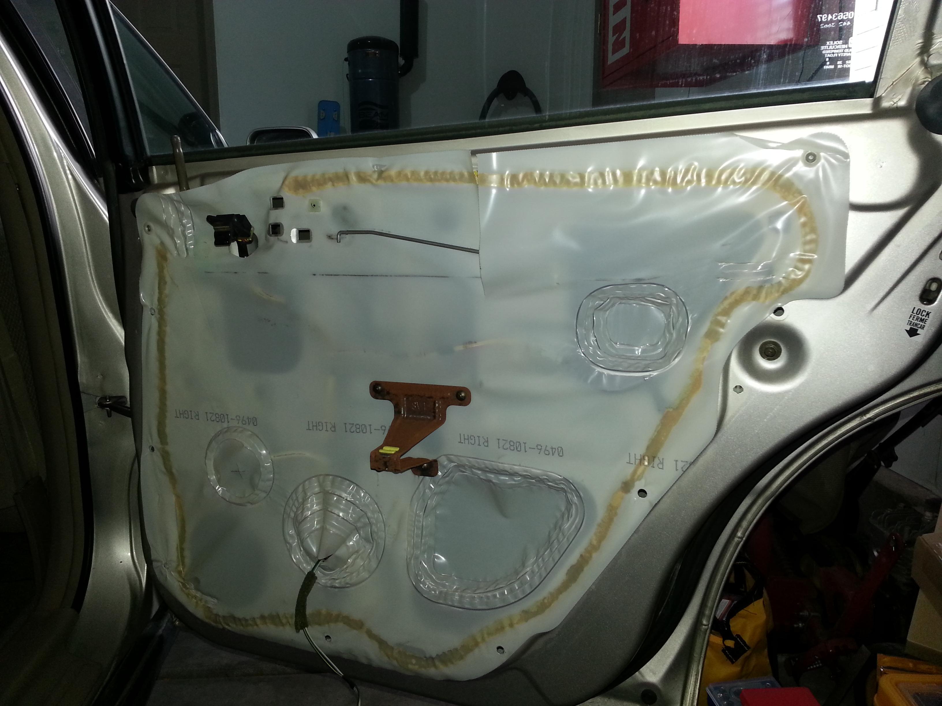

A few pics of my latest project. CLD CCF and MLV on all 4 doors. WAY more time consuming than I anticipated but I am pleased with the results. With Don's help it was really straight forward and not too complicated just super time consuming to get the fit just right with as much coverage as possible. Worth every hour.

Stripped
Cutout
Finished Product
Front Drivers Side Door
The pic of the CLD was too big but im sure everyone is familliar with that anyway. I love the idea of hanging the barrier with velcro so you can get to the internals easily if need be. The strips Don offers are strong as hell and stick very well.
There is CCF behind the MLV but I am horrible at taking pics when I get into a project, sorry. Especially with how time consuming this one was for me

I am pleased with the results. I am in a 96 Honda so Power strokes and other trucks are right at door/ window level. I couldn't stand it any more so I thought why not, I have spent over a grand on wire amps speakers and box building materials, time to deaden. I have noticed a difference in road noise especially coming from traffic. I have also noticed a huge improvement in woofer response in my doors which I am extremely happy about.
The only problem/ let down is that I now notice noise entering the vehicle from other sources ie floor firewall. I never noticed how loud that noise was because my doors were so bad. Now it is kind of forcing me to finish the entire car. should only be another $150 or so, I need to get with Don to help me work out a materials list, but I will get it done eventually. Overall it was a great decision and has definitely improved sq.
