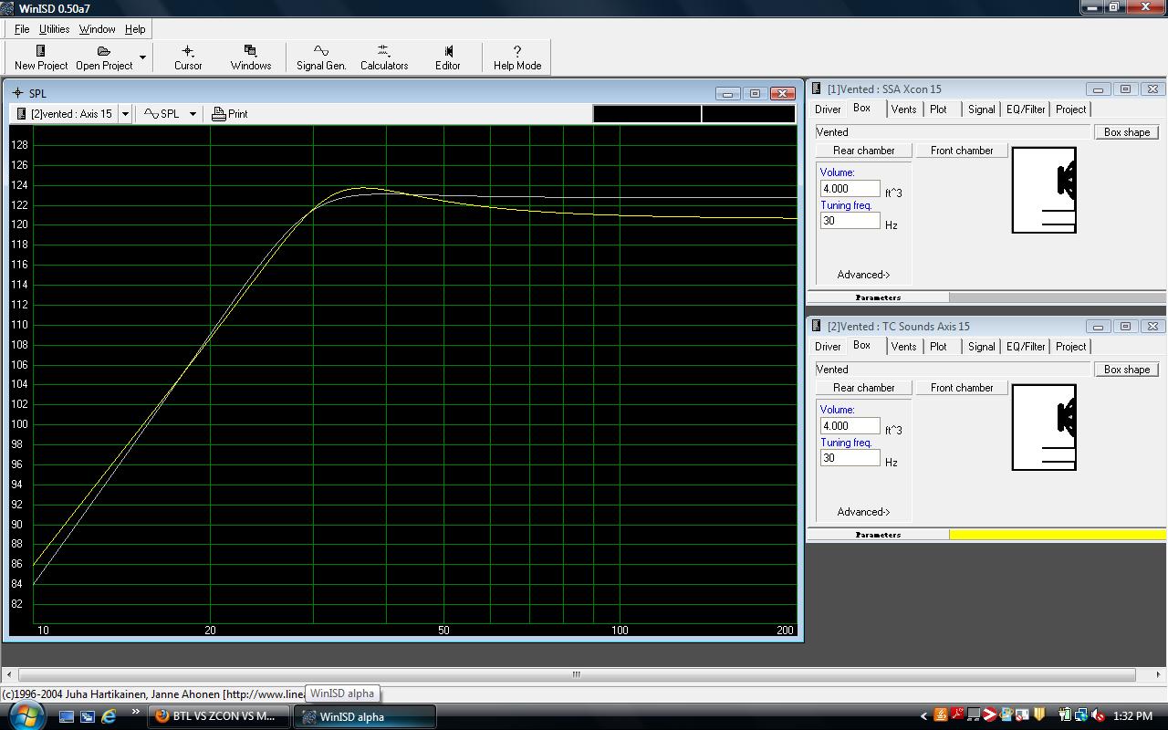

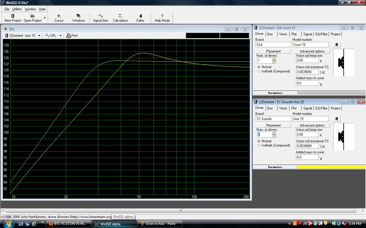

  • Myth Busted   Same enclosure, same power.  Axis clearly doesn't dig lower.  Axis shows less than 1db more peak which isn't going to be audible.     Oh, and since "you don't care about the enclosure,

Myth Busted
Oh, and since "you don't care about the enclosure, the Axis will dig deeper, the enclosure dictates everything is a myth"......couldn't be more wrong.  Obviously not the same enclosure, but THAT'S THE POINT, THE ENCLOSURE AFFECTS THE PERFORMANCE.

OMG!!!!!!!!!!!!!!!!!!!!!!!!!!!!!!!!!!!!!!!! It's WinSD It knows everyyyyythingggggggg!!!!!!!!!!!!!!!!!!!!!!!!!!!!!!!!!!!!!
Based on WinSD My stock UFO's should have been .5db (at peak)more quite than the custom TC5200's I used. The UFO's were 2.1db louder @ peak freq of 44hz. 1db louder @35hz and .5db more quite @31hz. While the UFO's were louder overall, they lacked the low end extension offered by the 5200's. The frequency transition of the 5200s was much better overall but had a steep roll off around 45-47hz Even tuned low, the UFO's were still very peaky in my opinion. Plain and simple, enclosure does not dictate everything. Just because a given sub is louder at a lower frequency, doesn't mean it sounds better or plays lower. I kept my previous post simple but you guys obviously completely missed the point...
WinSD is great and has its place but is far from 80% accurate in real world. Obviously each situation changes and dictates how a driver will preform.

Myth Busted
