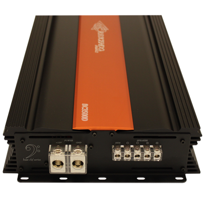

Posted March 19, 201313 yr ok so im looking to get one of these but im really confused about them. it says they are a mono block amp but yet they have ++ and -- speaker outputs? i want to run two dual 2ohm fi bl 15s off of it and im wondering how to get a two ohm load. wiring them in paralell is a 2 ohm load but some people are saying that its a mono block and it doesnt have ++ and -- speaker outputs and that the picture on the site is just a different one but i didnt think so and i understand how to wire them if it only has single + and - outputs. just very confused on how an amp can be a mono block but have dual outputs? im no wiring wizard.. Edited March 19, 201313 yr by mason_herold
March 19, 201313 yr Why did you make another thread? I'm pretty sure the only reason it has dual + and - is to make it easier for an installer to put wires in. It just makes it easier and I also used them when I strapped two BC2ks.

March 19, 201313 yr Author yeah i know that! i was just confused about there being double outputs and it being a mono amp. so basically youre saying all four outputs are for just one channel? would i just bridge it then?
March 19, 201313 yr No bridging. Bridging is something combining 2 or more channels to one. Just use the outter most ones and don't worry about the middle ones.

March 19, 201313 yr The amp is a single channel. I has a few extra places to stick wires, but there aren't any extra channels. you can't bridged, strap or do anything else with a single amplifier. They put what looks like extra channels there to make it easier for you to get a bunch of wires hooked up without cramming them into a single set of holes. Do not buy CCA ever. It is a marketing gimmick. It is lower performing (greatly) to the same awg copper. Additionally, aluminum in any form is inferior to copper in all aspects electrical. The amount of copper plating on the individual strands is there for color appearance more than anything... Buy welding cable, it is better quality to price ratio than any car audio branded cable. You don't need to fuse the - side, one fuse blows in the circuit, the whole circuit stops current flow.
