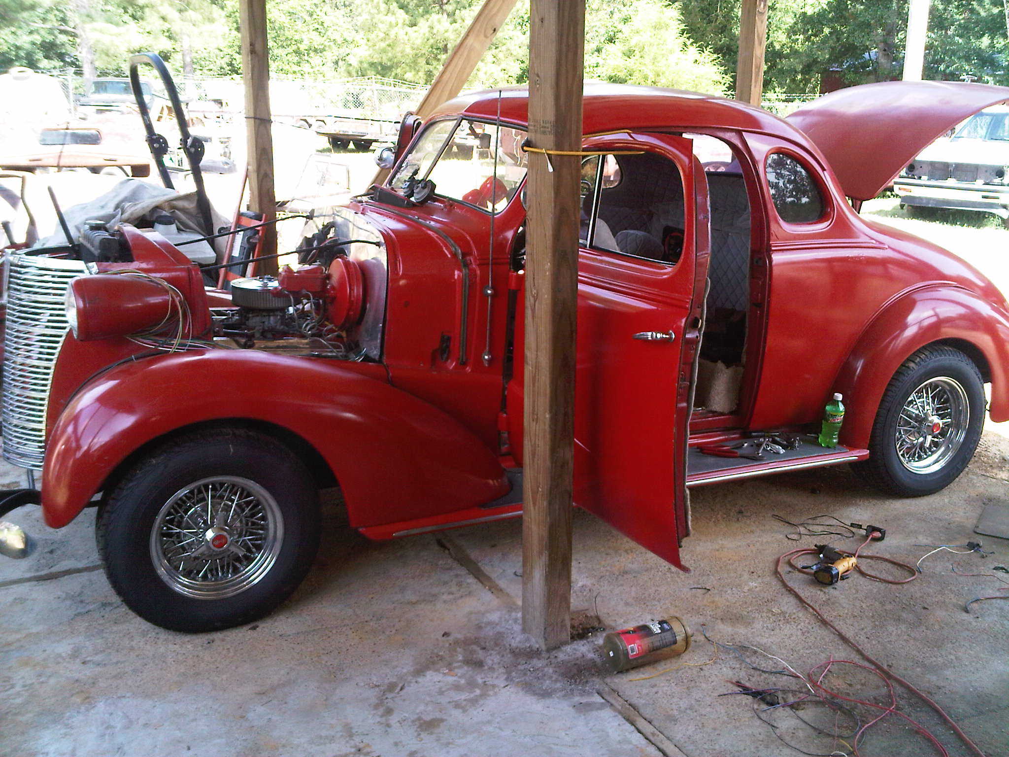

Over the last few days I've been working to help out a friend with his car's electrical system. We had to completly rewire his electrical.
So we ordered a wiring harness kit for this. Easy to install, Bout the only hard part was gutting out the old rats nest of a wiring harness ...
Since I'm doing this to my car, I volunteered to do his electrical setup in return he pays for my wiring harness kit ... Awesome Deal for both of us !!!
I should be done with this by this weekend ...
Just for an added thank you for his business ... I am wiring up and installing his stereo too (nice Pioneer unit with 4 speakers in fairly hidden locations) ... I will post pics when I'm done if anyone's interested.

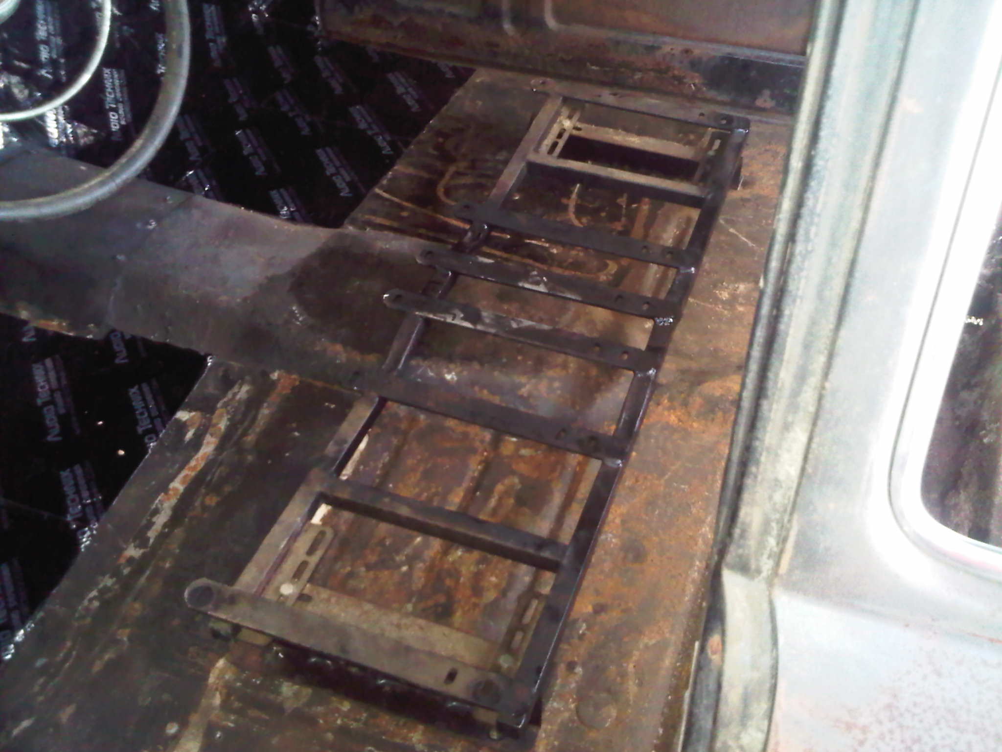

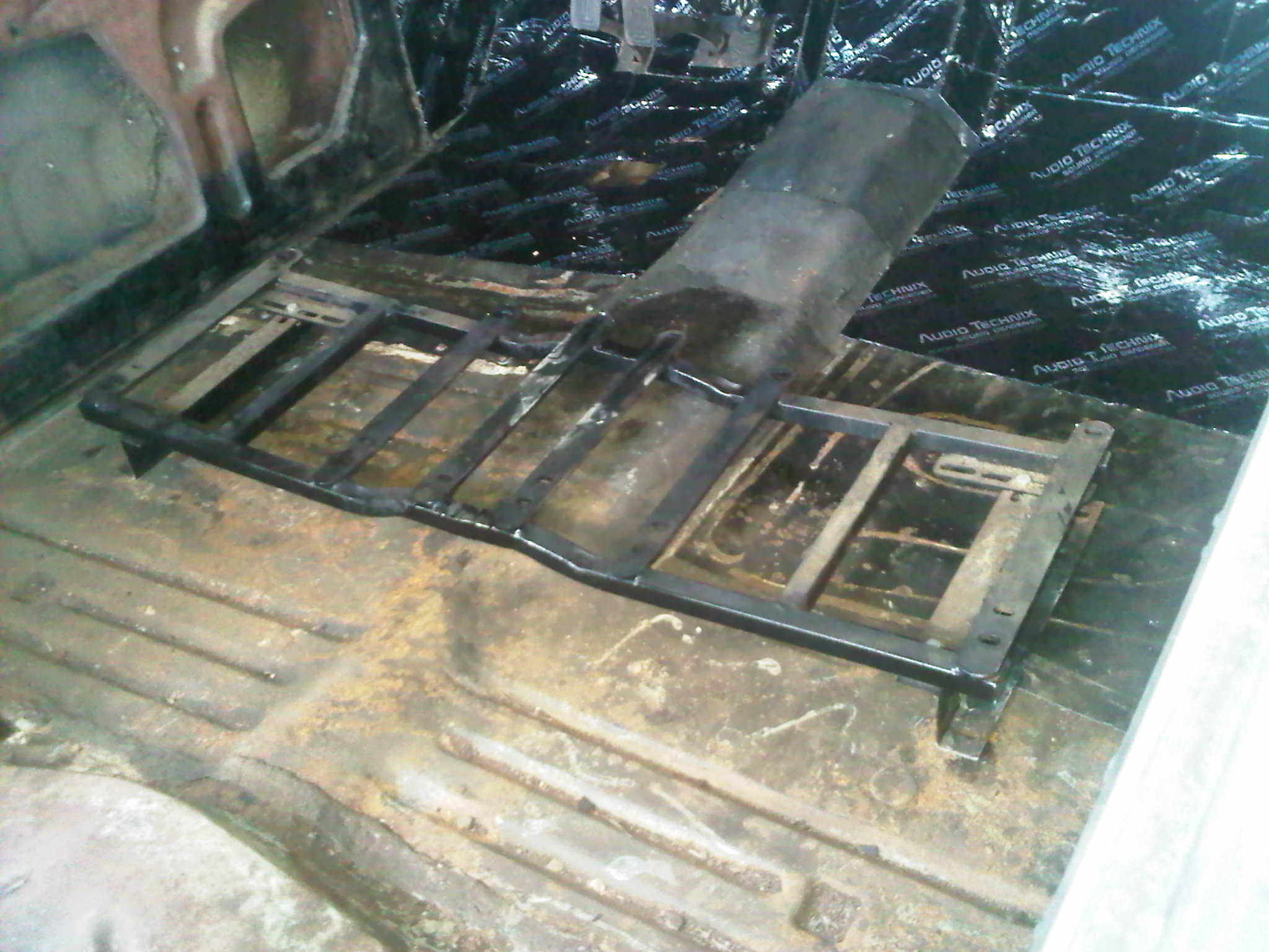

The other day I got my hands on a set of bucket seats out of a 96 Chevy Silverado. They need to be recovered, but will work fine for now during the build to manuver the car around to the different shops and stuff ... The only problem was that the seats were too wide for the car. It has a big center console thingy so we too that off to cut off of a section of the seat brackets to make the seats fit properly ...

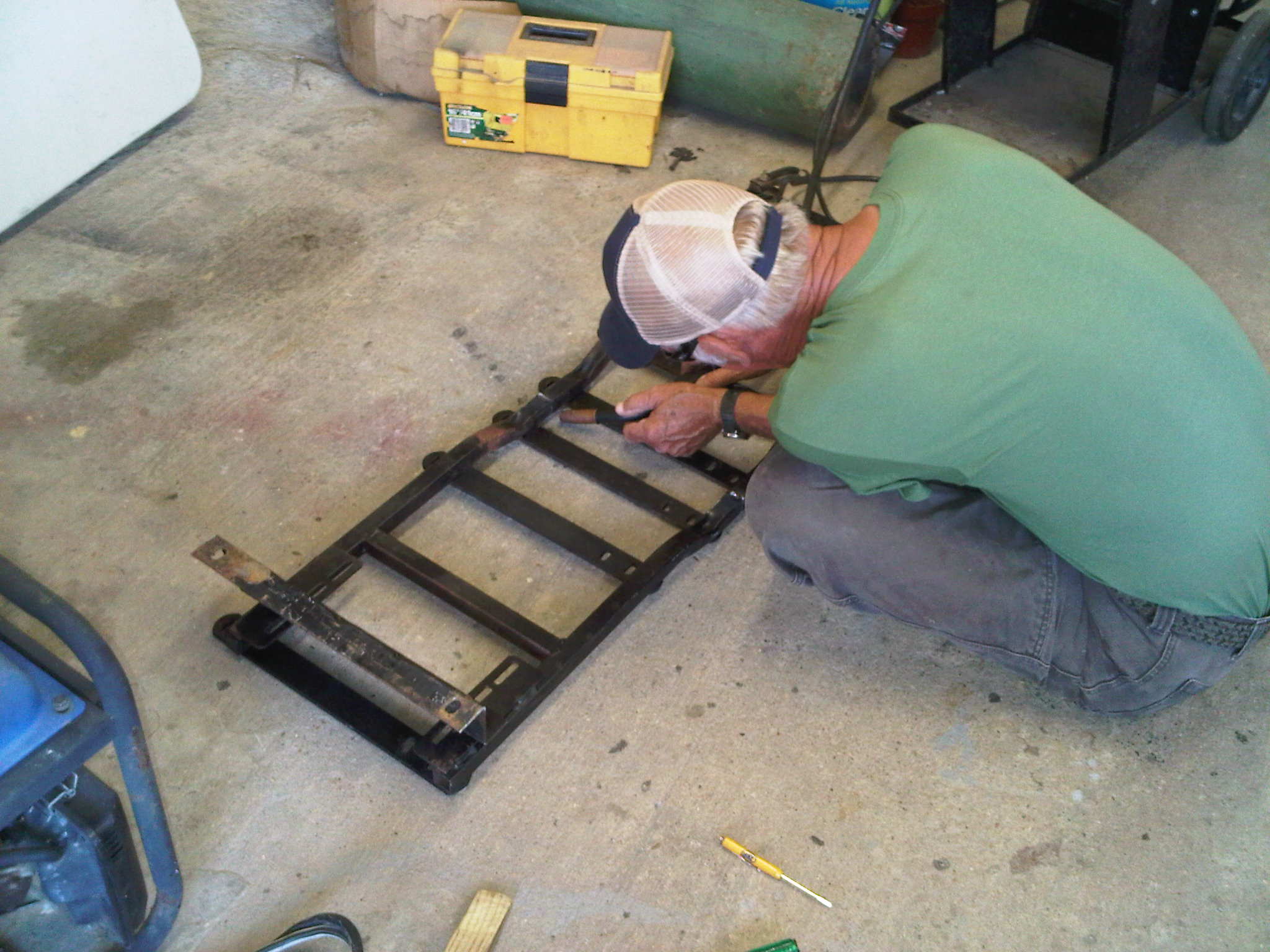

Today I got one of my partners of crime in the Mississippi Street Rod Association Hulon Slay to cut, fit, and reweld my seat brackets ... Couldn't ask for a better setup than what I got. So far, everything is lining up perfectly !!! Thank you Hulon !!! Hopefully I will have the seats reinstalled back to the brackets and installed into the car this weeked ...

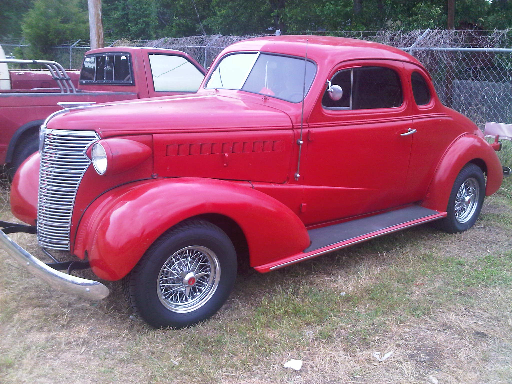

I'm running a new wiring harness kit in his 38 Chevy Coupe,

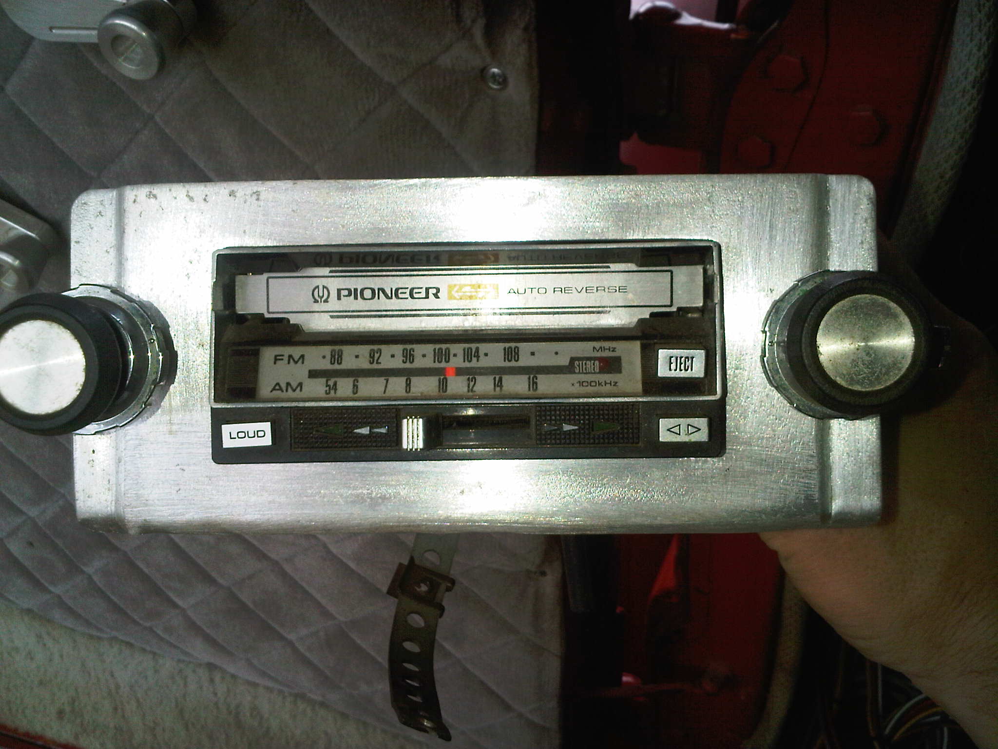

Check this out guys !!! A piece of old school Pioneer history ... pulled it out of the 38 Chevy !!!
True old school, nice!
Thanks man !!! Yea, I wanted to bring it home, but the owner said that he was going to put it in his throphy case in his pawn shop ... Oh well
