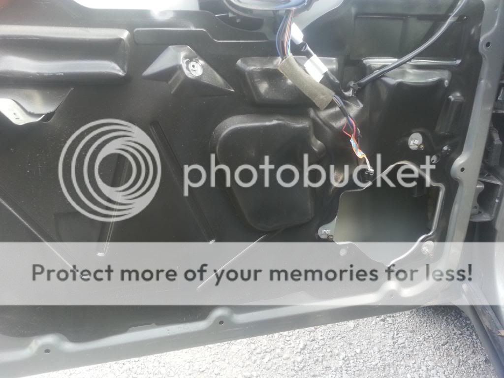

Here are the door panels.  Lot more than I'm used to working with but still a little limited on depth due to the giant window.  Most things will work but some large 7"+ isn't going to happen without modifications to the door panel which I could not do.
This is the stock pod removed.  Not that exciting.

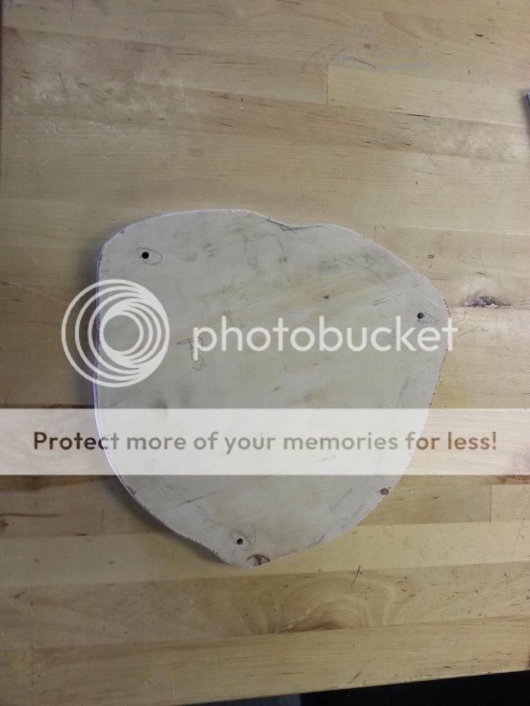

Was not going to modify and use some crappy plastic pods.  Made my own out of 3/4 birch.

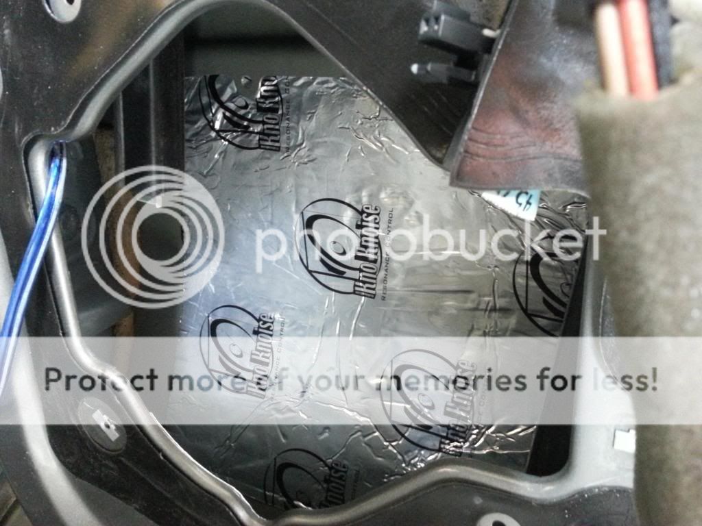

Kno Knoise Kinstalled.  It's decent.
