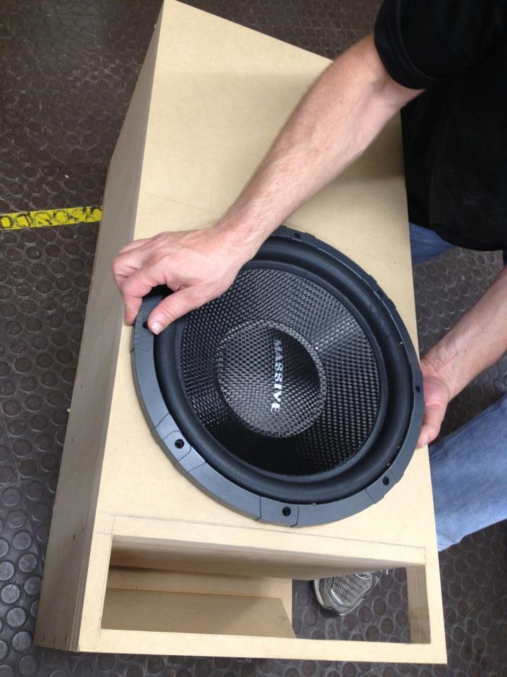

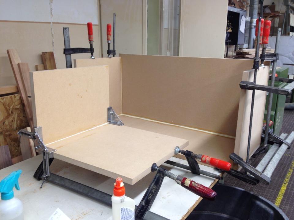

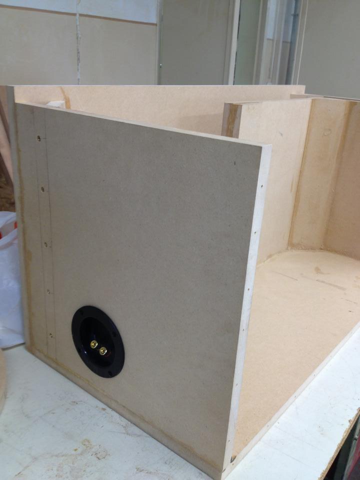

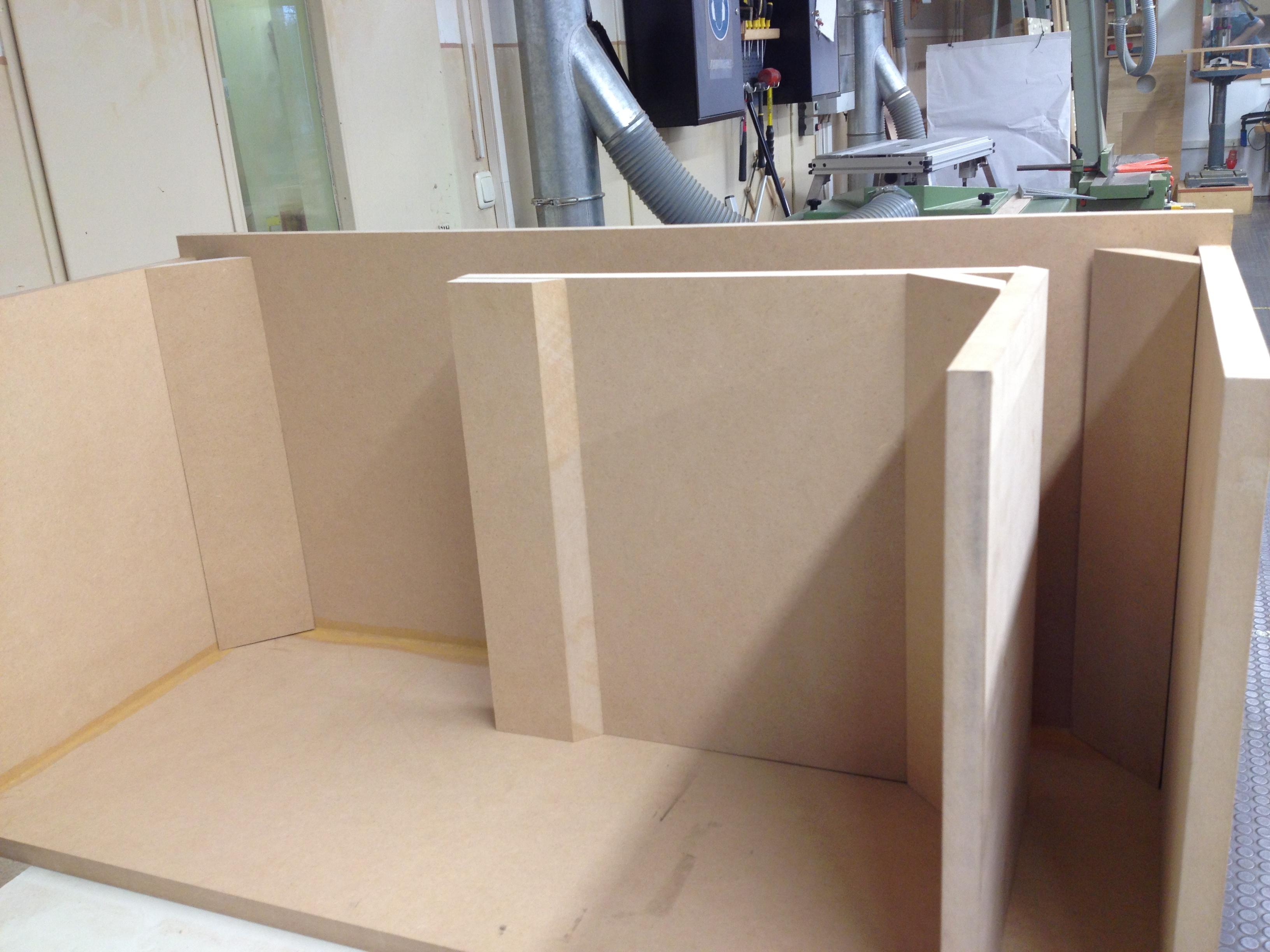

Thought I would post up some pictures of my build. Im pretty excited because its my first build and my first stereo system. Its going in a 00 toyota camry. its nothing fancy car wise. but I figure if I have access to a wood shop and such why not build it? heres whats going in it Alpine 9885 headunit pheonix gold octane R's 5.25 components with tweeters Hifonics TXi6406 Sundown audio SAZ-1000D 15 inch massive audio DMX stg2 CF subwoofer box is ported at 3 cubic feet tuned at 34Hz audio control epicenter I know the amp for the sub is kinda on the small side but it should do for now until i get a better sub and amp later on down the road when i get back to the states. right now im stuck on the wiring part. I have the wiring for the speakers and such but still need 4ga wire for the power wires still. Im also stuck on where to place my amps. my sundown amp is small enough to fit on the back of the seat but my hifi amp isnt. I might make a amp rack for it.

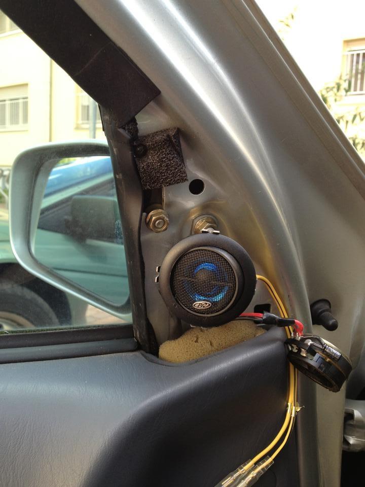

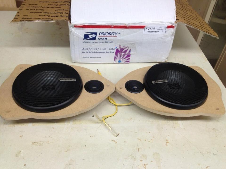

I am going to utilize the factory tweeter location too for my components I went to the junk yard and got the mounts & sail panel grilles

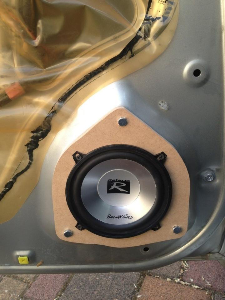

Really pics are too small? I will see about resizing them for you guys. Any recommendations on sizing? Also i was wanting to use the "sail panels" for the new speakers but i think the plastic doesnt come off the stock speakers so i went ahead and made it out of MDF. Turned out nice for something im doing for the first time. I used a scroll saw for the templates and then sanded them down to smooth them out. Then i used a drill press for the cutouts and then sanded the inside down as well.

That box looks good, my man!

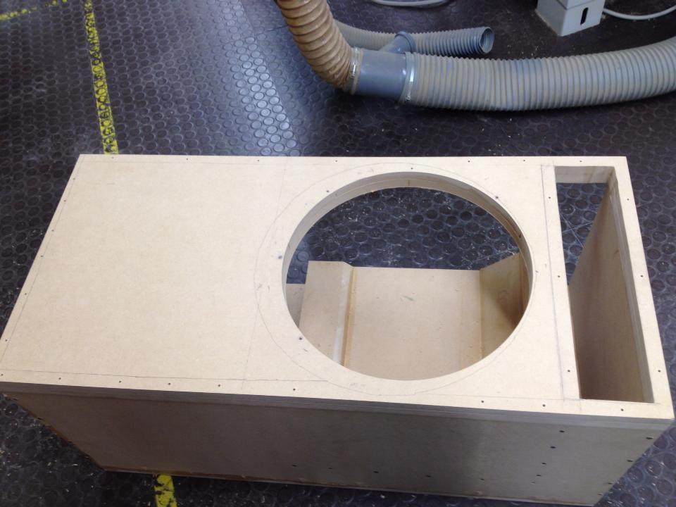

Thanks man! Some imperfections for my first time box building but i think it turned out great. I tried grabbing carpet today. I called them and the language barrier sucks. Im gonna try and go tomorrow to pick it up. Hopefully being in person will resolve what i need length and width wise for the box. I am itching to have this thing hooked up already

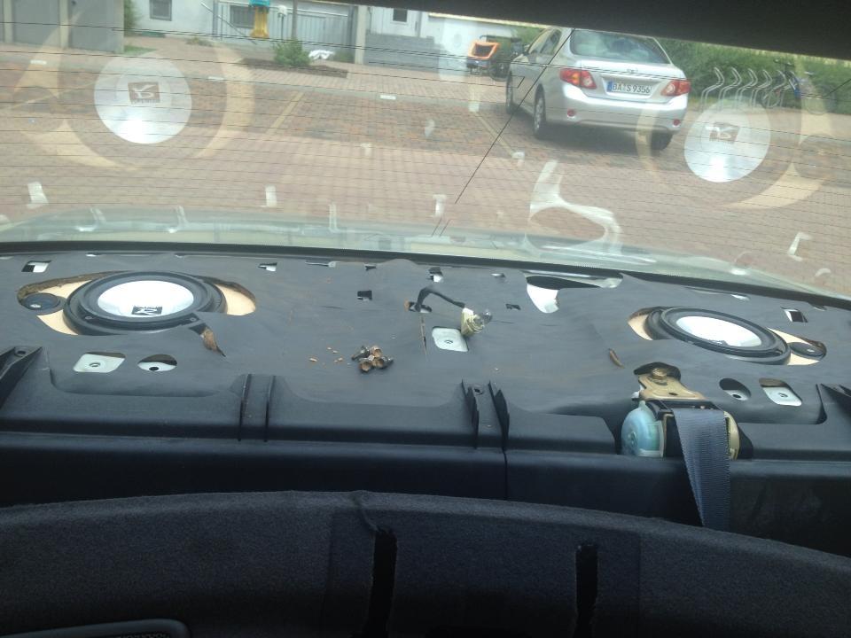

All 4 speakers front and back are 5.25 i believe. The rear speakers i added a tweeter to. the front i put everything in the stock location. You can fit a 6 inch and a tweeter in there if you want for the rear. Ive had these speakers for 2 years and just now am using them lol. I like the sound quality. I can show you a better picture of the rear speakers if need be

Forgot to ask how did you remove those speacker covers for the rear
