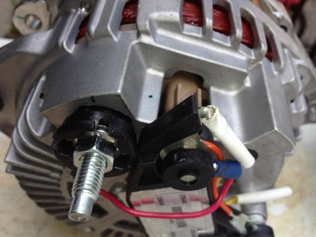

This Picture is of my original alt and you can see the two connection points(Referencing question #1)

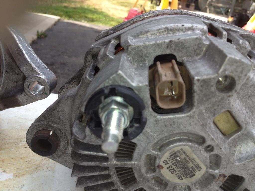

This is the new Alt and you can see how I am unable to connect the two locations.

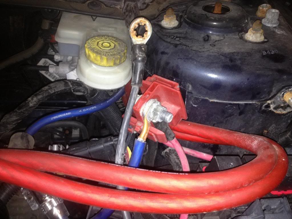

This is where one of the wires off the positive battery terminal goes too and then is goes on to this device in the picture following this one.
