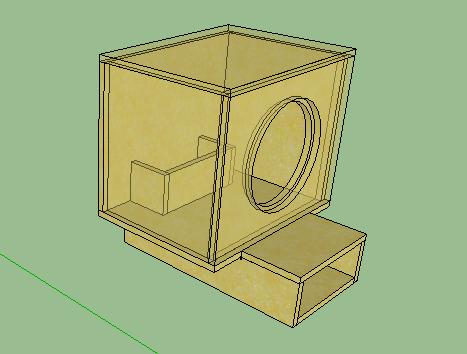

I am thinking along these lines...haven't done the math- just a general sketch.
post-40683-0-31596700-1379640556_thumb.j
I was in a hurry when I made the last post...to be clear, that is to the dimensions 22wx19hx17d with the port being 13wx5.25h(for a net of 11.5x4.5, 52ci of port, ~17ci per ft^3)  The math I didn't work out was the port length needed.  Just wanted to know if the theory of the external port was solid first.

Leedog, the seat rails are not spaced evenly side to side, from the left rail to the wall is 5.25", from the right rail to the wall is 3.25
