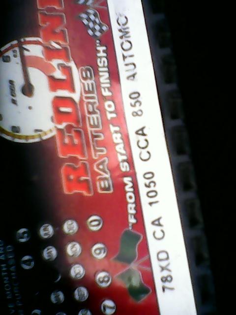

This is the bat I have now,will another be plenty for two bc2000's

You vent the battery box out of the trunk.  When batteries charge, they off-gas hydrogen gas.  This is explosive of course and under the correct conditions, can explode, so you want the box vented to the atmosphere.
main reason I was looking into agms but venting is no biggy either an save a few bucks
