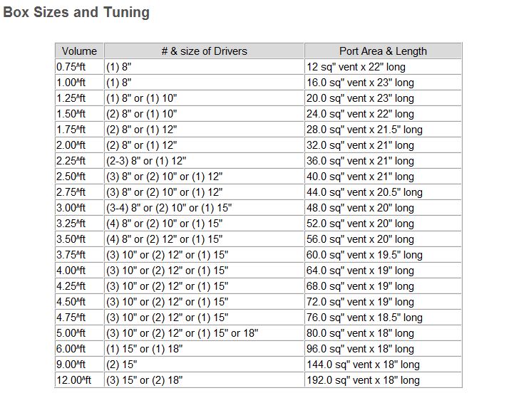

February 27, 201411 yr http://www.carstereo.com/help/Articles.cfm?id=31 < very useful link. Edited February 27, 201411 yr by Leedogg
February 28, 201411 yr Author yeah after more looking I am going to make a changeable slot port that will be 3inch wide and 12 tall. this will allow me to make any size up to 14 inches in length. according to calculators that would be tunable from about 25 to 40 hz. thanks a bunch for your help
